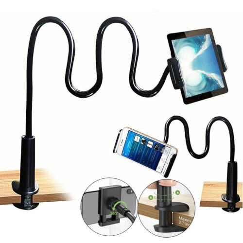

I have a few of these.
1 holds my cell for my music, another holds my dust collecting hood, and the other 2 hold clip on lights. I have several more spread around the shop tools.
