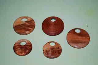

I have been doing pendants this way using scrap woods that I acquire along the way. Bowl scraps, "freebies" from the vendors and general stuff from around the shop. I start off with a piece of wood 2 X 2 X 1.5 +/-. I mark the center on each side and then use a compass to draw a circle. On one side I use a forstner bit and drill a hole about .5" deep in the center. On the other side I drill a 3/8 hole about an inch deep off center, usually about 1/4-3/8 down from the top of the circle. I mount it on a chuck with pin jaws and first turn it round. Then I do the face and round over the front edge. I then cut the back side and make the pendant the thickness I am looking for. I leave about a 1/2 inch tendon to hold the pendant to the body while sanding. I part it off with a parting tool and sand the back with a hand held drill with a sanding pad. A bath in wipe on poly and buff to a shine. I have put a few pictures together of the process so you could see what I was talking about. I really like the idea of the jigs with off center pin locations and the possibilities that go along with it. But this cost me nothing and like I said it is a great way to use up some scrap pieces. After you turn a few you will get the idea. I will usually mark up about 10 at a time one night and drill all of the holes. Next night turn and give them the bath. 3rd night buff and your done.
Comments welcome....

Yet another way. Great work. Have you thought about parting off the pendants a little closer so you can get more than one from a piece?

That is neat, although does seem like a lot of wasted wood. Seels as thought you could part of 2 or 3 from that piece.
You are right about parting them off and I have done them that way. I did this one just to show how you and get almost the whole back done except the last kittle bit even with 1.5" thick piece of wood. With 2.0" piece I always get 2-3. For me it is more of a way to get rid of cut offs.
