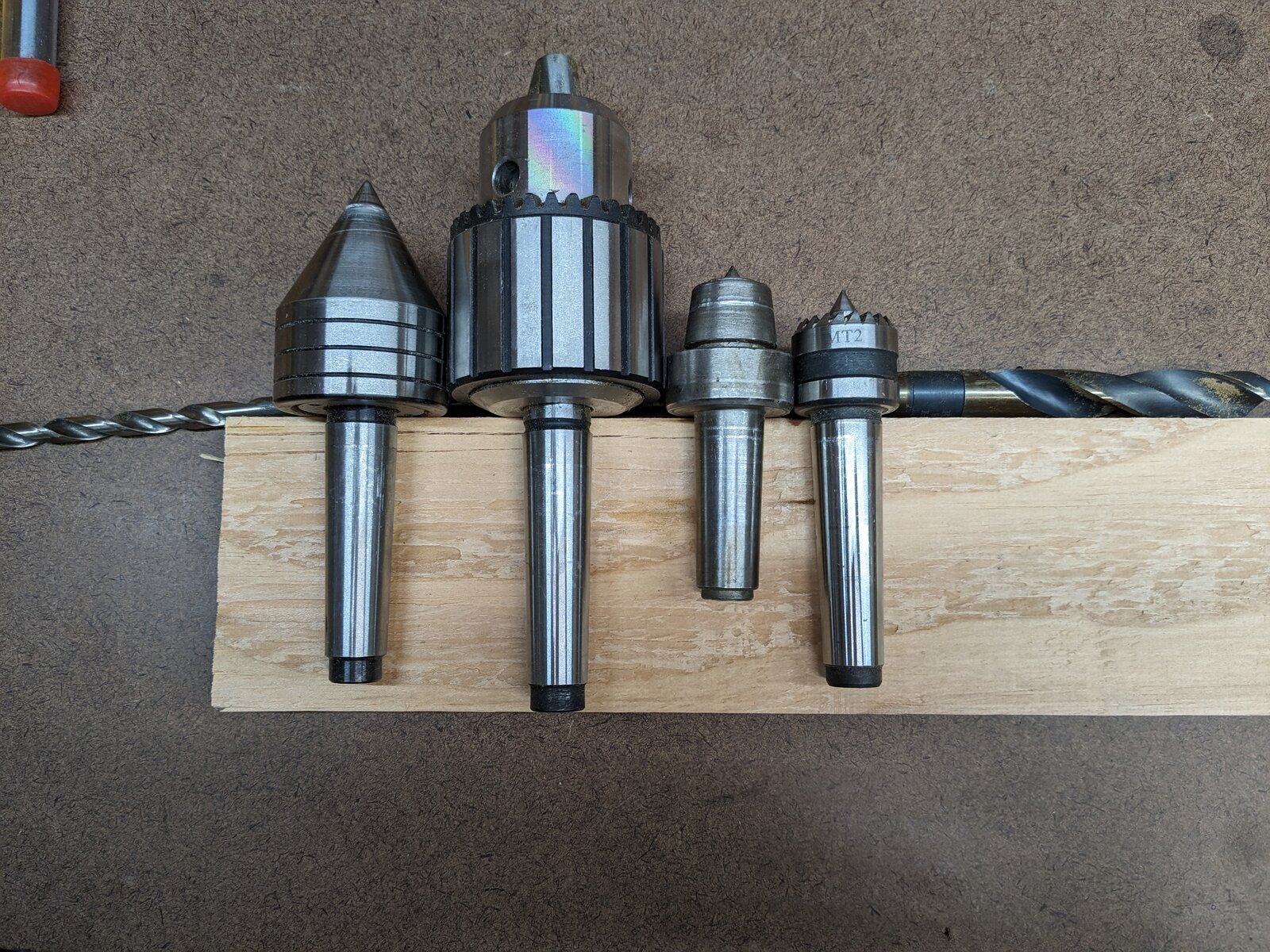

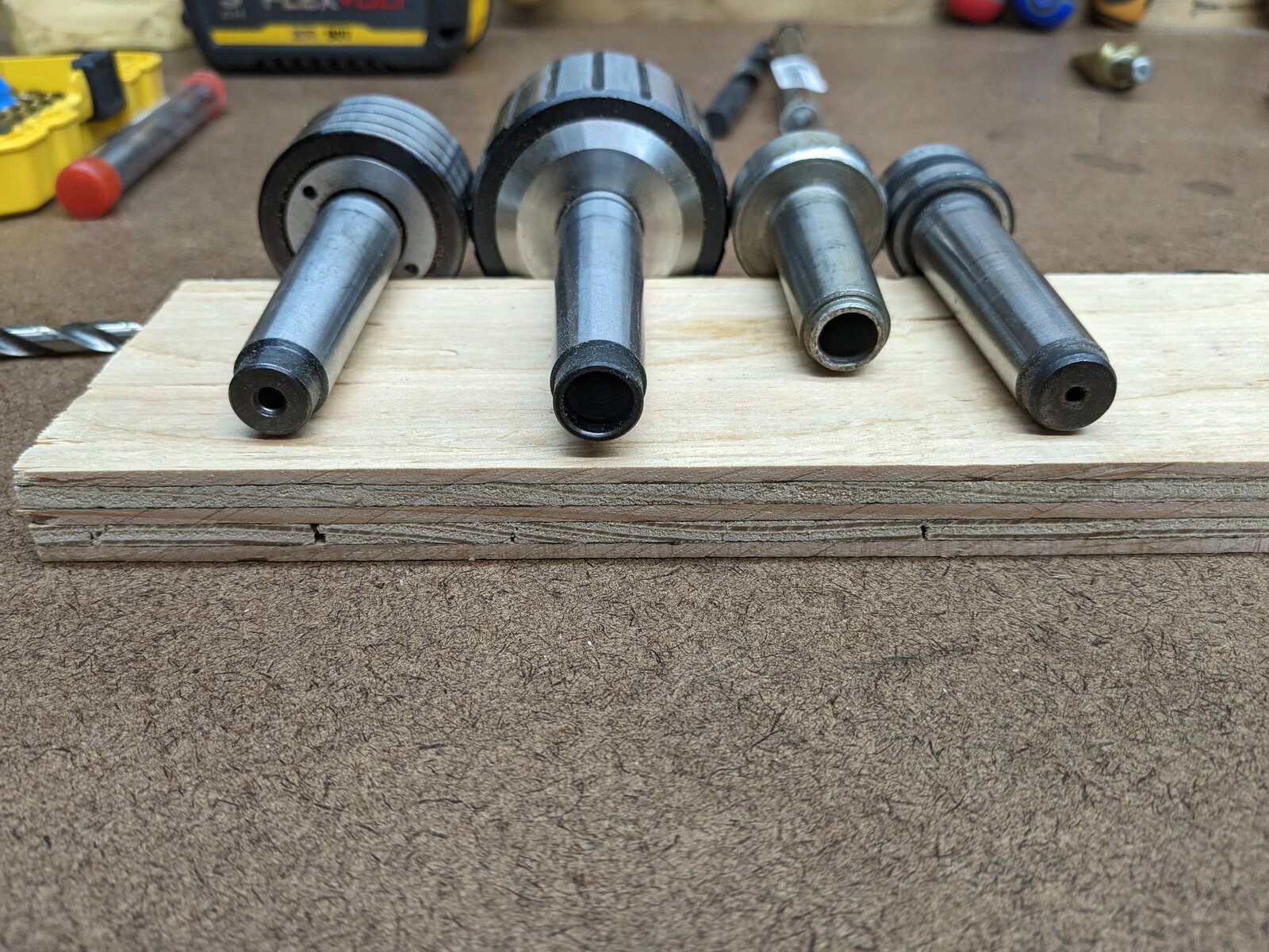

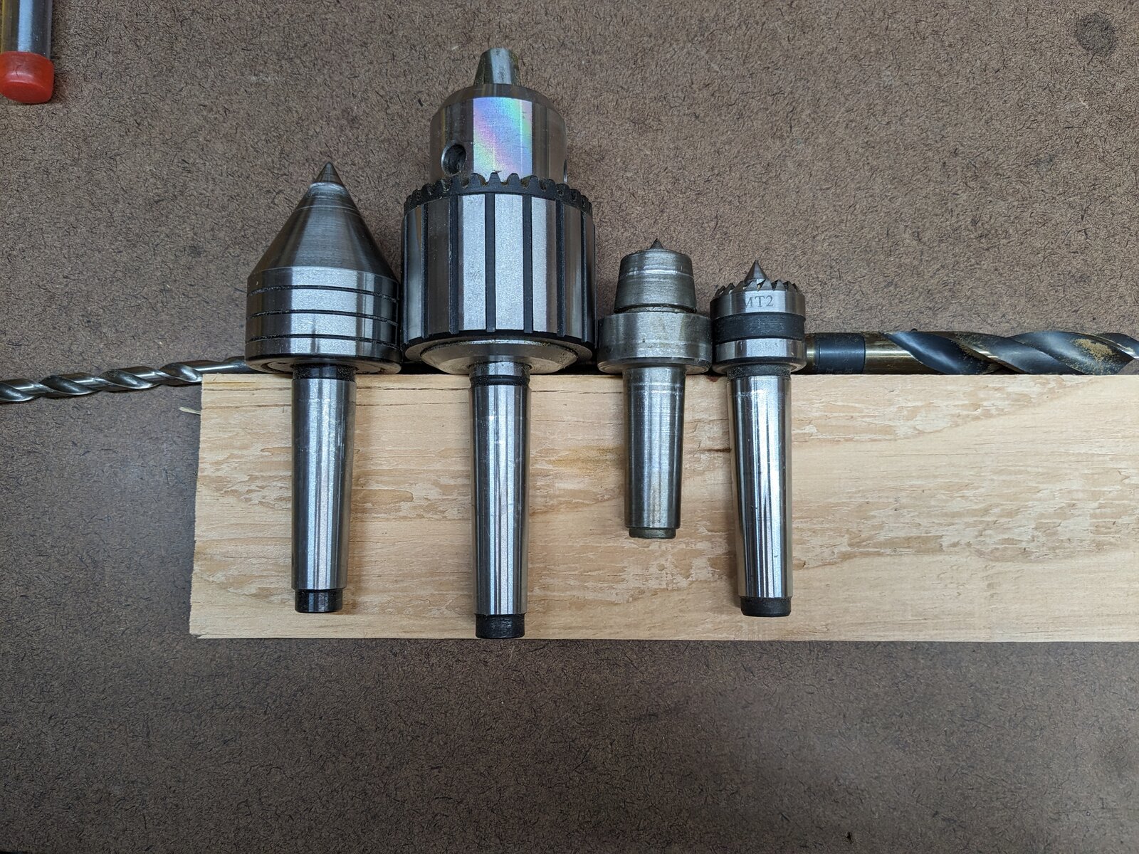

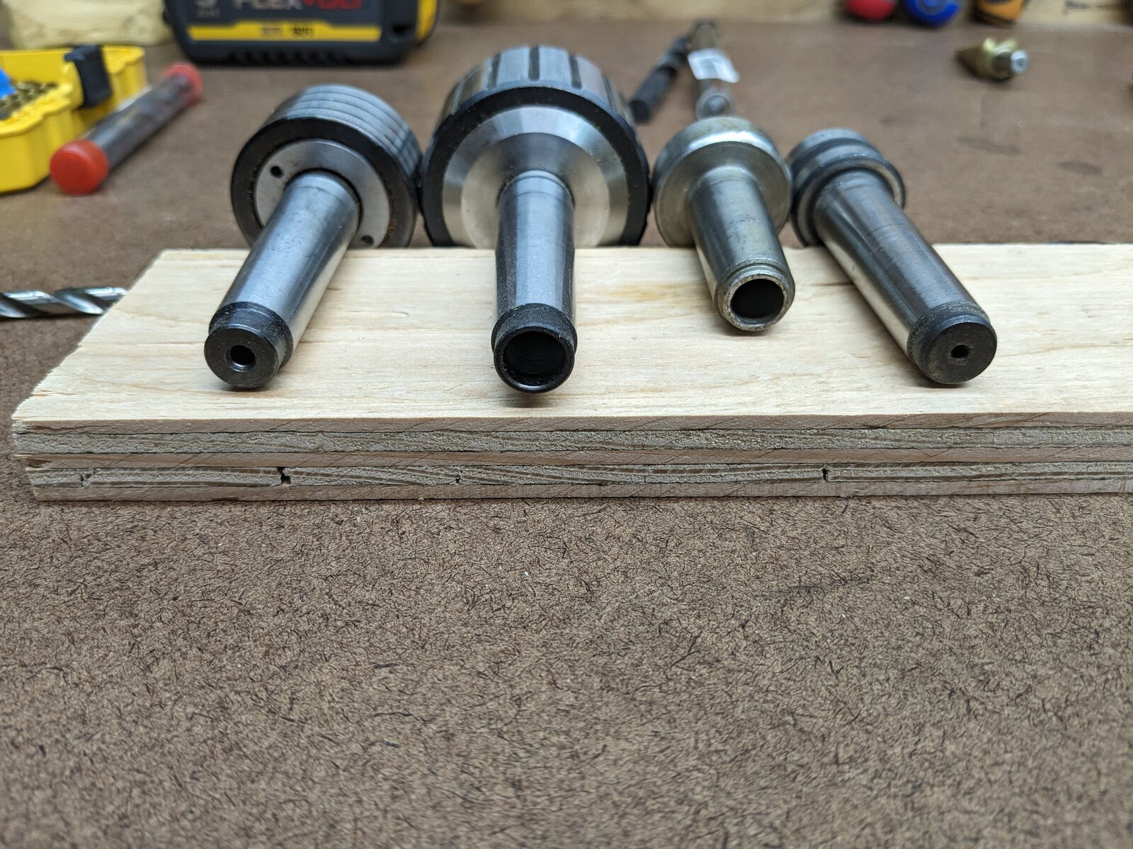

Talk about working with a short tool.
Curly
Nov 20, 2010
4,856
Saskatoon SK., Canada.
By any chance does the short tapered centre have a tip that can be knocked out? If so that is why the taper is the length it is. If longer the end would be very thin. The lathe may not have come with the taper and that's why it can't be ejected.
Muddydogs
Aug 9, 2023
101
Utah
Yep the point comes out, knocked it out a few times trying to get the center out of the quill.
