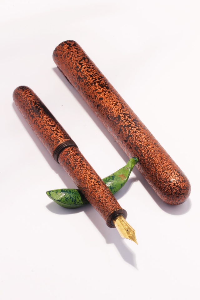

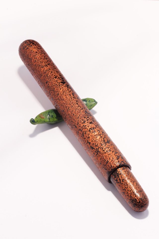

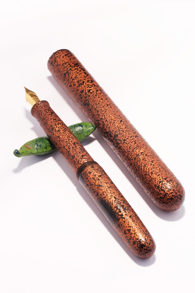

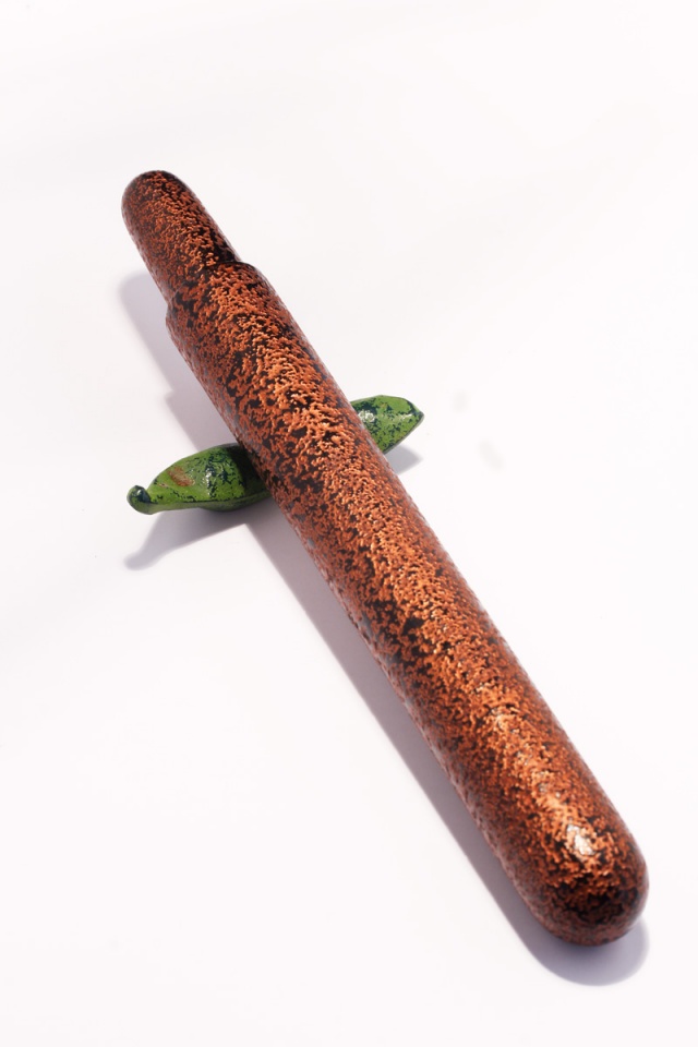

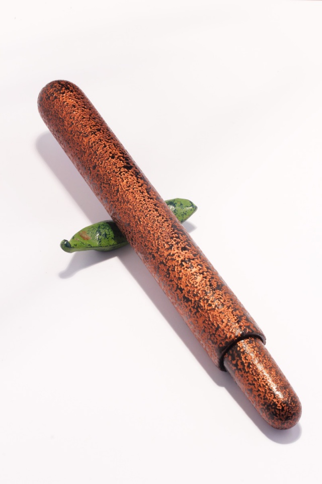

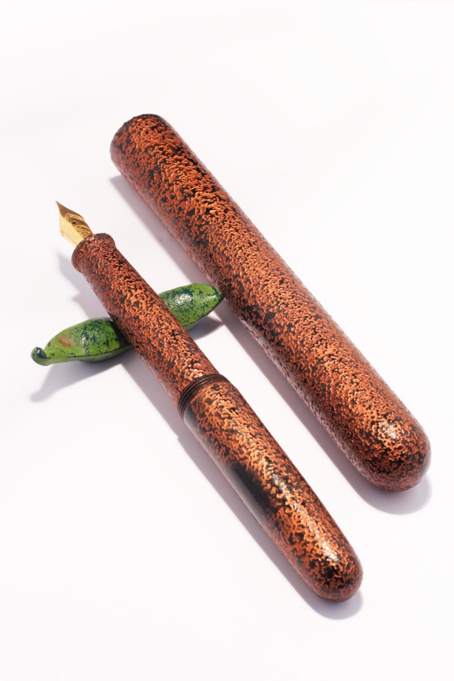

Hello,
I was asked to give you some information on urushi making process.
I found a pdf that I have made some months ago showing the manufacturion proces of an ebonite fountain pen with a special urushi finish called "chadô-nuri". The chadô-nuri is one of the "kinsoku mitateai" techniques in which the surface of metal is resembled. "Chadô" is the Japanese word for Copper, so this technique tries to show a worn copper surface.
The design of the pen on the photos I call "kiseru". The name kiseru derives from the Japanese tobacco pipe.
  • Chadô Nuri Fountain Pen.pdf
