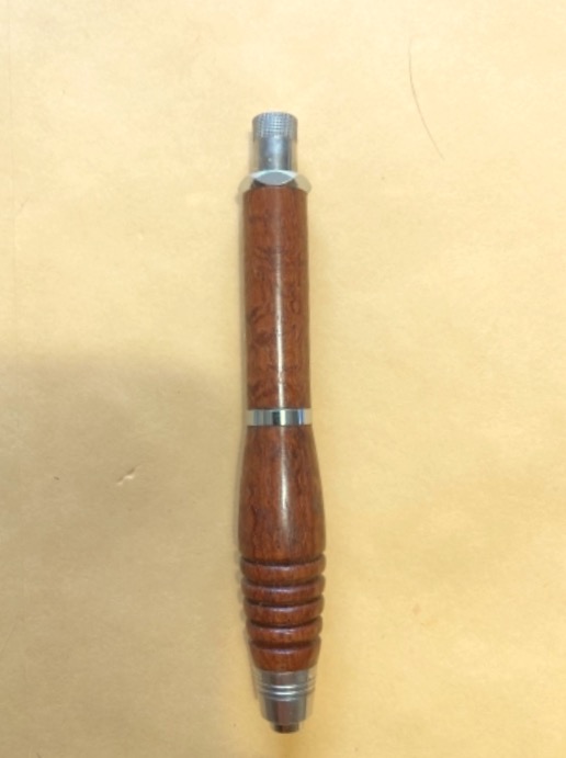

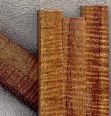

Curly Koa if you can find it would be a great choice. I agree with using lacquer for the finish. It's available in high gloss or matte. I use a blue paper shop towel to apply it on the lathe while it's turning. Dries pretty quickly. I'd use several coats allowing it to dry thoroughly between coats. Use the high gloss lacquer and you can use Micromesh with very light pressure (wet sanding to 12,000 grit) to get a higher gloss. I'd finish it off with a coat of Renaissance Wax. It will have a mirror like finish. Koa is getting harder to find. It's widely used for making musical instruments. This is a poor photograph of a sketch pencil I made with it. I used a lower gloss lacquer on it but it should give you an idea of how it looks. Spraying would work as good or better but I use wipe on as I am "spraying challenged" and I often have runs when I've tried the technique. I think I've seen it sold by Exotic Blanks, but I can't remember where I found it. It's available at :
But I think you can do better on the price. Shop around. Here's a good photo of the blank.

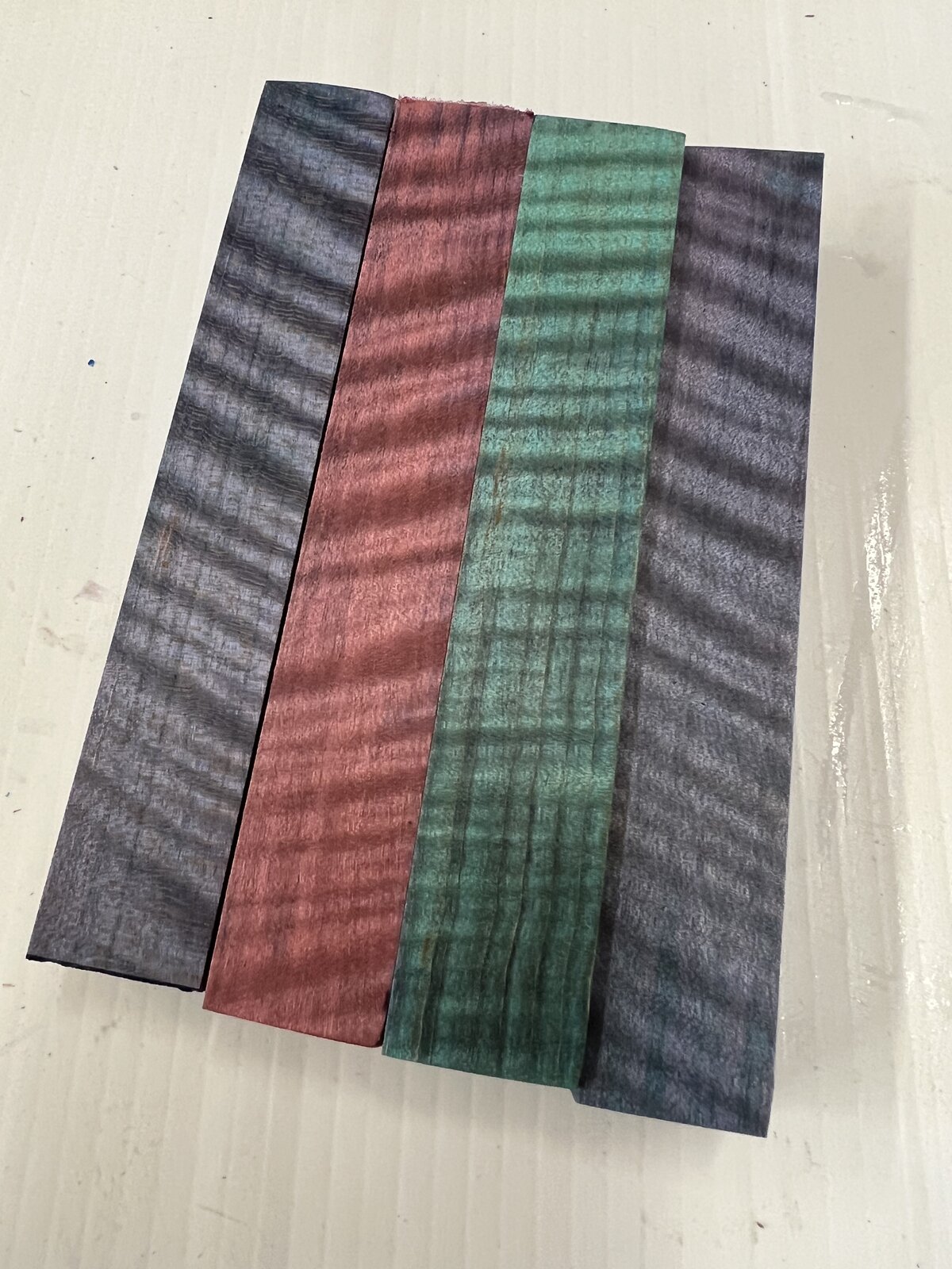

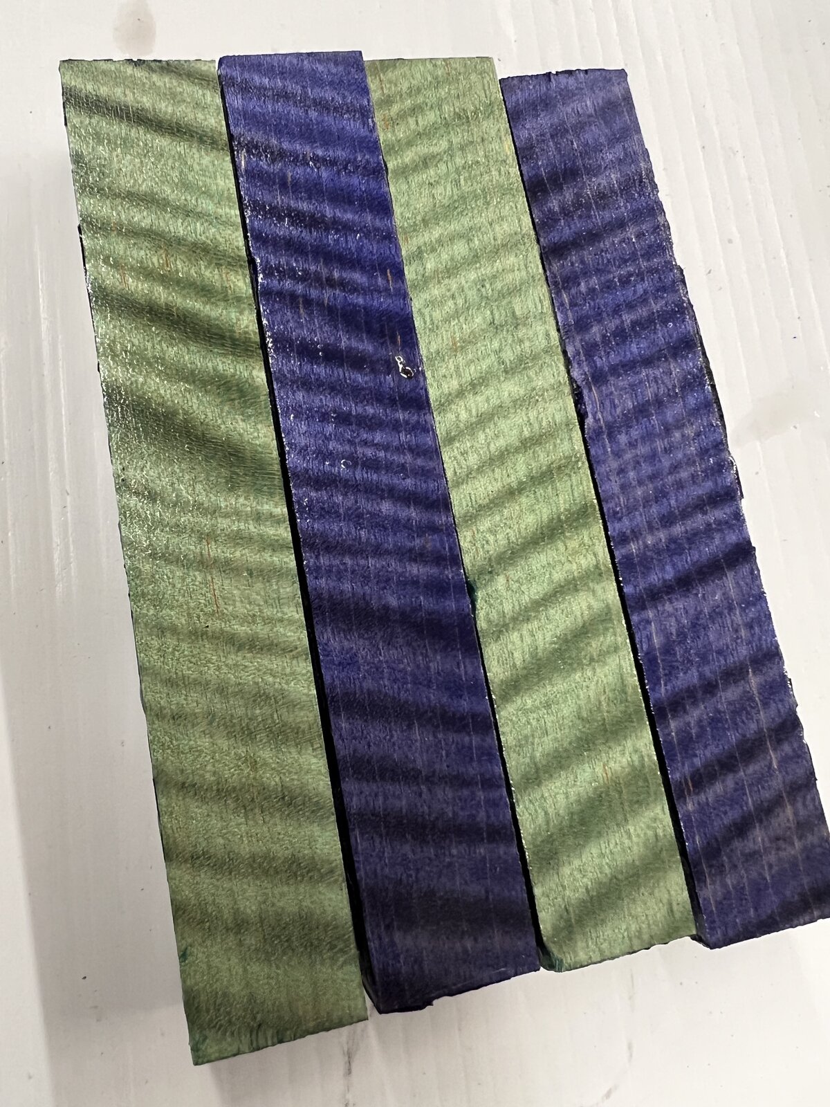

Thanks MRDucks2 - and I agree with the curly woods- Cury Maple, Curly Koa, and even Curly Walnut (or Heavily figured Claro Walnut)
As for the coloring- I stabilize ALOT of curly maple, but not usually in the brown tones.
Since this is a hobby- I love a good challenge. Send my some pics of the colors you are after and Ill look into it. Ill attach some of my curly maple colors
