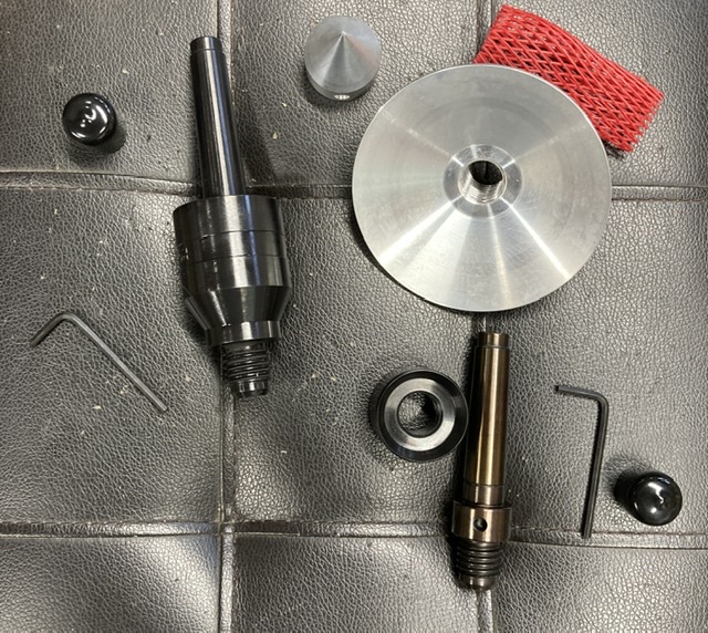

Here is the Robust Live Center, cone, cup, dead center and ring center adapter that fits both the dead and live center. Total investment $235 from https://www.thewoodturningstore.com/woodturning-tools/

The Nova Live Center System comes with lots of adapters and points and is the only 3 bearing system in the bunch. It has two thrust and one load bearing. It is typically the most economical with a little trade off on machine work and finish. The entire outer body spins with the center and people who buy it like it. Most also never use many of the extra parts and pieces. The add ins use a 2MT fit into the live center. The points are removable but not adjustable.
The OneWay Live Center could well be the King of upgrade live centers, has a huge following and it's own aftermarket of other products. Those who own it love it and they seem to last for ever. The center turns within the body which is preferred by some so they can contact the outer body while turning. This is the most common private label design and most common knock-off design. It is a two bearing system with one thrust and one load bearing. I believe the thrust bearing is in front and the load bearing in the rear with the bearings being smaller based on the rotating center design. It must be sent back to OneWay for repair, but the cost is typically reasonable. The point is removable but not adjustable. Accessories attach using the 3/4-10 male portion of the nose.
The Robust Live Center is also a two bearing design with a rotating body. The load bearing is in the front and the thrust bearing is in the rear. It can be purchased with a cup and a cone attachment. The point is depth adjustable and flat on the opposite end. It can be rebuilt by removing the snap ring retainer. Accessories attach using the 3/4-10 male portion of the nose.

Great summary, thanks for your work! I was less analytical…
A few years ago I bought the Nova on a whim—stumbled into one in Amazon warehouse. Liked it, but it seemed complicated enough that I felt short of smart, and I understand folks not using the accessories.
Last year I got a Robust live center in a lathe purchase. Simple and solid. Larger cup installs easy. Just a nice piece of machinery. Even at 2 bearings instead of 3, and being used…way smoother than the Nova.
