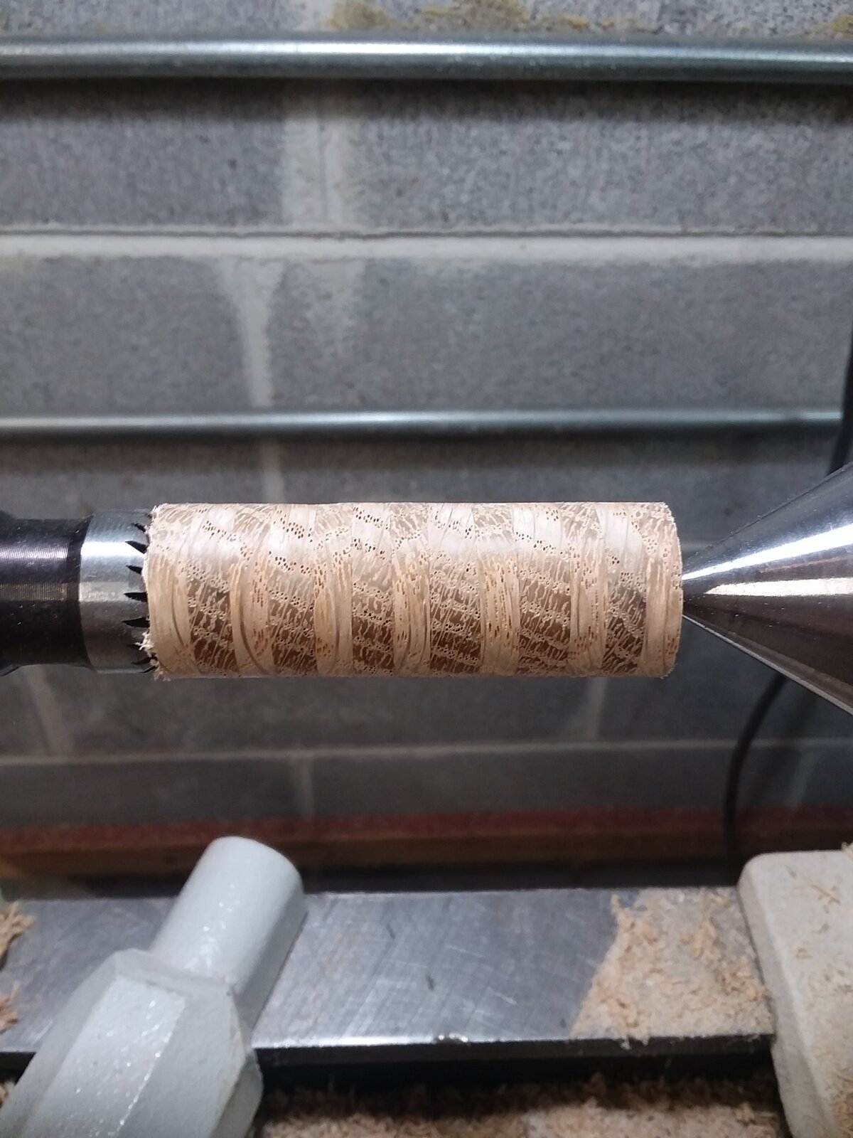

I can't remember the project but I had some leftover strips of plywood. I glued (TB III) some squares of 1/4 inch plywood together, clamped them and set for 24 hours. I turned to round on live center and spur. Going to get ambitious, drill and see what they will look like for a pen. Should make a decent pen with the larger diameter blanks. Enjoy.

I think it will look awesome. Some very common materials used creatively are excellent and inexpensive. After turning to dimensions, consider a quick rub with some stain, let sit so it gets into the open pores, then sand and finish.
