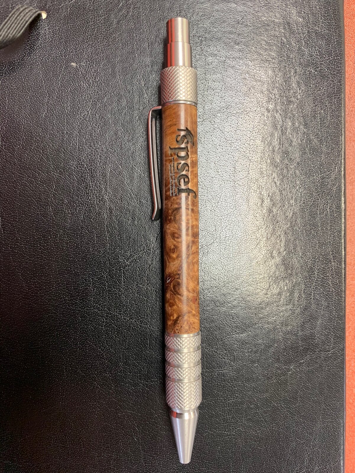

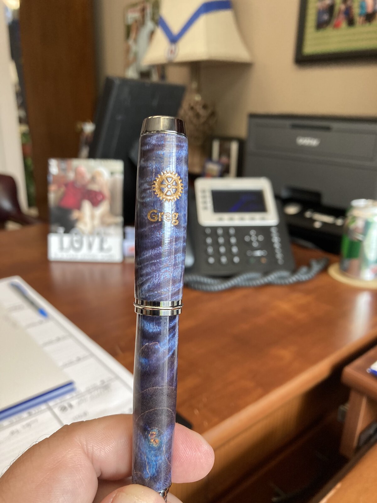

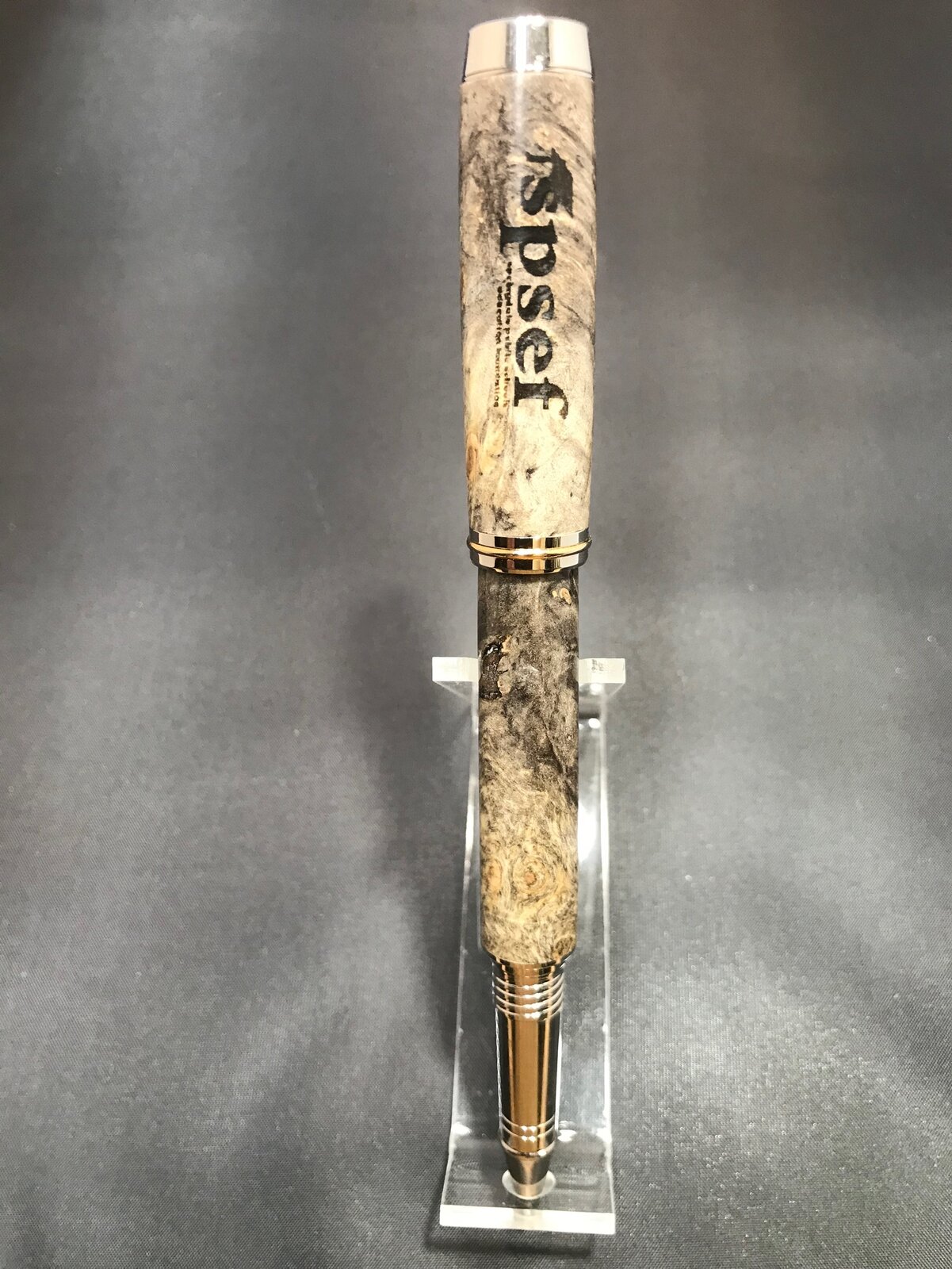

Good Afternoon Rick,
I ran across your post and thought I would share my experience with you. I have been engraving pens for a couple of years now. I started small with a NEJE and then graduated to an ORION (Chinese made Generic) 40 watt laser and have now moved up to a Glowforge. The Glowforge is a 40W CO2 laser and will not etch metal directly....I use a spray on coating that allows me to permanently mark metals, glass and ceramics. I tell you all of this to say that I am not an engineer by any sorts and I was looking for something that was browser based and not software platform specific. I want to spend as little time as possible learning a graphic design program and more time turning custom pens. The Glowforge has been my answer and has allowed me to up my engraving game significantly. When you look at the price, they ain't cheap. But they are a solid choice for our line of work. If you are interested, I can give you a link (as a GF owner I am provided a referral link from GF that I can share) that will provide you with a discount. Even if you don't want the link, I am happy to share with you in greater detail my research and some of my project results. Feel free to reach out to me with any questions you may have.
