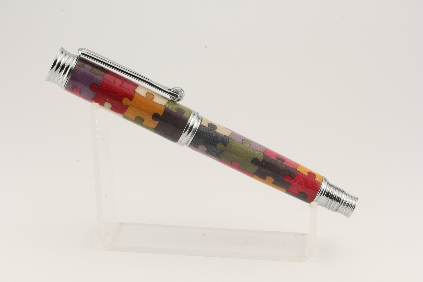

I've heard that. I guess I have been lucky. Over the years I have made perhaps 100 inlay kits. Including that one. I pretty much use the same sequence for everything. I use regular sandpaper 100 to 320, with a few steps in between. Then I use compressed air get all the dust out of the pores. Many coats of CA. Then micromesh. If it is acrylic I skip the air/CA steps. Lastly, a trip to the buffing wheel may be in order.
You will likely get many recommendations for success.
