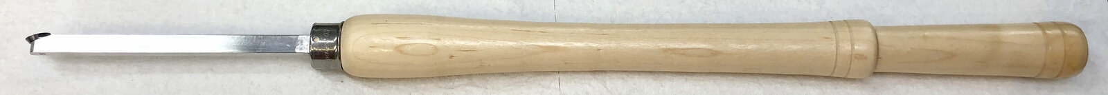

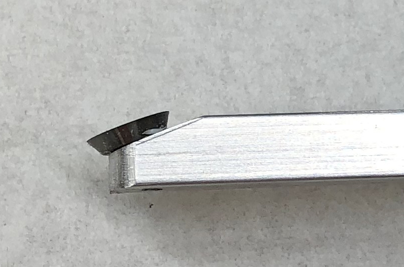

As monophoto stated above, the same effect can be created by tapering the top of the bar on which the cutter is mounted. This is a tool that I made which mounts the cutter at 20-degrees so the scraper is presented with a negative rake angle. So far it is working very well.
Regards, Dave (egnald)
View attachment 240058View attachment 240059
Now THATS what I'm talkin bout! A man after my own heart. What a great idea! Certainly worth a try.

Well, it's nowhere near as pretty as Dave's but it works just fine! Great idea. Thanks for all of the input. Gonna send back the neg rake ones I got.
