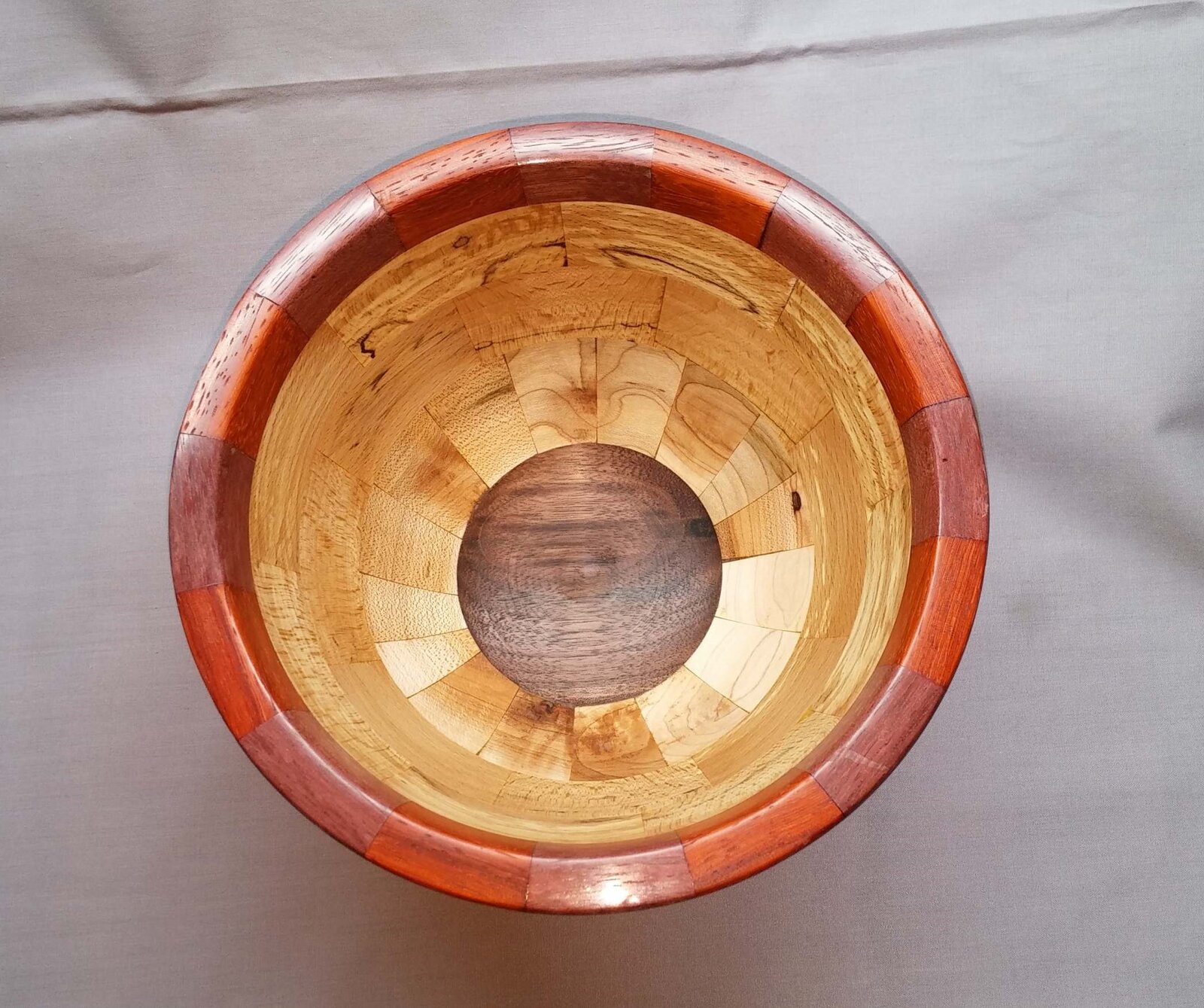

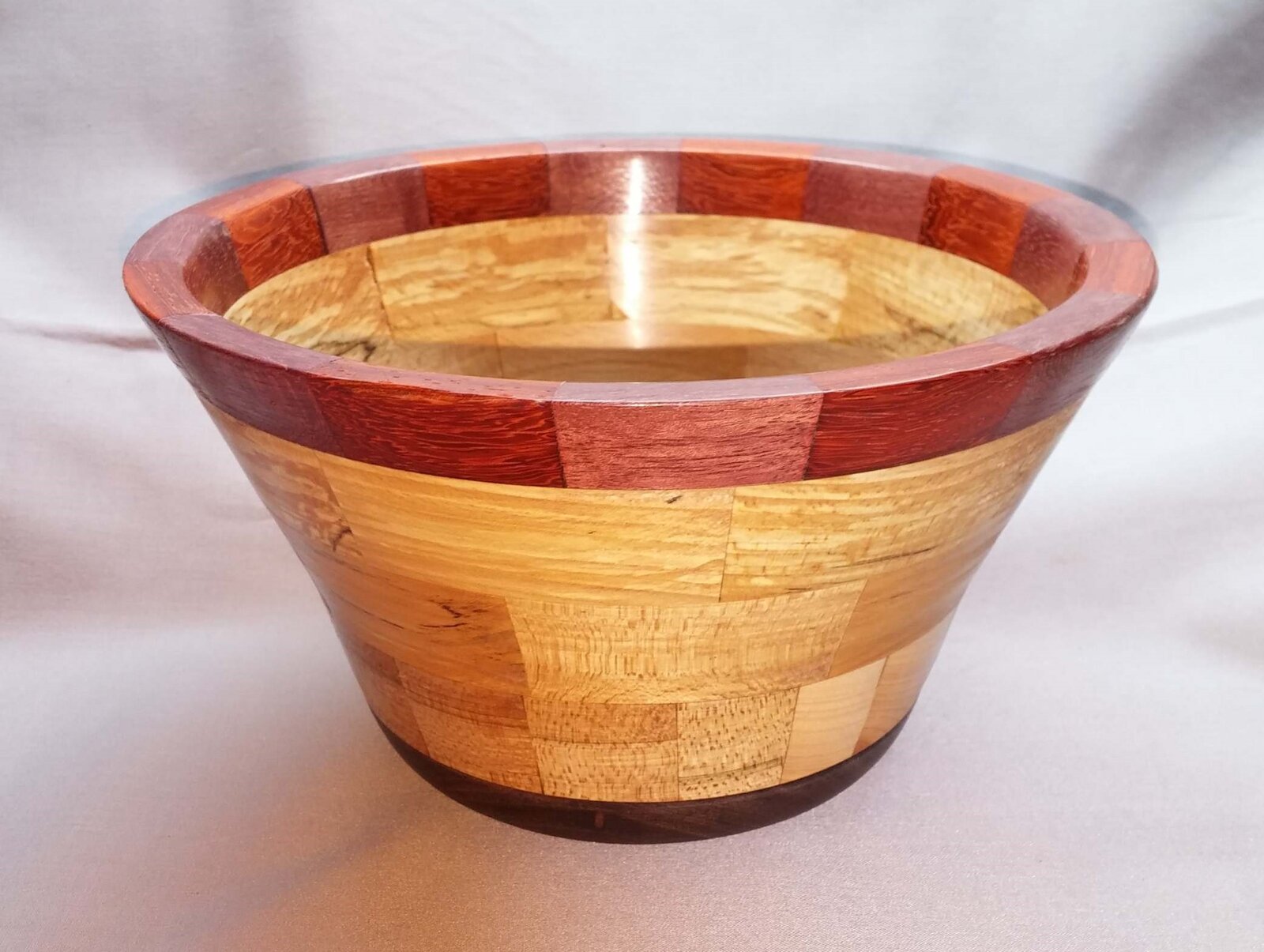

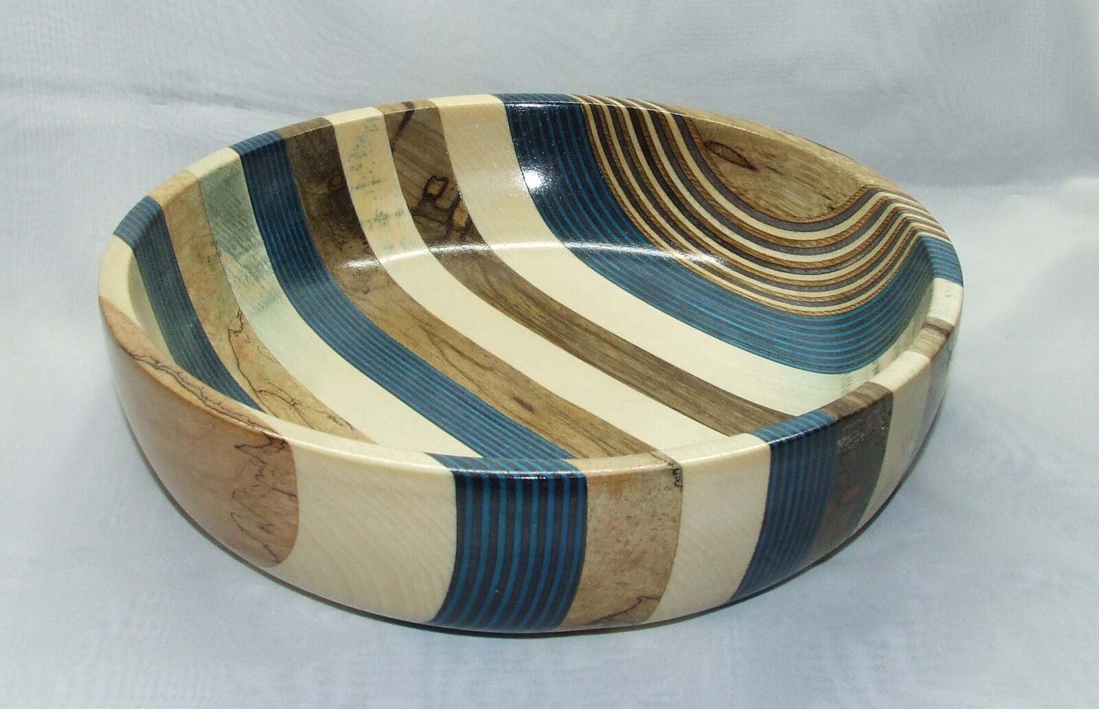

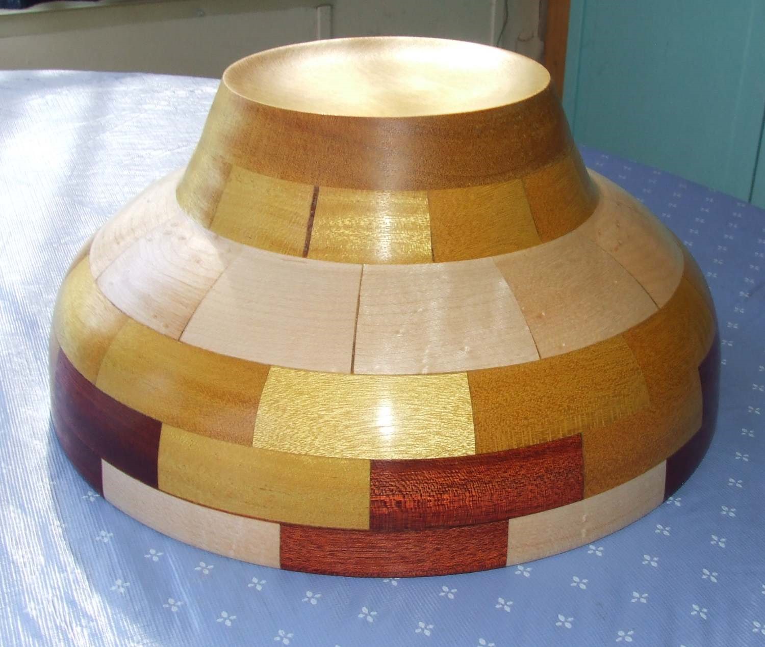

So far I've tried 3 segmented bowls... the first was just a series of flat boards glue together that I initially had planned to use for pepper mills blanks, but tried a bowl instead... worked out well and have sold it to a gentleman in the UK.... the other two I actually tried to do segmented rings.... they turned out pretty well, but I still need to work on my joints to get them tighter... I use the hose clamps to hold them together and am having some problems with them not tightening up well or the screw twists the clamp and so far I've ruined about half a dozen...
This first little bowl is 7 inches diameter by 3 1/2 inches high... finish is just buffed with my version of Yorkshire Grit...mineral oil, beeswax and DE. Wife claimed it.
This one I just finished turning yesterday...still need to put a permanent finish on it and sign int.... the bowl is 10" diameter by 4 1/2" high... so far just the abrasive grit polish on it and I still need to sign it. It was supposed to be another inch higher, but the top rim of Birdseye Maple popped off and broke into all it's segments... this same ring jumped out of my cole jaws when I was trying to flatten it and skidded across my arm taking a patch of hide about 2" long by 1" wide...
I didn't quite get the shape I was going for, think I need another ring between the maple and yellowheart near the bottom....
This is the first bowl I mentioned... forgot to put up the picture.

This one is about 11 x 3 inches.

thansk for the clear explanations and inspiration. Chuck one suggestion ( a clean one for your health) is to use a SOLID top ring cut from a plank or, if you must , then joint up boards to make that plank and take REAL CARE to get the joints of that jointed up plank close and accurate !
I am assuming you gripped the top ring in expansion mode in the chuck? If not my apologies ! In contraction mode you should not ( usually ) have an issue with exploding joints but with a solid ring you stand a better chance of success (IMHO).
Must disagree with your terminology though Chuck, " my wife claimed it" , No, NO , NO , It was " A loving gift you deserve for all the kindnesses you have shown over our lives together"๐Ÿฅฐ . You never know when you'll need the brownie points for some major tool investment, earn em when you can !!!!๐Ÿ˜‰๐Ÿ˜‰๐Ÿ˜‰

I'll have to keep in bind about the solid top ring... I didn't have a board wide enough for the top but do have a jointer that I could do a glue up.... and I was holding the ring in a contraction mode but evidently my pins were a little short and I let my sanding board slip off the edge and (how do you get a catch sanding ( :confused: ) evidently the edge of the sanding board caught in such a way as to throw it out of the jaws.... then when turning I think I got too thin at the joint of the next ring... that caused it to let go.
