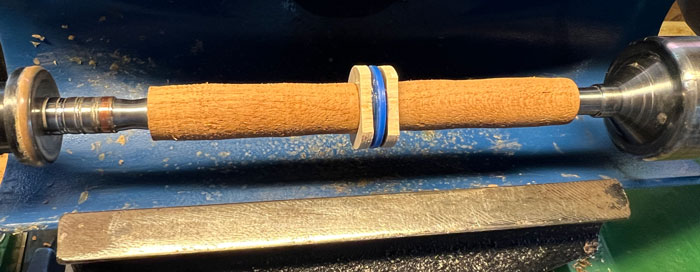

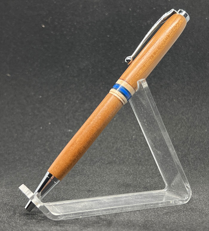

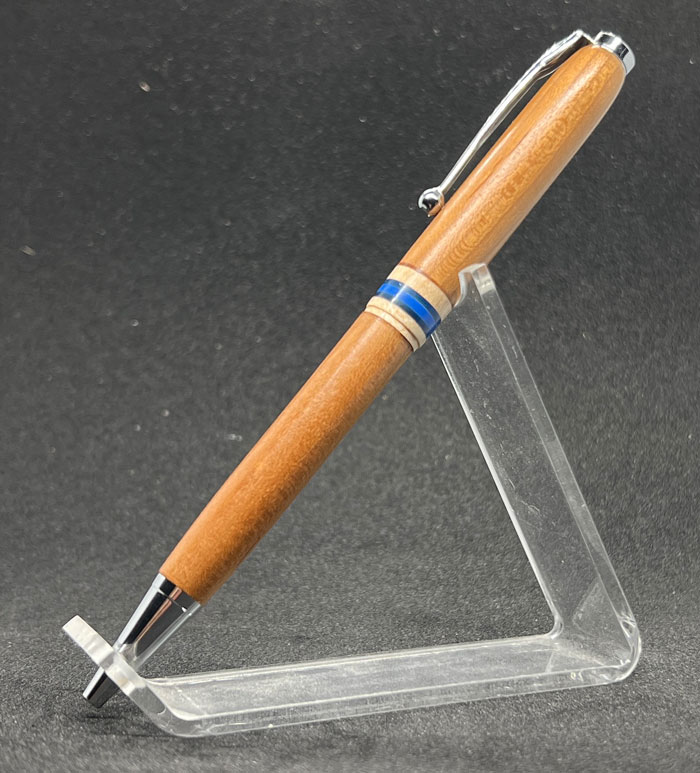

This is cherry with a centerband of hard maple of 2 kinds of dollar store plastic.

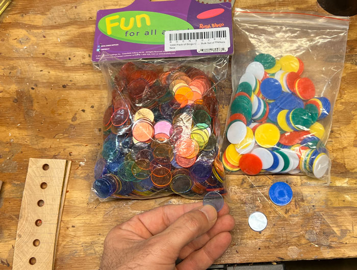

I found these inexpensive chips and wanted to try a centerband "sandwich" of:
hard maple
blue translucent
blue opaque
blue translucent
hard maple

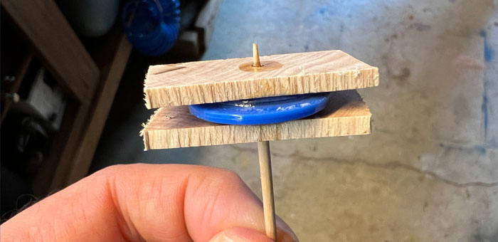

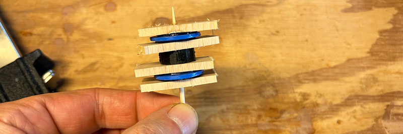

I wanted to use CA glue, but the chips slid all over. I could have used glue boost I suppose, but I don't own any.

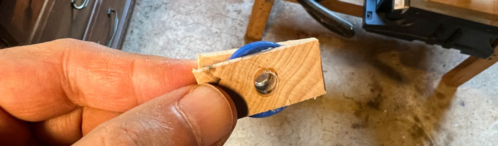

Instead, I drilled thin holes through each piece separately, applied CA glue, and put them on a toothpick, shish kabab style to dry.
Once dry, I drilled through the middle with a 1/4" bit...
...and added to the mandrel.
Thanks for looking.

Mass producing these centerbands

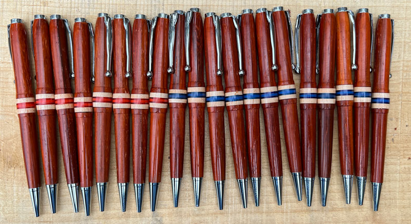

I figured out a few things while making lots of these hard maple and plastic centerbands for holiday gifts.
(See above for overview.)

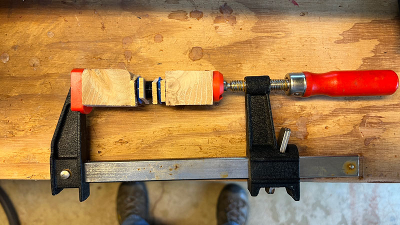

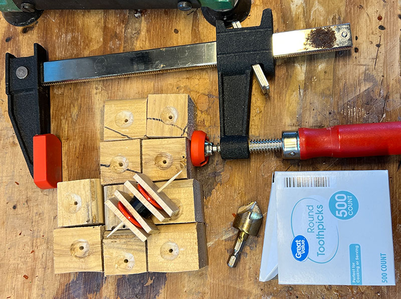

Two sandwiched centerbands fit at a time on a toothpick during gluing.

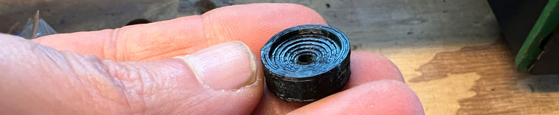

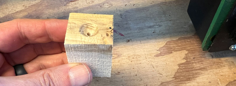

I cut small squares of 2x4, drilled a guide hole, and used a coutersink bit to create gaps so glue wouldn't attach.
This little black spacer was 3d printed, although it could also be made from wood with a coutersink bit.
The key feature is that it won't get glued to the centerbands even if a little CA leaks out because of the conical indent on either side.

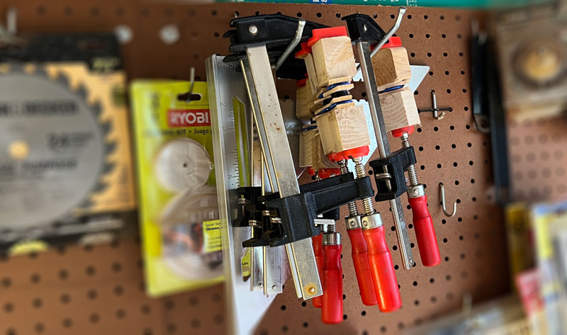

(I tried to make a long stack of these, but it did start to bow, so I limited the mass production to two per clamp.
But I have plenty of small clamps and made about 10 at a time, hanging the clamps vertically to dry.
