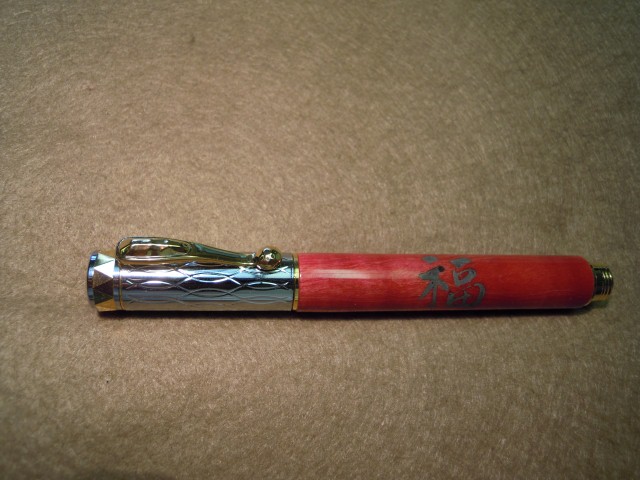

I made this pen today to give to our neighbours who are Chinese. As you may know, red is a "Good Luck" color. "Engraved" on the pen barrel are the characters meaning "Good Luck". The blank was bought from PSI, and I think it was made by Lazerlinez. The characters were deeply engraved and I had to fill the voids with black epoxy to a flush surface, then, when dry, turned to the requirements for the Electra hardware which I bought from Exoticblanks. The usual process of finishing followed: 4 coats of thin CA and 12 coats of medium CA ... sanded 400 - 2000 ... and then micromeshed 2400 - 12000. Finally, 3 applications each of Novus 3 and Novus 2. The straight lines of the Electra design make for an unchallenging turning/finishing experience .... but I like that (!!!) and I like the result. Hope you do too. As usual, I apologize for my photography ... but I'm learning !
Cheers ..... and Good Luck !!!!
Mal

Mal; One of the things I do with dyed blanks is to use a Transtint liquid dye on the blank after sanding, but before applying CA. It REALLY makes the color POP!!!!
I apply a drop of the dye to a bit of paper towel and then rub onto the blank while turning the lathe by hand.
Do wear nitrile gloves, unless you want to be a true rainbow child!
I just made three Majestic Squire pens for a Chinese couple that run a Chinese restaurant. Their family and us have been friends for about 15 years!! They are retiring and closing the restaurant.:frown::frown::frown:
Now my wife and I have to find somewhere else to get good Chinese food.
Do you have problems with the inlay?? That is the part I hate most or like least...

Randy, thank you very much for that tip. I thought of redying by immersion, but didn't want to have to wait for drying. Your suggestion is a better way to go.
I don't mind doing the inlay but would like a darker black epoxy. Maybe I could mix in some black chalk dust (construction line marker).
When you really crave a very good Chinese meal, hop over here. Vancouver B.C. has the next biggest Chinatown after Frisco !
