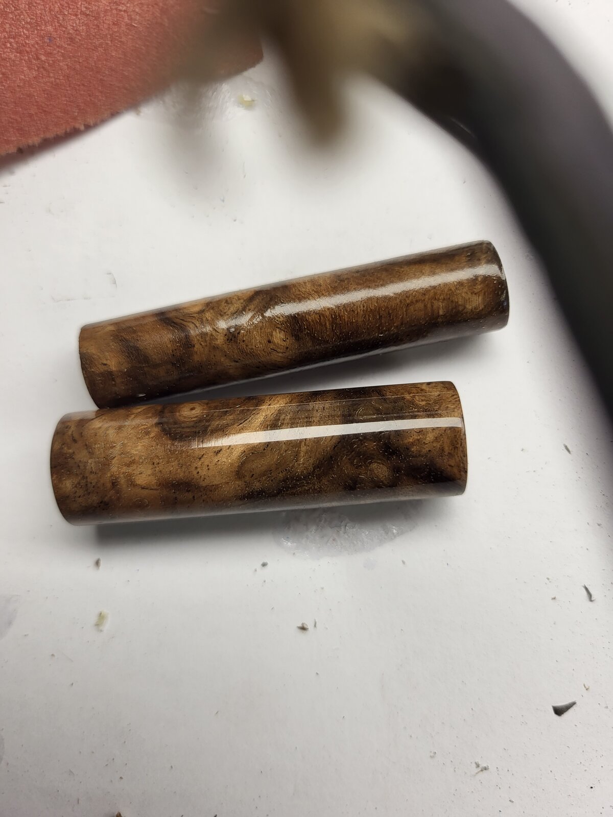

Here it is, not the greatest wood to experiment on but it turned out fairly good. I applied 3 coats of thin and 3 coats of medium (by use of a shop towel) with accelerator in between each coat. I then sanded with MicroMesh and polished. I did the sanding stage twice after I noticed ripples, and attempted to use #000 steel wool to remove them. Long story short, there is now steel wool all over my shop.
I'm going to continue experimenting with lathe-on application as it seems to give a better finish, and I'm definitely gonna try using some foam pads instead of towels. Thanks for the help everybody!

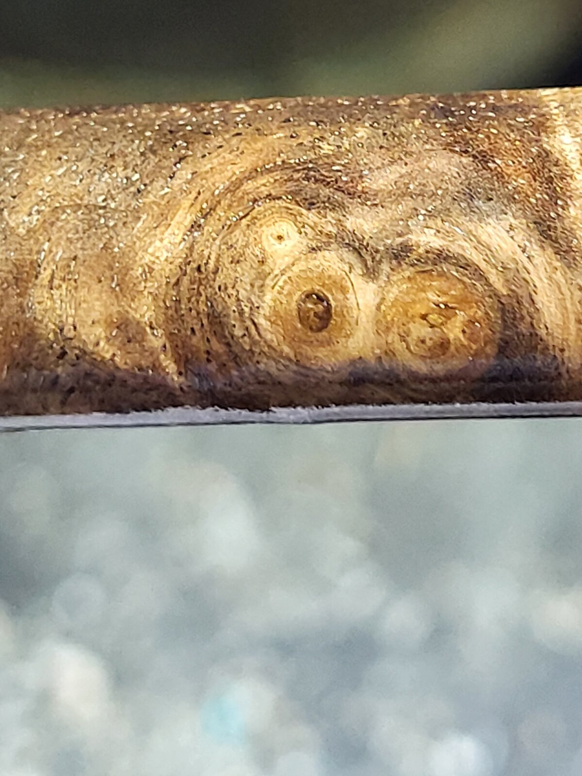

3 coat thin and 3 coats medium glueboost no sanding
Close up no sanding
One sand and polished the upper one not.
