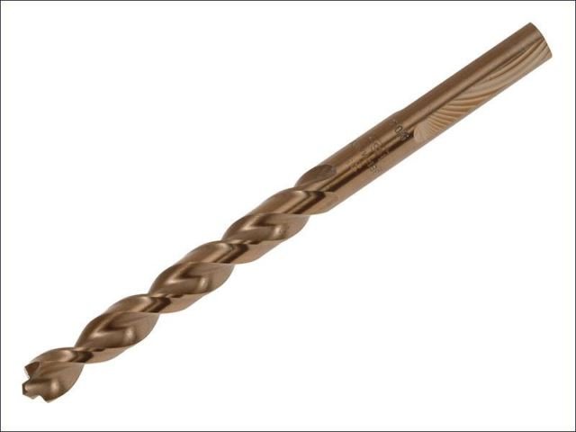

Look into DeWalt Extreme 2 bits they have a drill point and flattish lands developed for cutting stainless steel by De Walt I have used them for twenty plus many years successfully. The 7mm drills give me hundreds sometimes many times that. I regard their cost as nominal only.
Peter.
PenPal
Nov 29, 2006
2,708
Canberra, A.C.T., Australia.
Pic of DeWalt Extreme 2 drill.
Peter.
