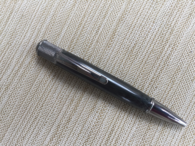

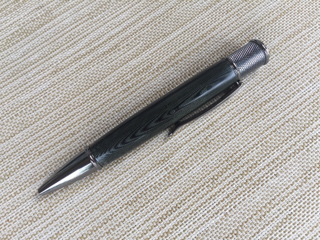

I saw this new kit in the Bash and immediately ordered it. Even nicer than I expected. My first thought was to use Damascus steel but the piece I had was a bit too short. I remembered I had a large block of Micarta in my knife making supplies and decided to give it a go. The Micarta is made of layers of Black canvas fused together under pressure and temperature with a phenolic resin. The canvas gives a very unique pattern. It turns, sands, and polishes like a nice hardwood. It is really tough stuff and impervious to most chemicals. I dry sanded to 500 grit and polished with pink rouge on the buffer.
[ATTACH=full]248196[/ATTACH][ATTACH=full]248197[/ATTACH]

That pen is very beautiful !!!!
I would like to get some of the kits.
Can you please specify the tube length ... I understand it is a 27/64" tube ... and also the finished diameter of the barrel .... Thanks.

Great Pen, Danny.
Excellent Blank Material, Fit and Finish.

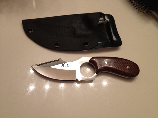

Love the Barbed Wire, as shown with the Knife, would also make a great Blank, if thick enough.

Gorgeous looking pen . Love the way that material turned out. Really eye catching.
May I ask what method you used to do the finish on your pen ?
No finish applied. Just sanded and buffed.
Thanks everyone for the kind comments. I've used Micarta for many knife handles and really like how it turns. I use to make my own, I might have to try making some pen blanks.
