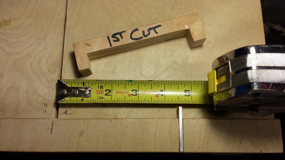

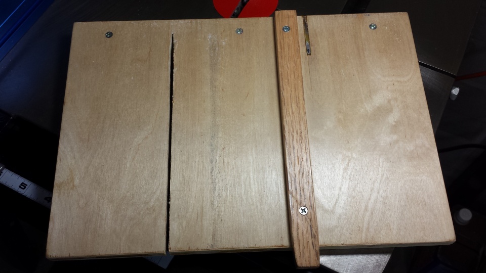

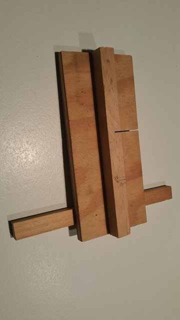

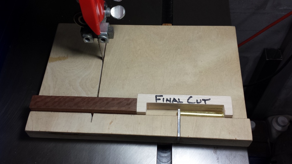

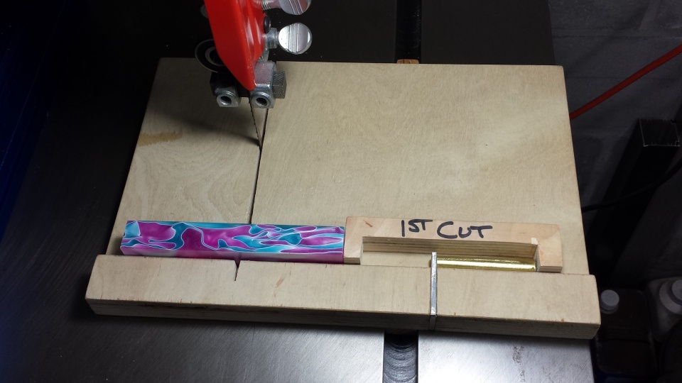

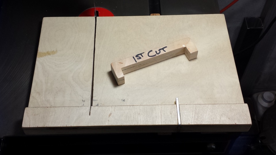

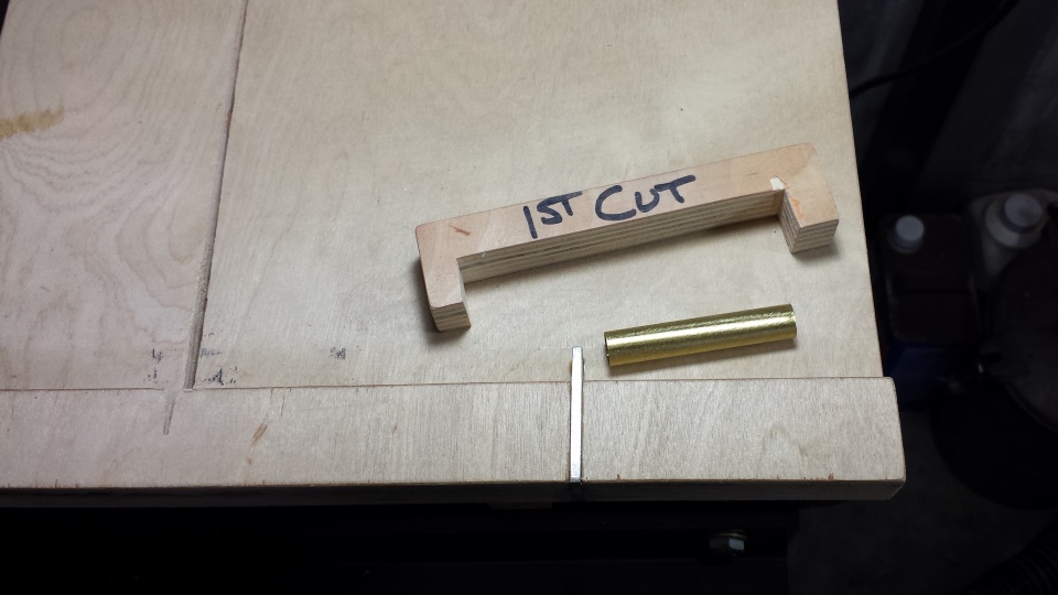

I use my band saw with a sled/jig to cut all of my blanks. I never measure anything anymore. Below are a few photos of the sled I made. Basically it is a simple sled with a "key" and a "gauge".
The 1st photo shows the sled with a 1" wide fence along the back edge. If I were going to make another sled, I would make the fence 2" wide to give a little more room when you cut through the blank.
The 2nd photo shows the location of the "key". This measurement is not critical because the "gauge" is what determines length of the cut blank. Again, if I were to do this over I would move the key farther to the right leaving about 5 1/2" between the key and the blade. That would allow you to use the sled to square the end of a 5 1/4" blank if needed. I used a piece of 1/8" flat aluminum to make the key and epoxied it in a kerf cut on my table saw.
The 3rd photo shows the bottom of the sled. I simply used a piece of oak as a runner cut to fit the slot in my band saw.
The remaining photos show how the sled is used. The pen tube is positioned to the right of the key. The gauge is then placed over the tube and key then pushed to the left pressing the tube tight against the key. The blank is then positioned against the fence and the gauge. Hold everything in place and cut.
My gauge is set up and labeled for 2 different sized cuts. The "1st Cut" side of the gauge is used to cut Acrylic, PR, Inlace and other similar materials a little longer than needed. After the 1st Cut, I drill the blank stopping just before the going all the way through. I then flip the gauge and make the "Final Cut" cutting off the un-drilled end exposing the hole through the blank. This prevents chip out and damaging the blank. On wood blanks I only use the "Final Cut" side of the gauge.
If you want to make a similar sled, I suggest you make the sled with the key installed first. Then you will need to figure out the length and spacing for your gauge. It's not that difficult and it really saves a lot of time spent measuring and cutting down the road. There are probably a dozen other ways to accomplish the same thing but this works quite well for me. I am sure someone can come up with something similar for a table saw.
Hope this helps.
