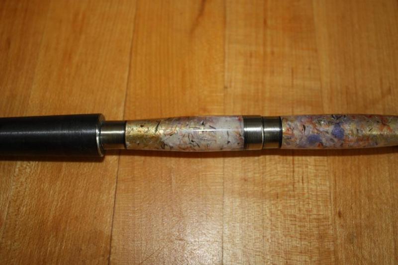

I have been experimenting with casting and finally got around to turning one of the castings that my wife has done. It is a clear cast with some acrylic shavings in it from some other turnings.
We did the normal cast. Allowed it to dry for what seemed forever. It sat for well over a week. It didn't need that long, I just didn't have time to do anything with it. It didn't have any signs of air bubble in it. I squared it up and drilled the holes for the brass. Used Thick CA to glue the brass in the blank. Squared the faces of the blank with a pen mill and sander and then turned it.
After I finished I noticed that the blank was cloudy in a couple of areas. What do you think caused it?
BTW, it was with Casting Craft from Michaels. It was one of my first castings and have since turned a few from Silmar 40 and they turn much nicer.....

Fred, I have used the same PR materials from Michaels and have had some of the same issues. So far I can only narrow it down to excessive heat while sanding. I had a tendancy to get a little aggresive and did not wet sand. After going through a few of my clear blanks this way I switched over to wet sanding and the cloudy areas have been reduced, not totally eliminated though. So there is still something I am not doing quite right or am still coming across some heat maybe while turning (which is a possibility as well). Just my two cents worth....

I always wetsand anything that is not wood. I try to keep the heat to a minimum but can't always do that of course.
I had something cross my mind last night after my post.....Could it be an area of the tube that does not have any CA glue on it and I am seeing the dust from drilling? I don't clean out the inside of the hole after it is drilled. Does anyone?

I think I can see the tube through the blank. Which means it could be the glue, not the PR, that has gone cloudy. Hard to tell from the picture. If you look through the blank across the top of the tube (not down at the tube, but across it at a tangent) is the PR clear or cloudy?
Heat can cause cloudiness; tool chatter (even at the microscopic level) can cause cloudiness. Make sure your tools are very very sharp and you aren't being too aggressive.

Is the resin cloudy? Or did you not polish the INSIDE of the hole??
I suspect you are seeing the drill marks, that were not polished out on the inside of the hole. Glue will fill SOME and make them disappear, but this is NOT a reliable way to get a clear view.

Not knowing any better, do you have to polish the inside of the blank after you drill it? How do you polish it?

Only if you are trying for a clear blank. In this case the blank is clear so you can see the tube. But this also means that it is clear so you can see bad glue, bad drilling, scratches in the tube (you did rough it up so the glue sticks, right?), etc.
When I did my clear blank I sprayed the inside of the tube with pearlescent paint followed by gold paint. Now you have the clear blank showing off all the depth of what you cast but you can't see into the hole to see the tube, etc.
