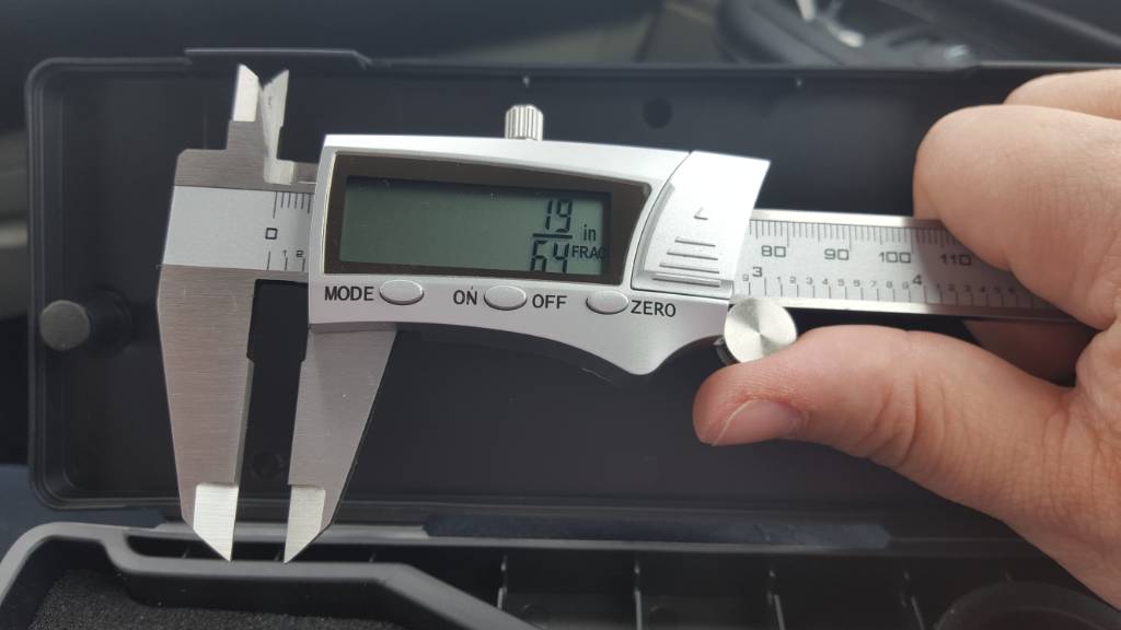

Caliper Upgrade
jennera
Feb 12, 2017
236
Texas
A big upgrade from the Harbor Freight caliper we have been using! I didnt know they would do fractions!

IMHO, fractions are not terribly useful. I much prefer the decimal fraction display, e.g. 0.375" instead of 3/8", and that's what I use exclusively or the metric when appropriate.
I guess it's because my mind works that way !!
Fractional display is often an approximation on the calipers

I find the fractions function handy for checking drill bits. Bit slips once or twice in the chuck and you can't read the size any more.

Jenn would you give the make of your caliper and where you got it? Thanks.
We purchased it at Lowes for $35. They are made by General Tools. The model # on Lowes site says #1467.
They have a depth guage too.

Don't throw away the HF one!
1) Even if the numbers are inaccurate, I find it handy for checking if two (or more) parts are the same size
2) The General Tools one that I have uses plastic jaws, which deform fairly easily (especially if you push them onto something still spinning, don't ask how I know this)
3) So long as the locking screw on the HF one still works, you can set an opening and use it to test when a spindle is turned down to that diameter (getting a rub mark means it's real close, shave away the rub and you are at the target diameter)

I've got both of those calipers, and I far prefer the General one. It does go through batteries pretty quickly though--not ridiculous but faster than the Mitutoyo calipers I have--I've had to replace the batteries in mine twice in 7 months, so about 12-13 weeks for a battery life for me.
I have found them to be pretty accurate and they are great for determining the next size up or down in drill bits or whatever--I found them very helpful to have around.
