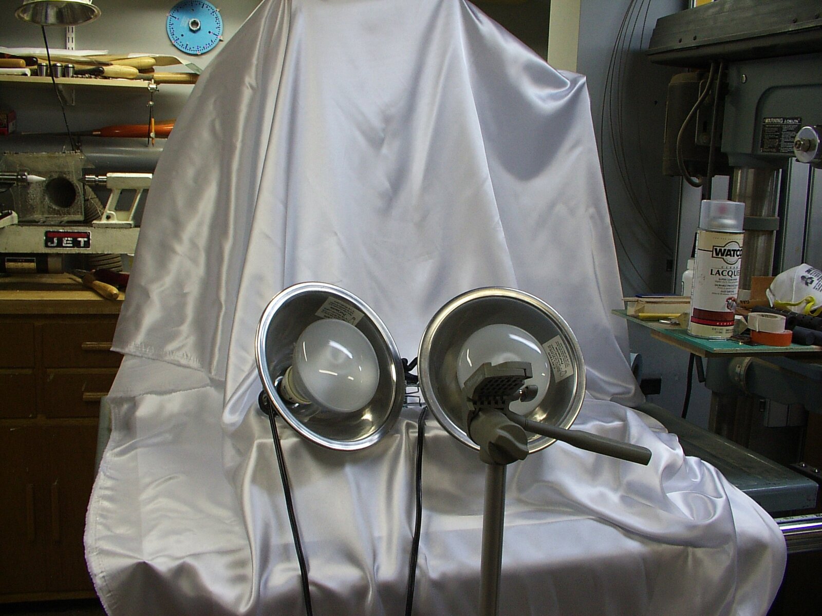

And that is how I do it also. I finish all pens with that method. Now this photo was in conjunction with a question someone asked me on another thread about my set up for taking photos. In it I mentioned the lathe in the background has my centers in the chuck for finishing and polishing. They just happen to be there because the last few pens I shown came off the lathe with that set up.
