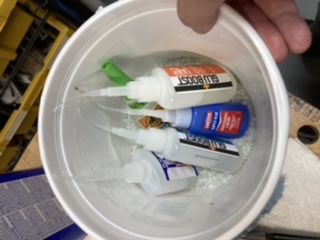

I keep my open containers in a plastic tub with 2" of silica sand in the bottom. I bought a 'big' order from Glueboost, and the unopened containers are sitting on a shelf in a box. What can I do to give the product maximum shelf life? Thanks!
