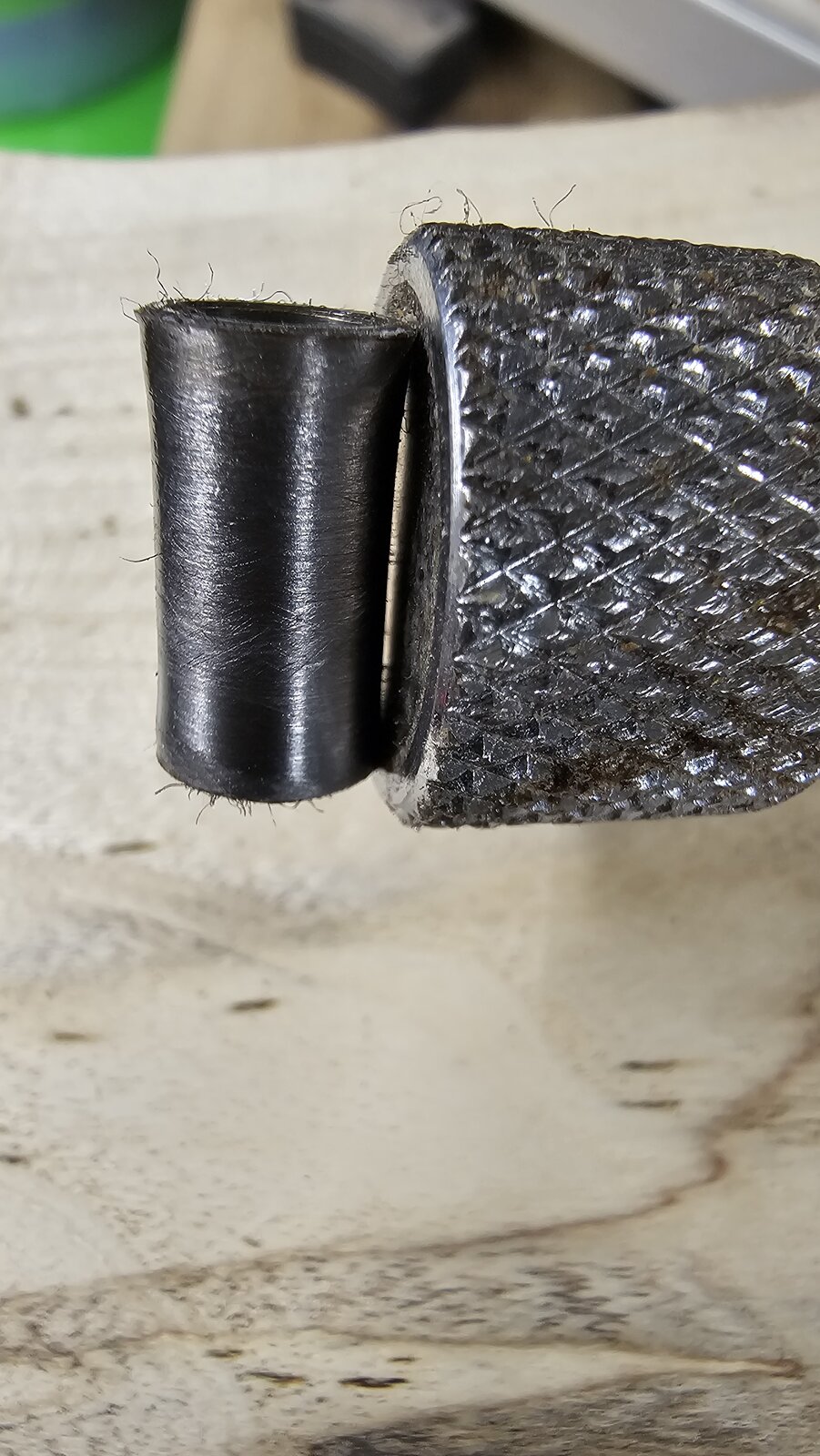

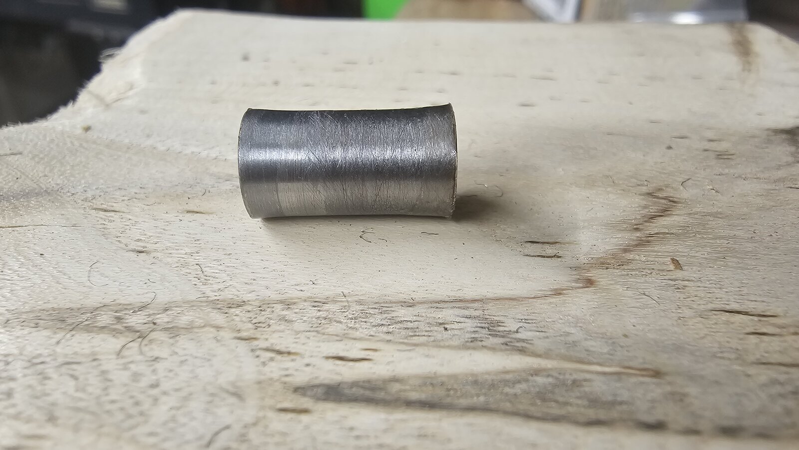

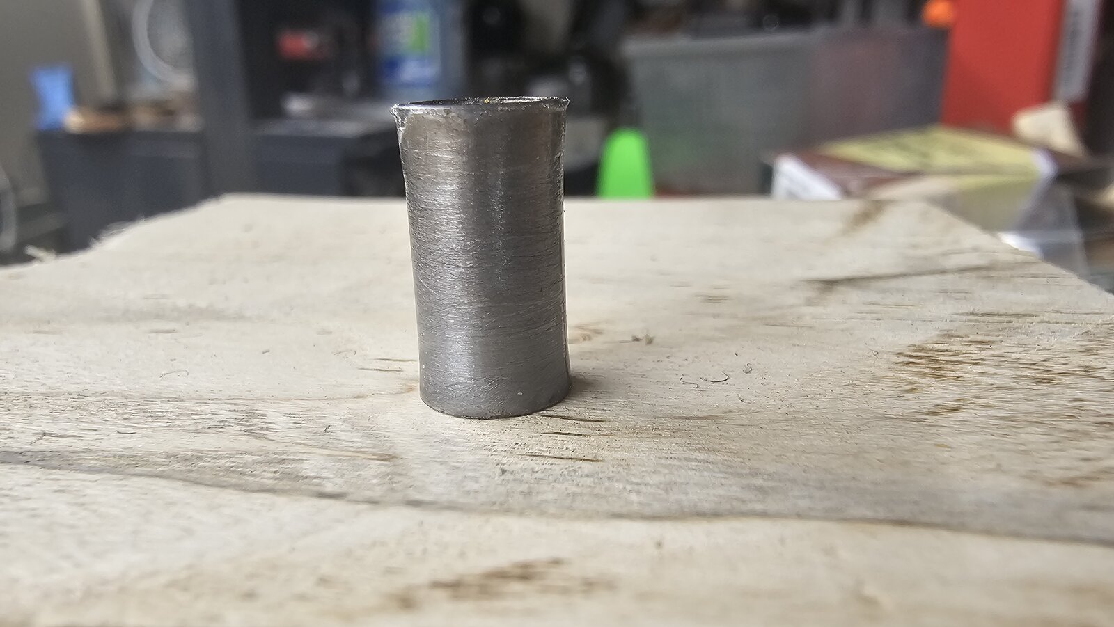

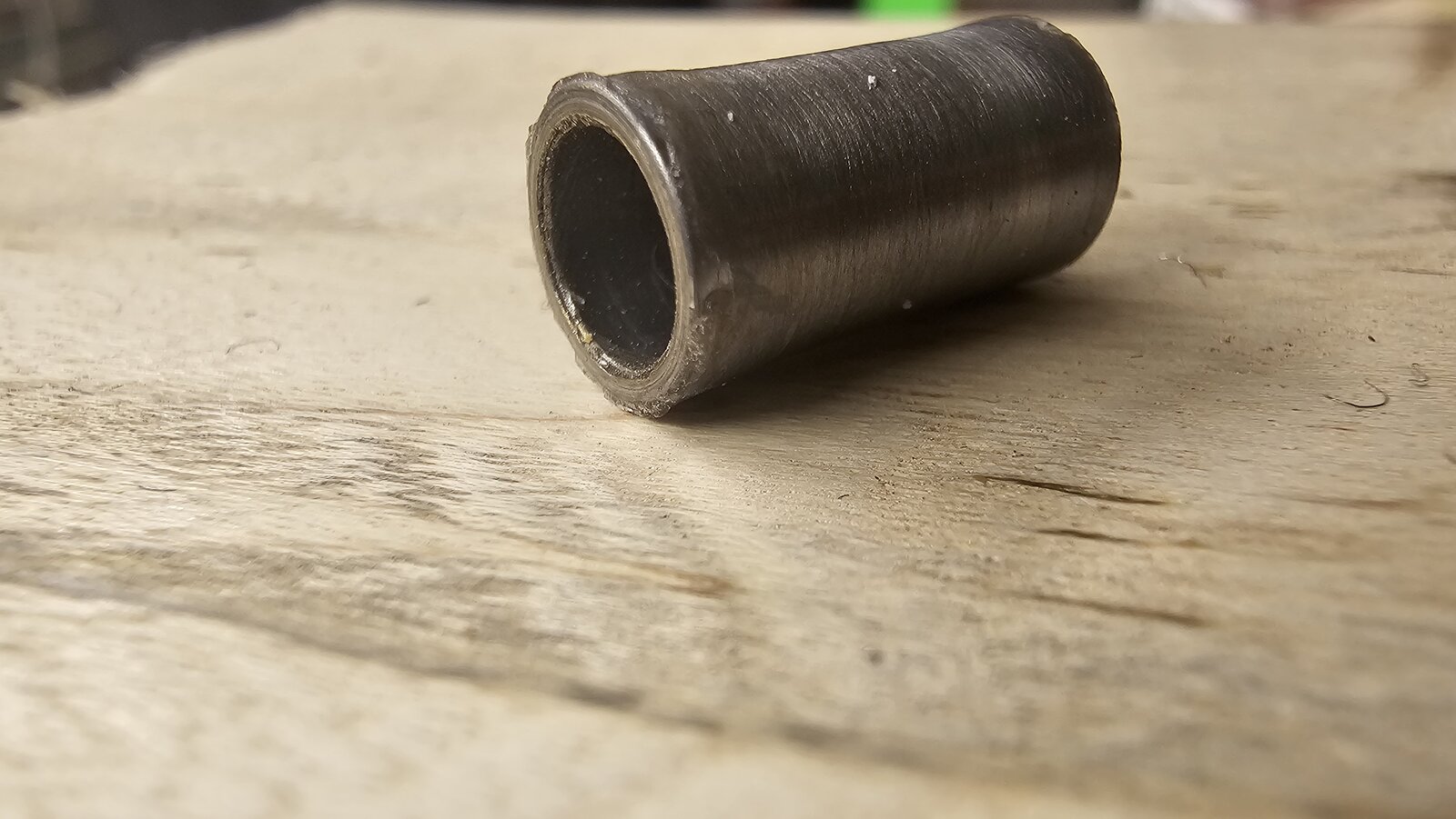

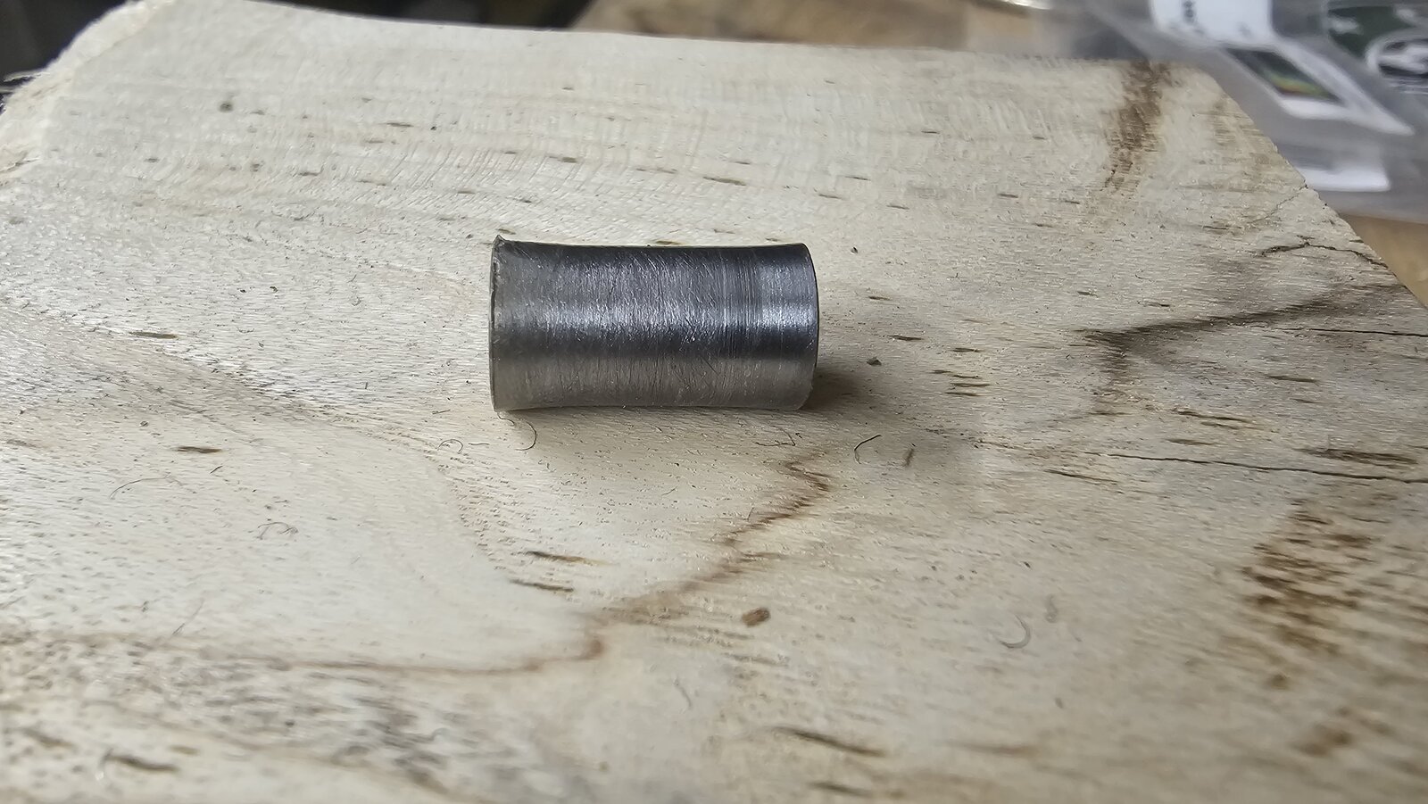

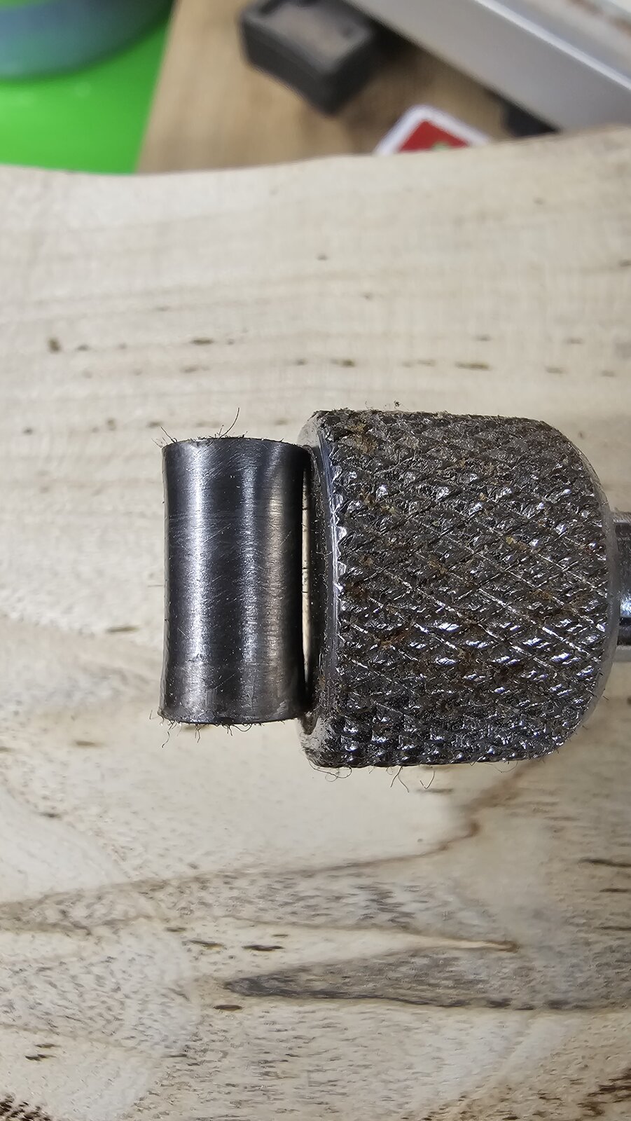

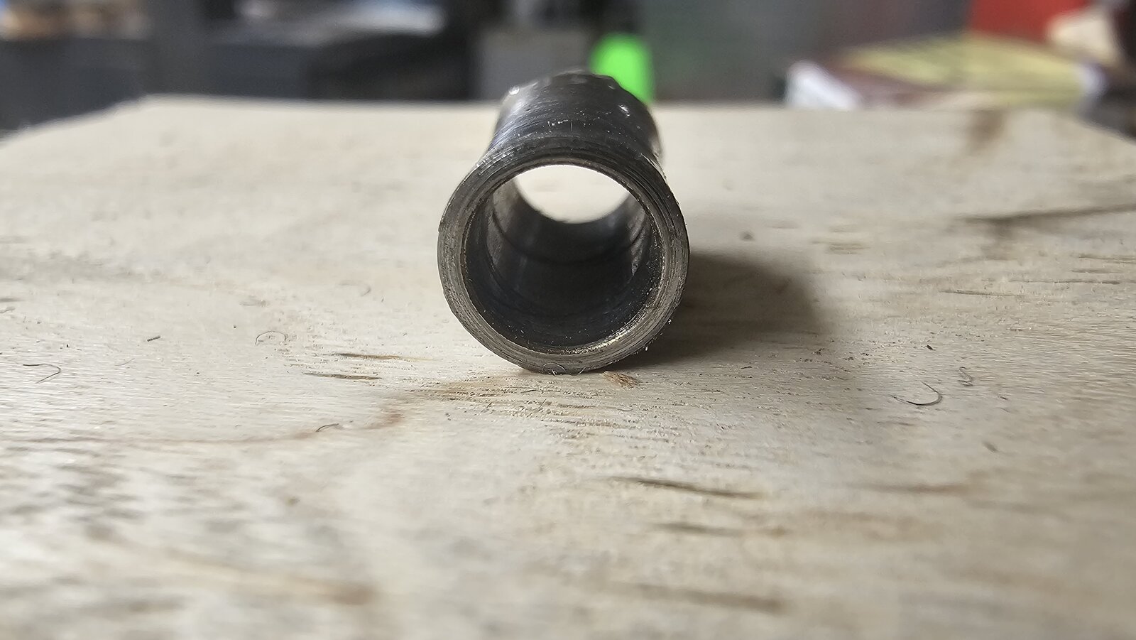

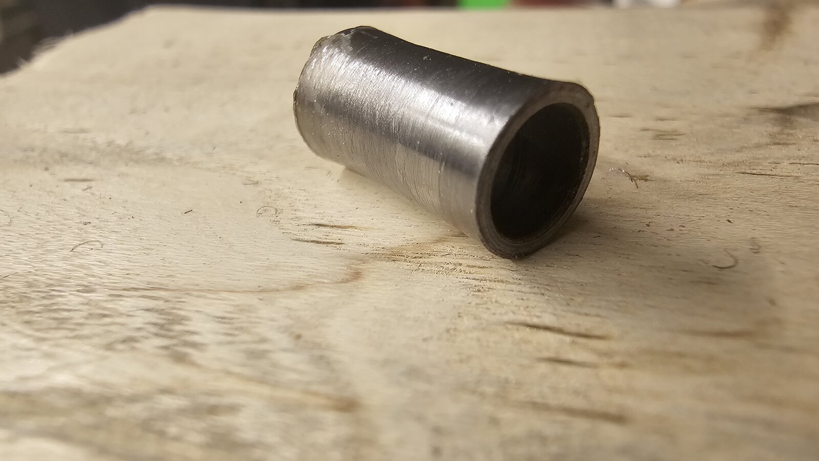

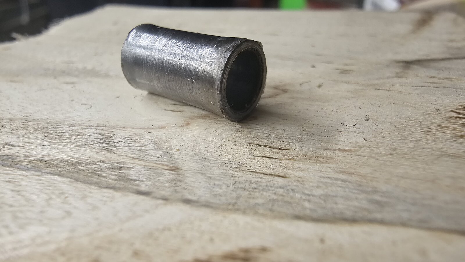

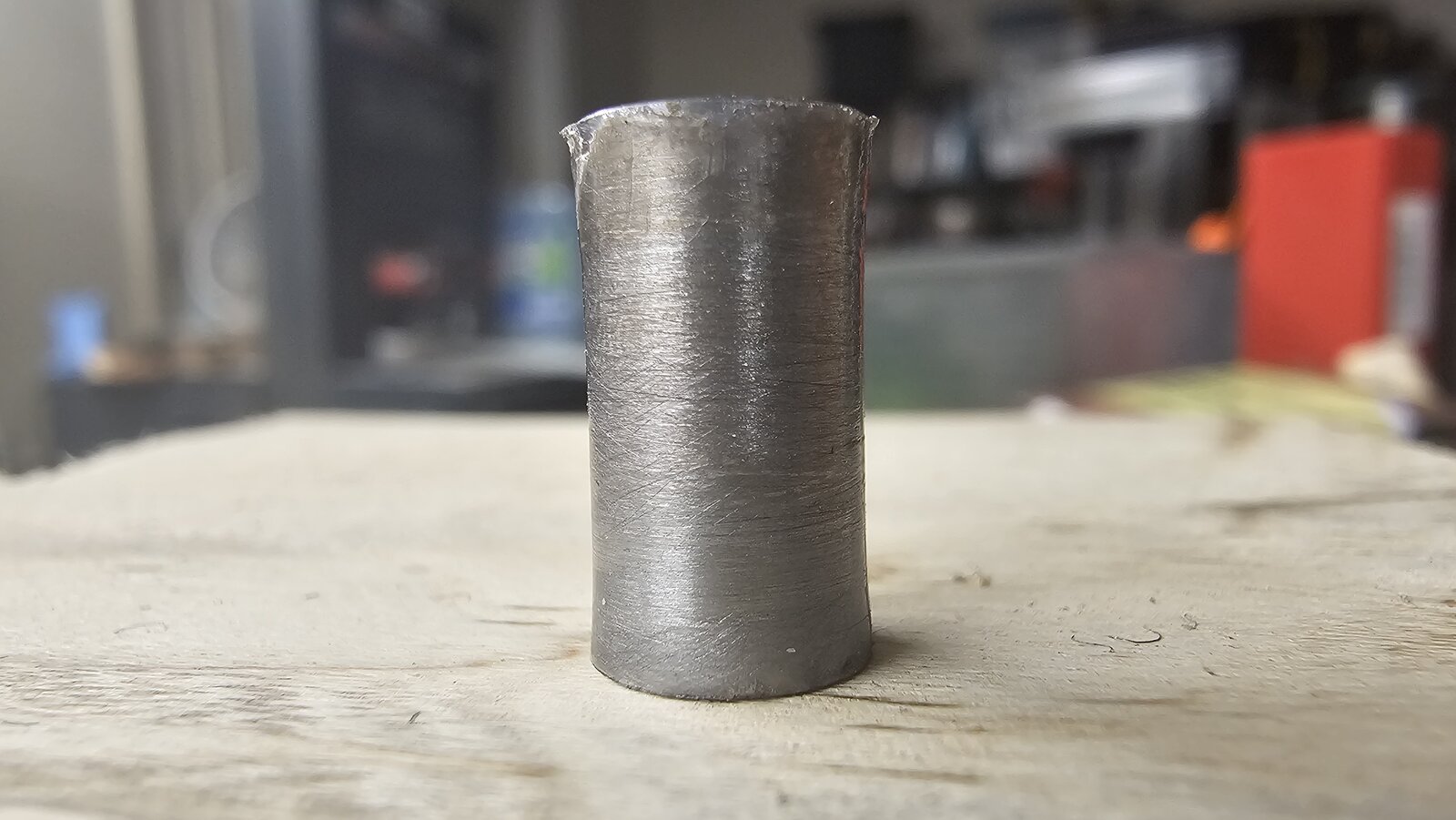

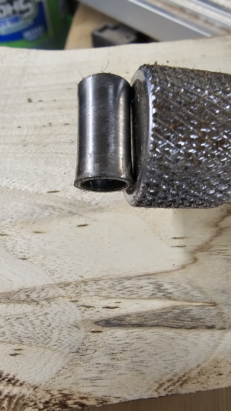

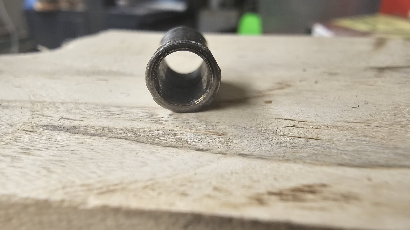

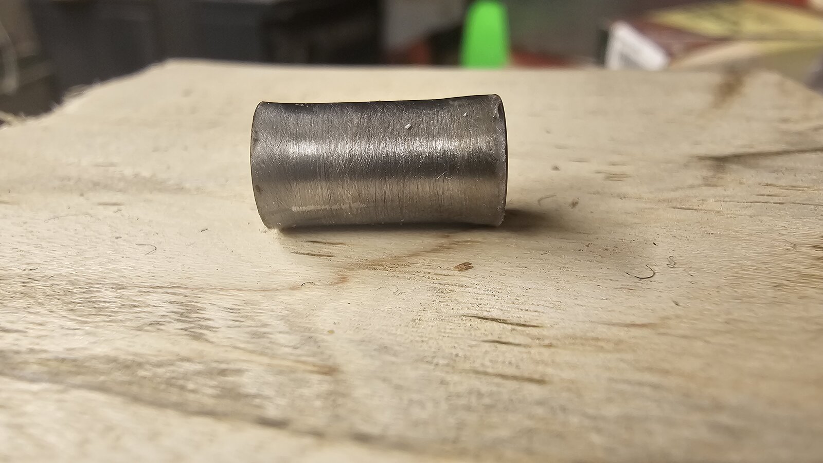

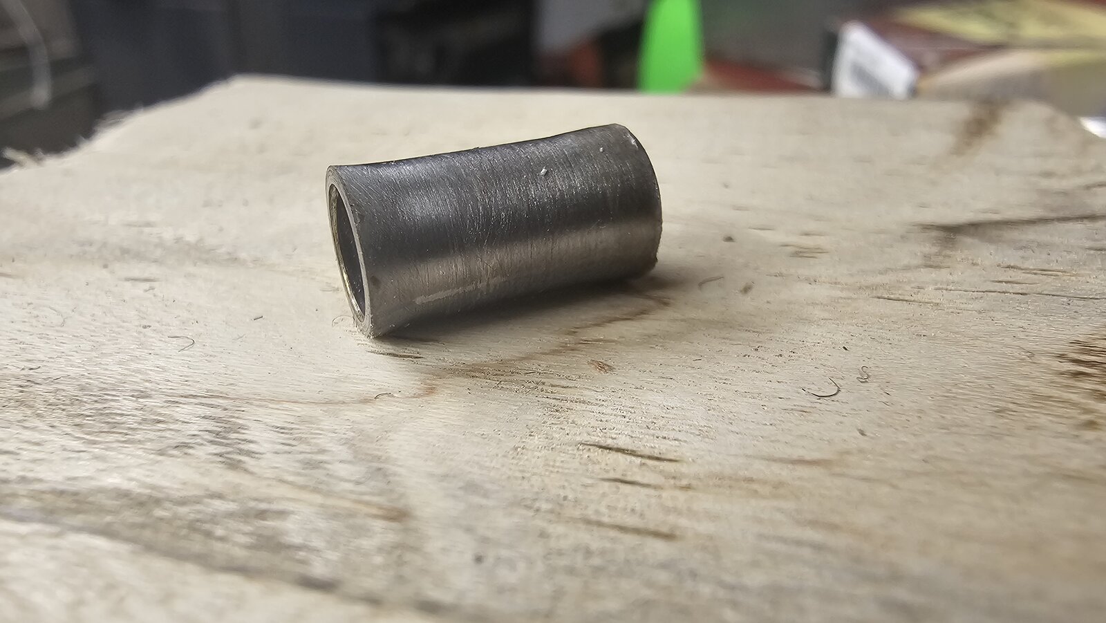

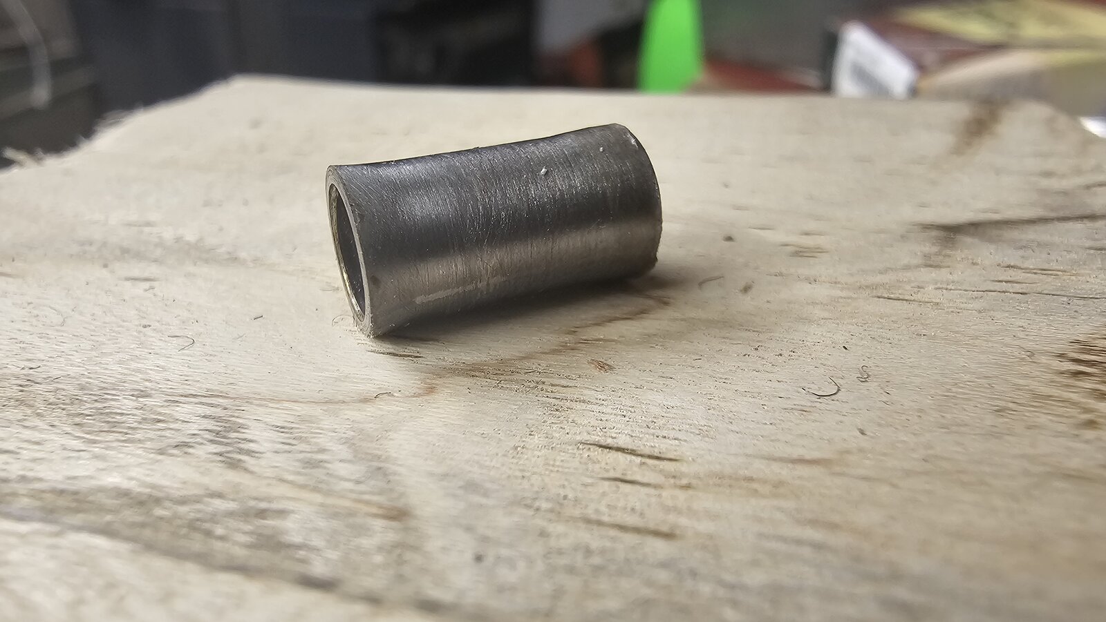

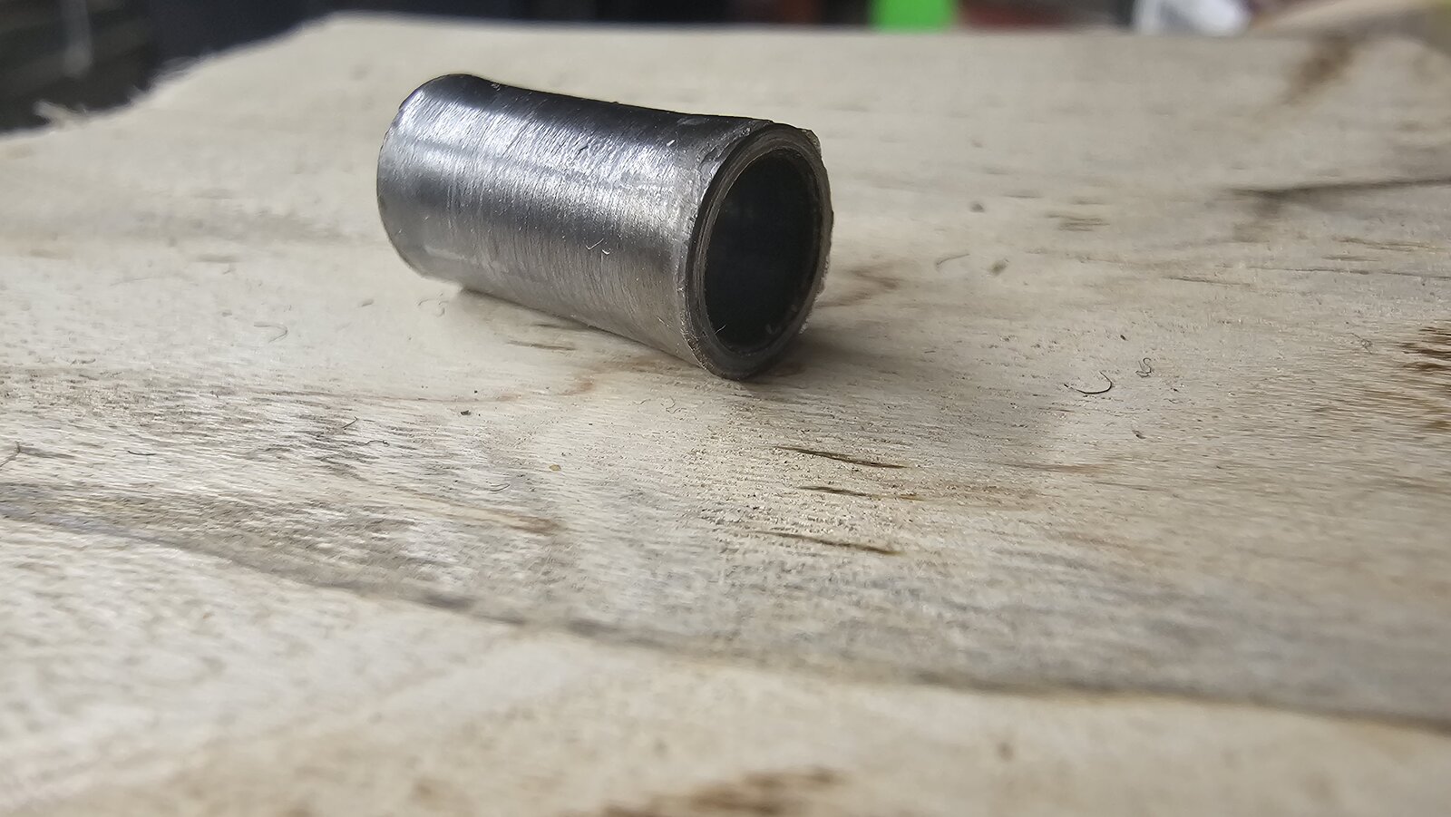

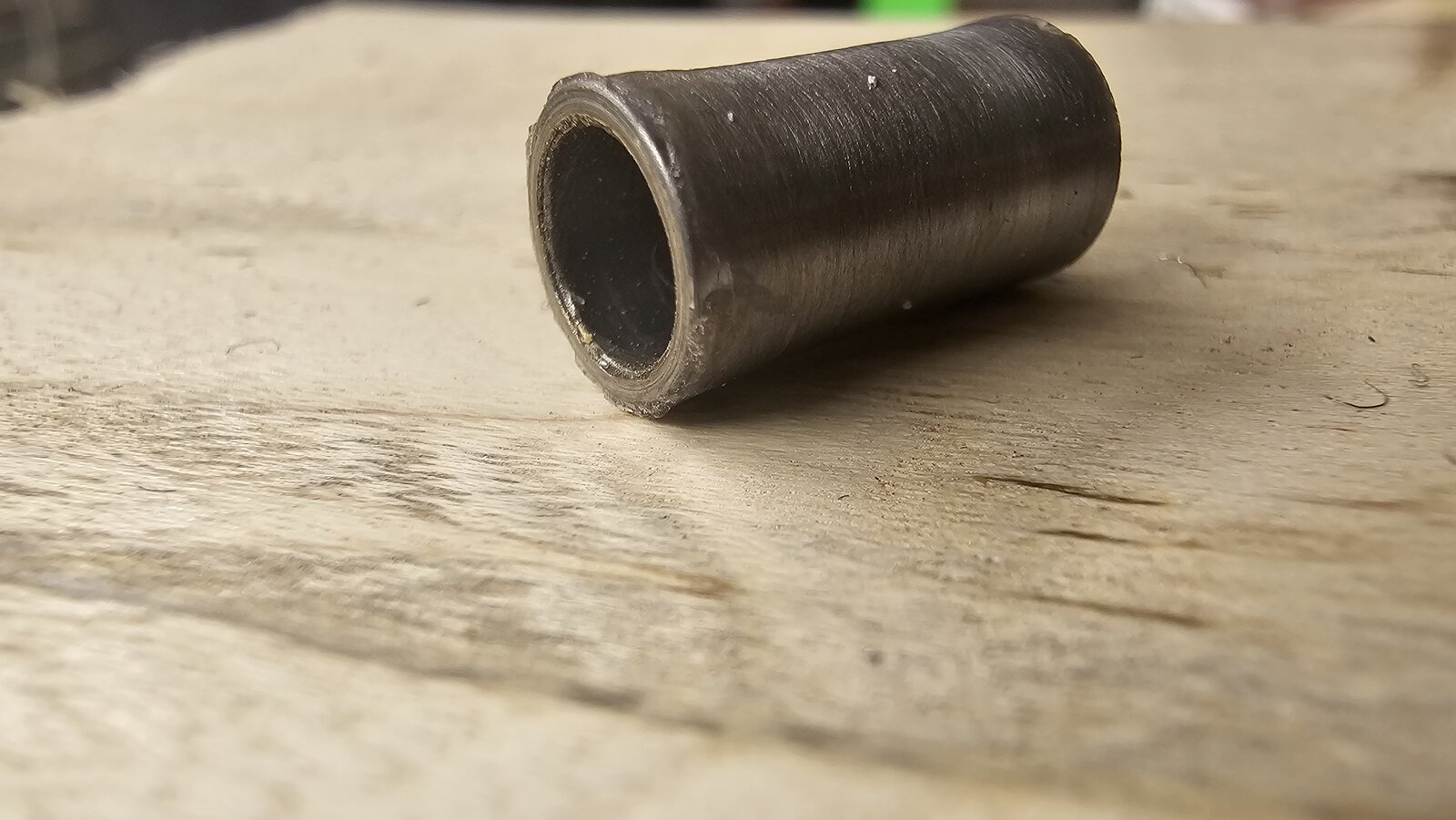

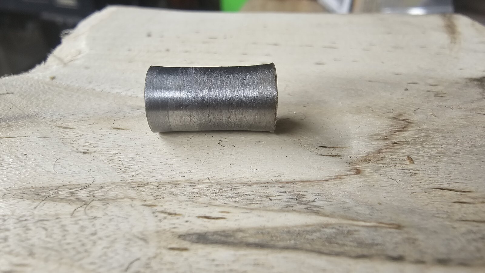

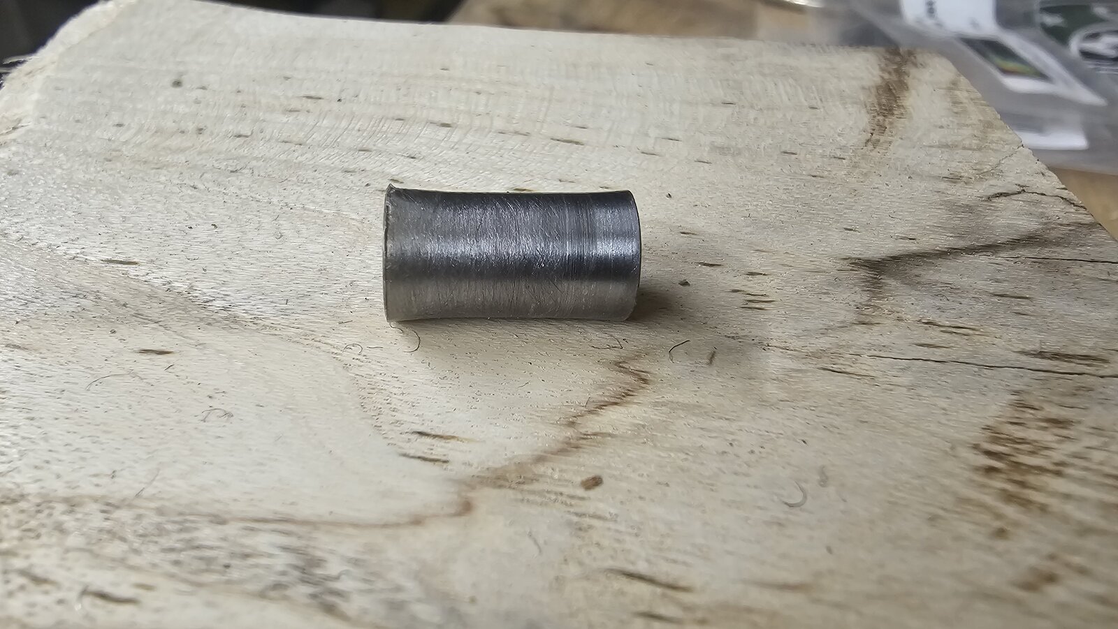

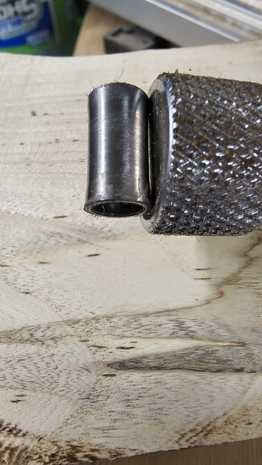

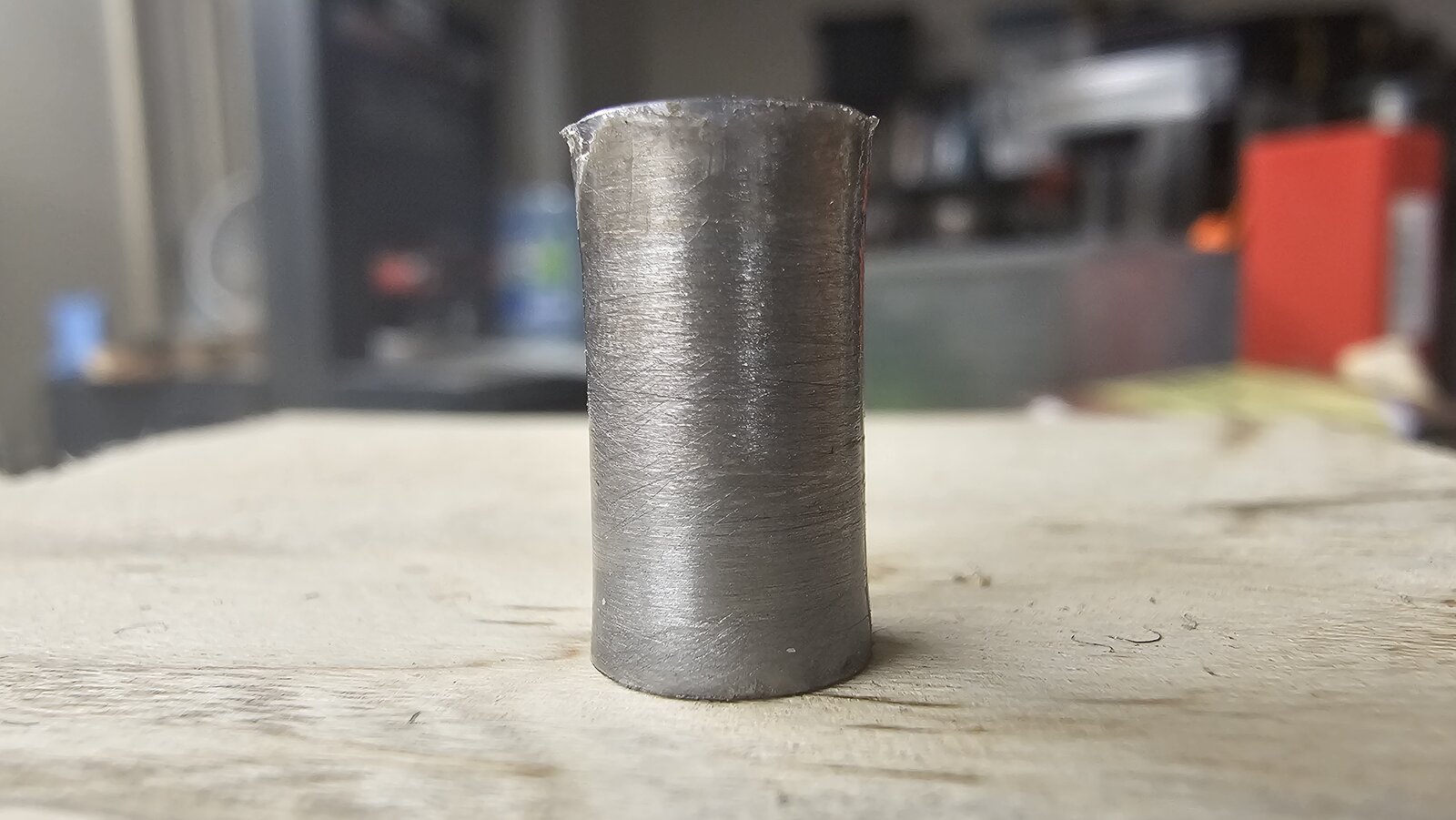

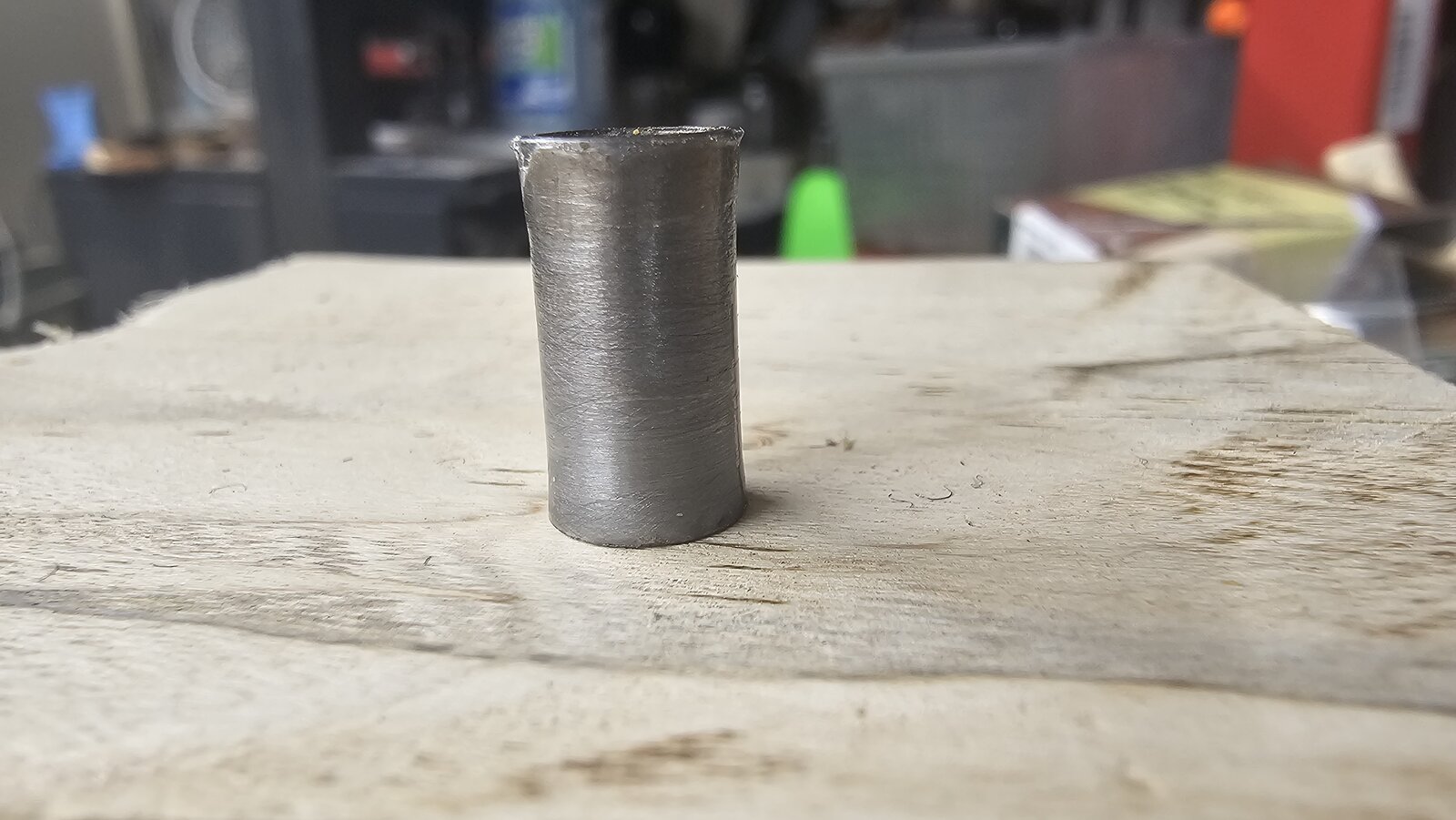

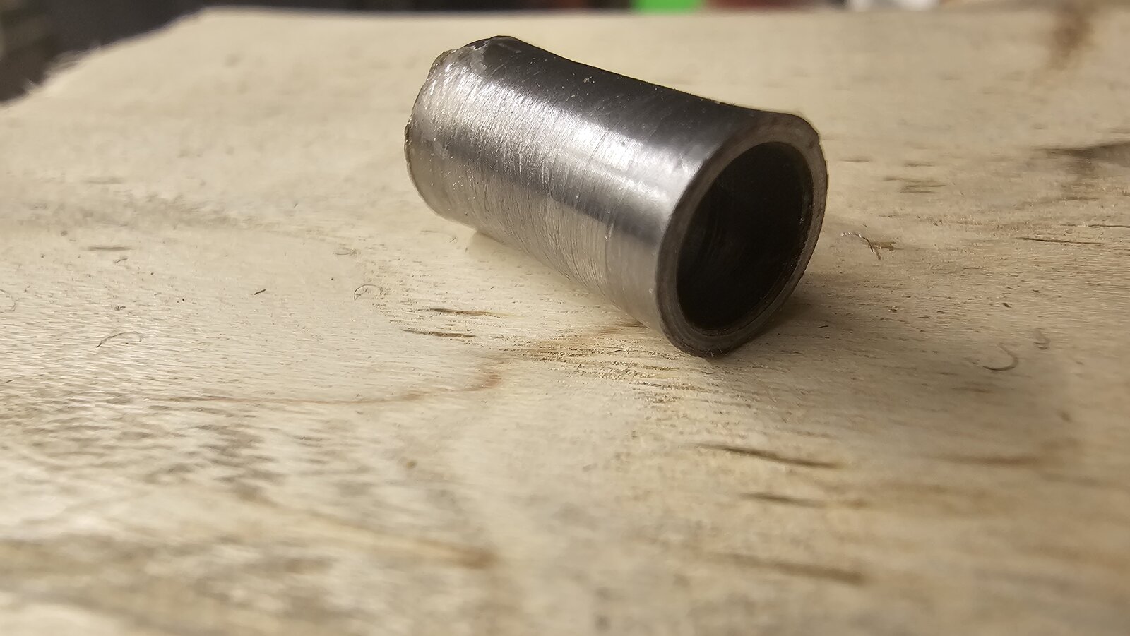

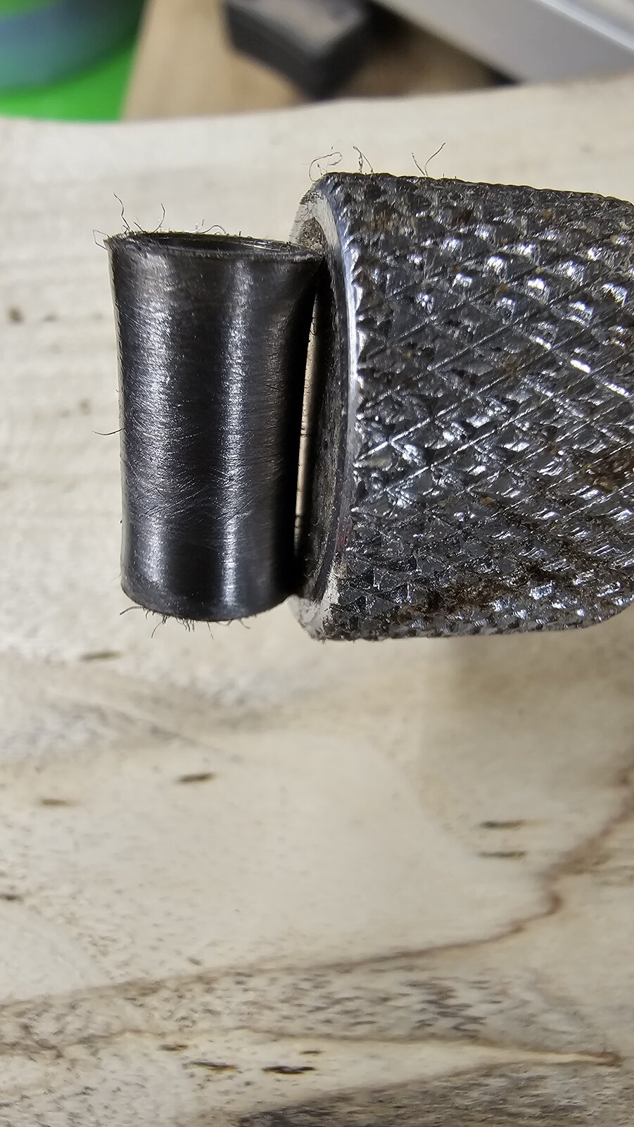

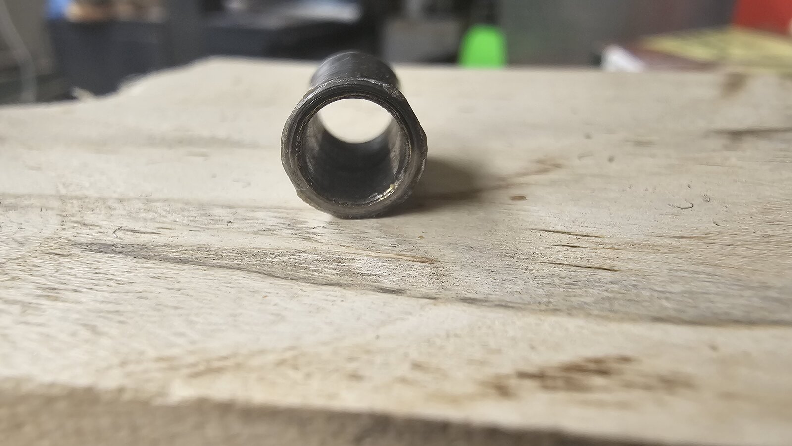

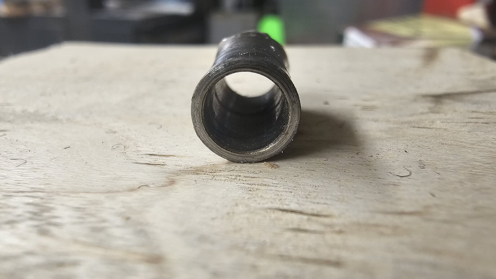

Here are several pictures of what I'm talking about.
Thanks!

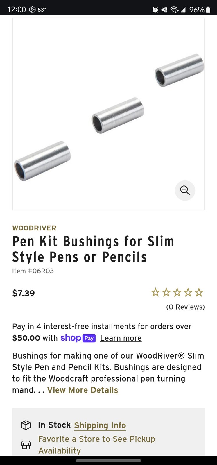

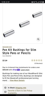

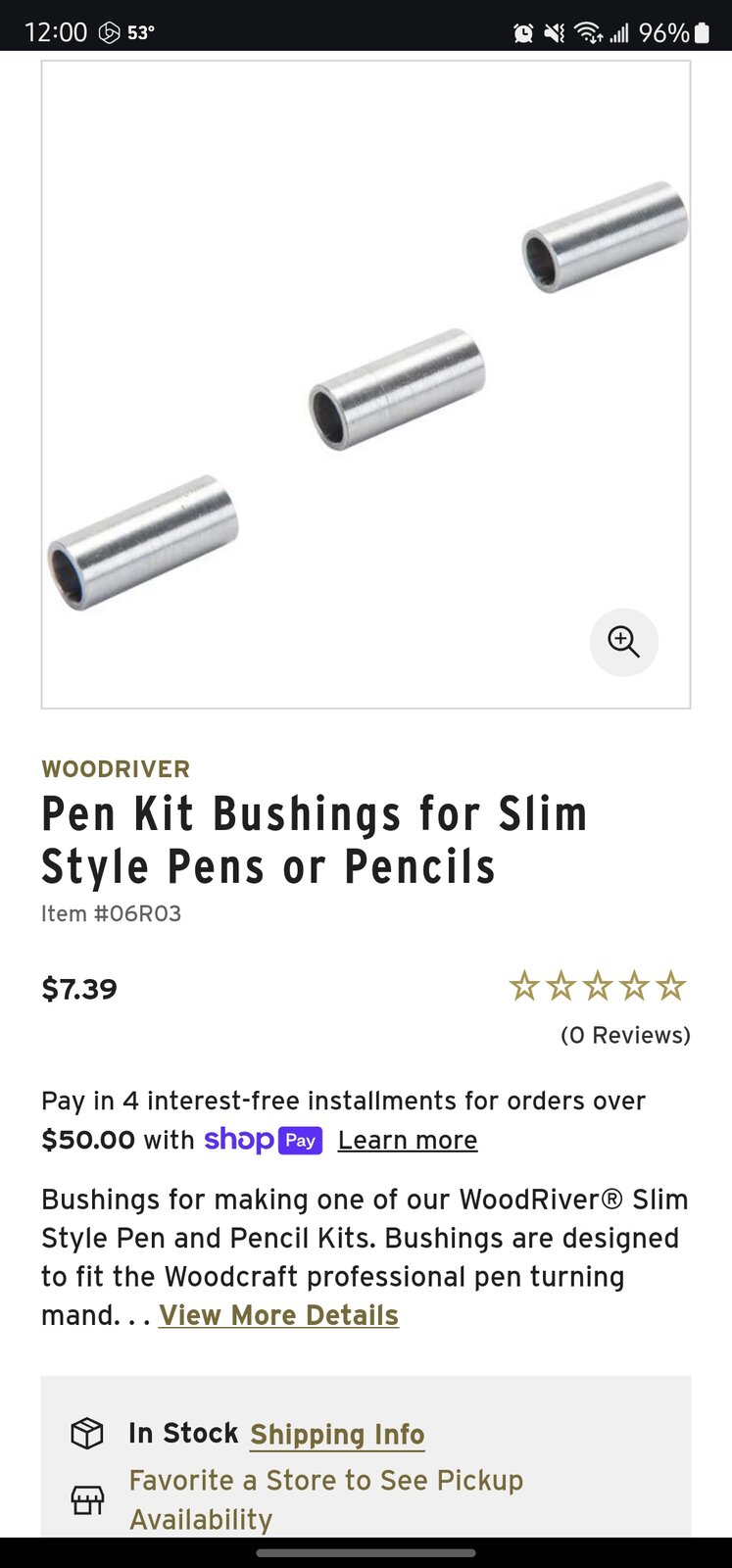

From WC, for the slimeline.

Wow, I've never seen bushings that look like this. My guess is you do a lot of sanding with these bushings on.
PenCasso
Jan 31, 2023
219
Oklahoma
I do! Is their another way to sand without them?
Everything I've read and seen, has bushings when sanding.
If I need to sand I do it with no bushings using a dead center and live center. Best method is no sanding at all, takes some experience to get to that point, but very doable. Sanding with the bushings on usually causes contamination of the blank, showing up as darker rings at the ends. Sanding also causes darker woods to bleed into lighter woods.

My goodness. Have to say I suggest as others that you change your method of turning slimline pens. That is alot of sanding of metal. My suggestion will be the same as Ken's, use a dead and live center to do final sanding after you get close to final measurements with tools. Take those bushings off.

Wow. I sand very little. I usually start with 600 followed by 800 before finishing. Occasionally I'll start with 400 but only if I have a lot of visible tool marks. Probably 10 seconds with the lathe on at 1000 RPM then with the grain with the lathe off.
My bushings get damaged/worn more from being touched by carbide scrapers than from sanding.

To me, the pictures make it look like the bushings are flared out on the ends.
If you measure with a caliper, is the inner diameter of the bushing larger at the ends than in the middle?
PenCasso
Jan 31, 2023
219
Oklahoma
Yes! So does that happen for over tightening?

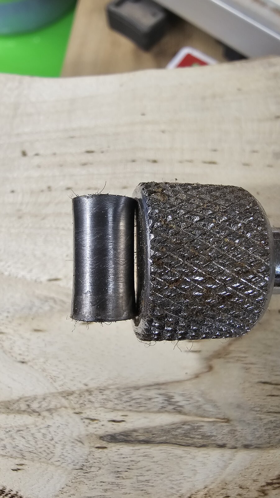

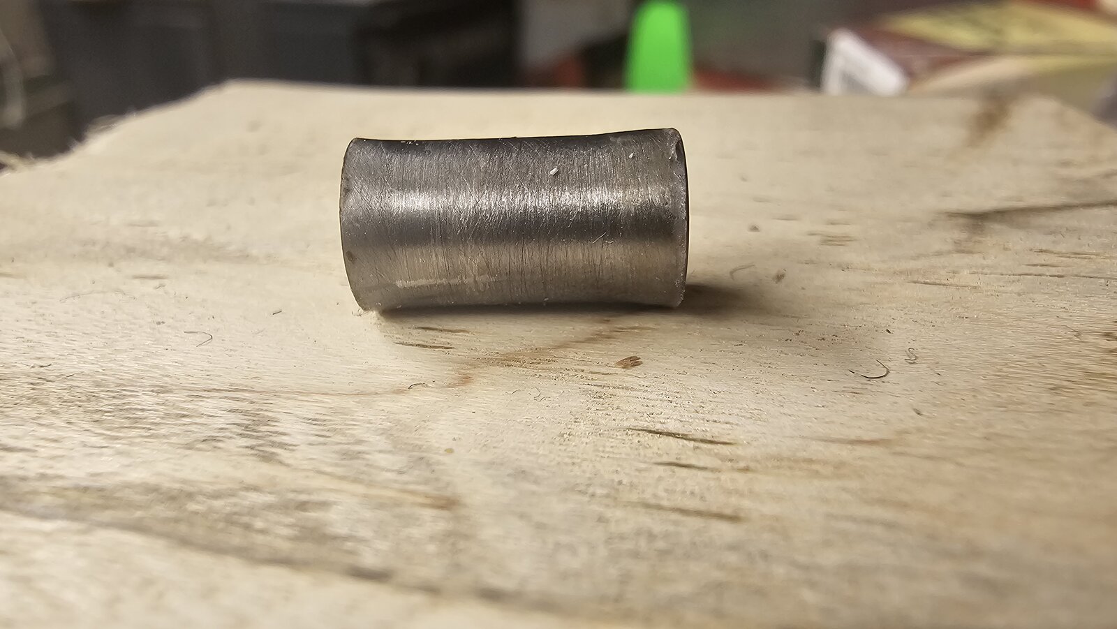

On a magnet.

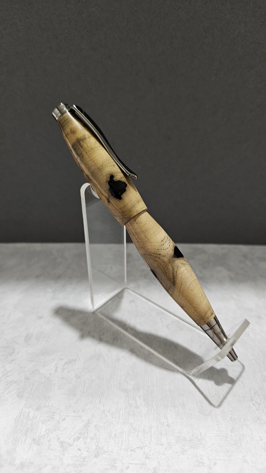

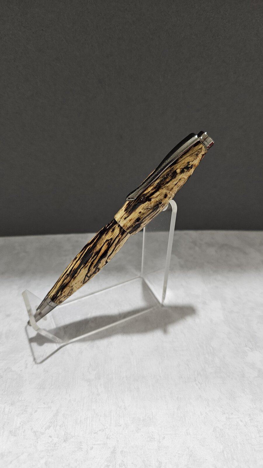

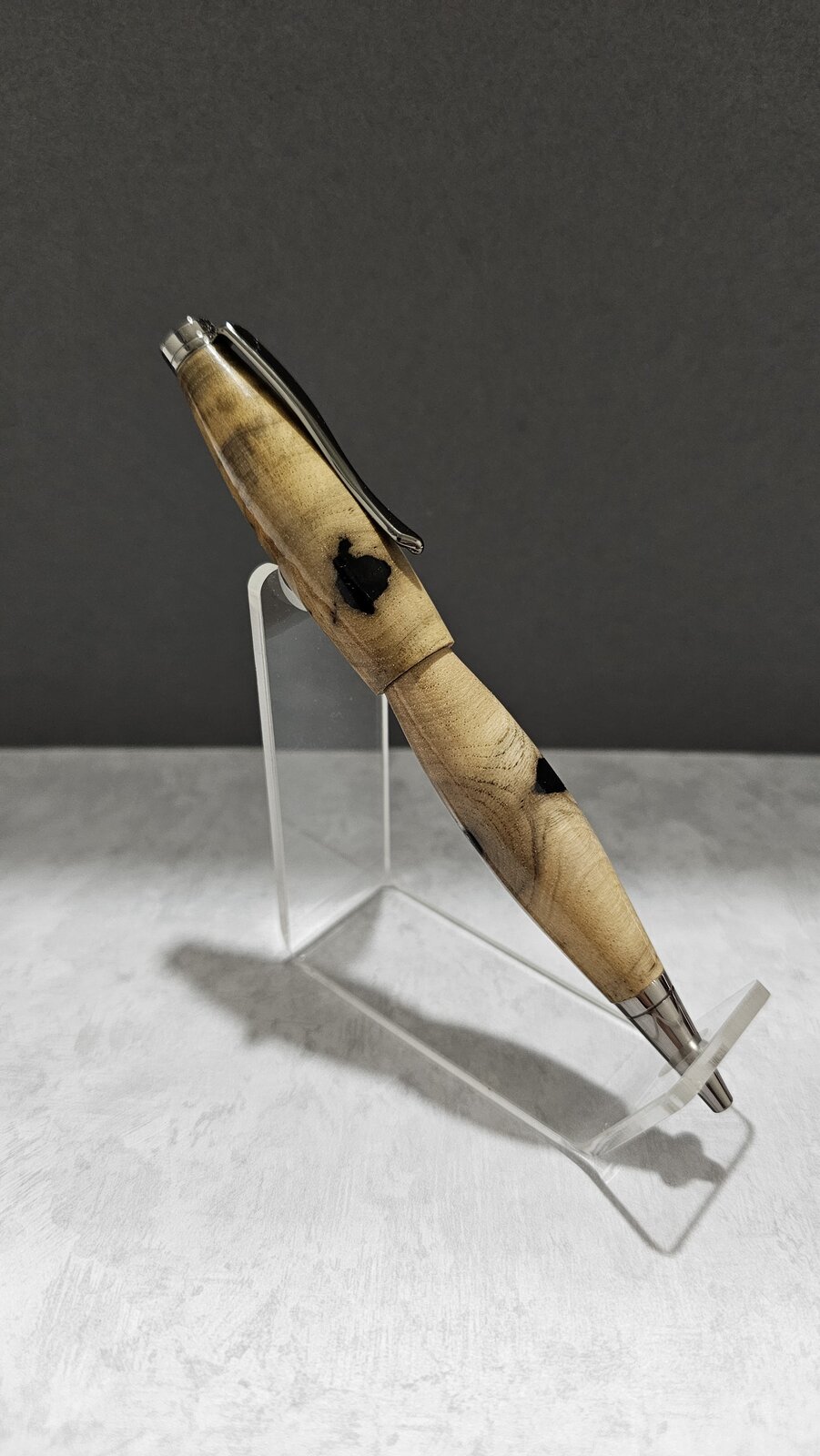

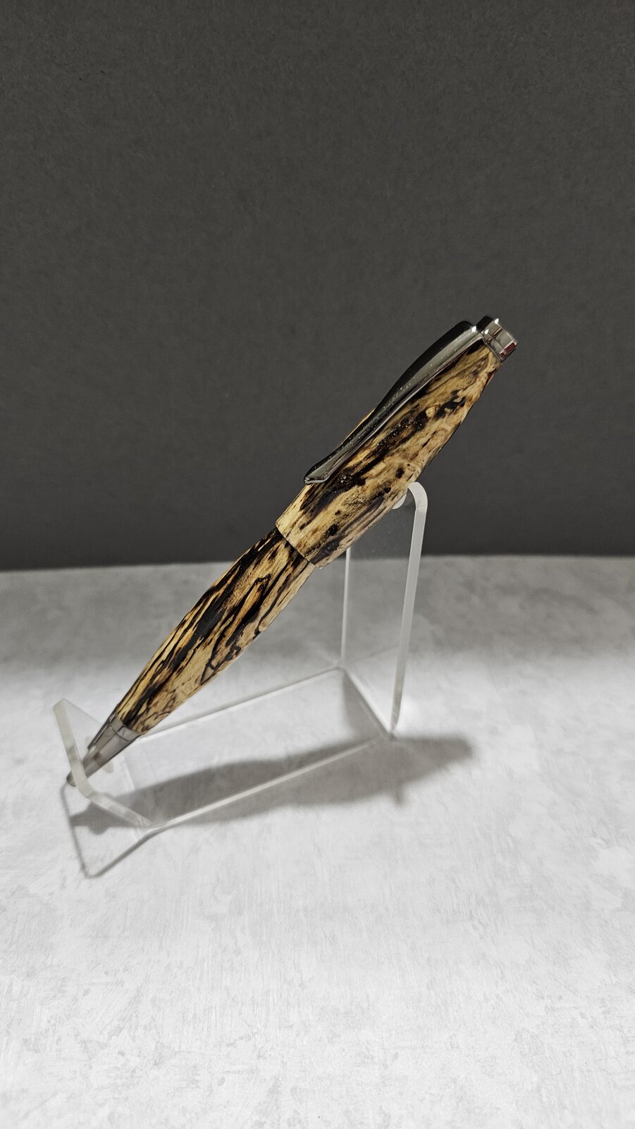

Well this what my pens look like, hopefully you can get a visual of what my tubes look like.

If you are flaring them out from overtightening, man what does your tubes look like. ?? This is not normal.
Well this may have answered my question. Im obviously over tightening, by the results of the bushings.
I tighten enough where the blank doesn't spin freely and where it gets caught while shaping the blank. Again I'm obviously over tightening pee the shape of the bushings.

If you are over tightening your biushings to an extreme, wouldn't they be bulged up in the center? I really think it is sanding issue, you can literally see the sanding marks on the bushings. I think the answer to your original question is to replace the bushings when you can no longer create a quality pen with them.
It may be both. It's possible that the over tightening is causing the ends to flare - though I would think that more likely with a mandrel saver than a nut.
But the sanding marks are pretty clear too - though I would imagine that sanding would start at the edges due to the slide from blank to bushing.
I guess I'm saying that I got nuthin'. The puzzle is interesting though.

The center of your bushings are a smaller diameter than the ends, correct? If so, then you've sanded or touched them with your tools enough to shave them down. Smaller in the center would be from stretching, not compression.
If it were possible for you to overtighten the blank and bushings enough to change the diameter of the bushings it would most likely mean the compression would break your blanks all time too. The brass and wood/resin will give way before the steel in a bushing.
Either way, your original question about replacing the bushings still stands. Yes, replace them.

Are you keeping your bushings on while using CA? If so, that's CA buildup. Soak them in acetone and scrape the ends with a hobby knife if that's the case. I had a couple like that before I discovered the CA bushings.
You have to be really aggressive to sand metal enough to change the shape with the higher grits you should be using.
