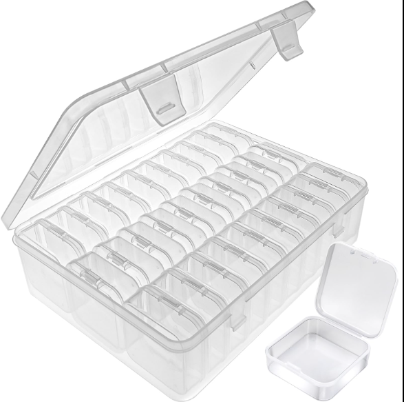

I use the Harbor Fright (I know, there's a missing e;)) small storage boxes with even smaller boxes inside ==> https://www.harborfreight.com/24-container-storage-box-90243.html?_br_psugg_q=storage+container. Each box holds 25 bushing sets. I use a label maker to affix the name of the kit(s) the bushings fit and organize them alphabetically in the box(es). So far I have six boxes full 🙄 with several more set in plastic bags awaiting a trip to HF. What I really need to do is reduce the number of kits I am willing to make to a precious few and offload all the spare bushings and kits. Film at 11.

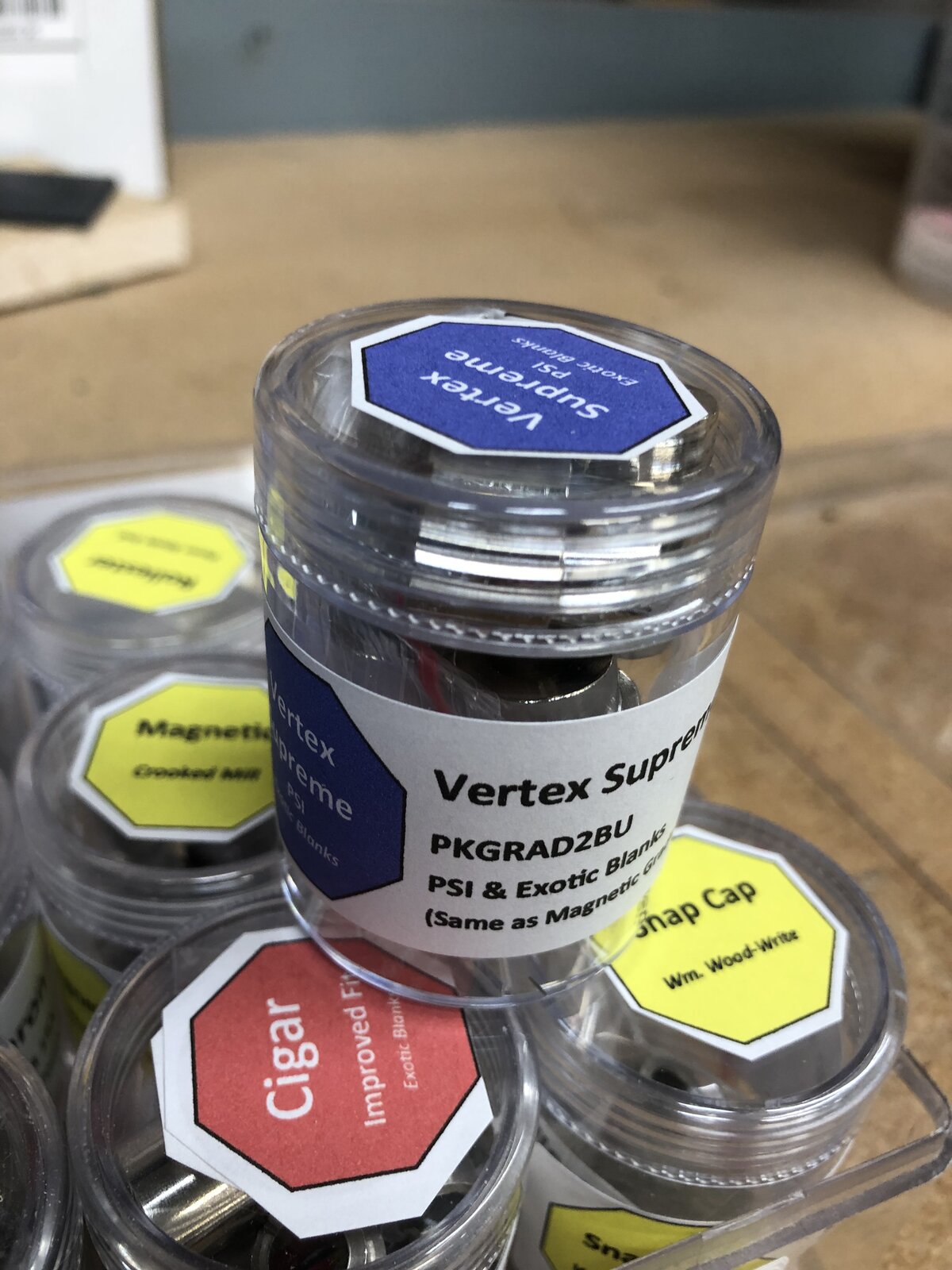

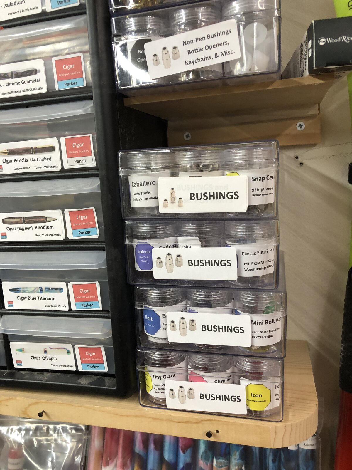

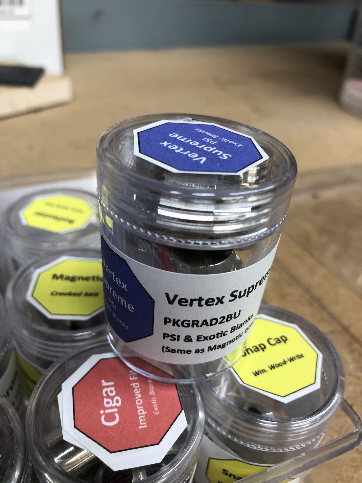

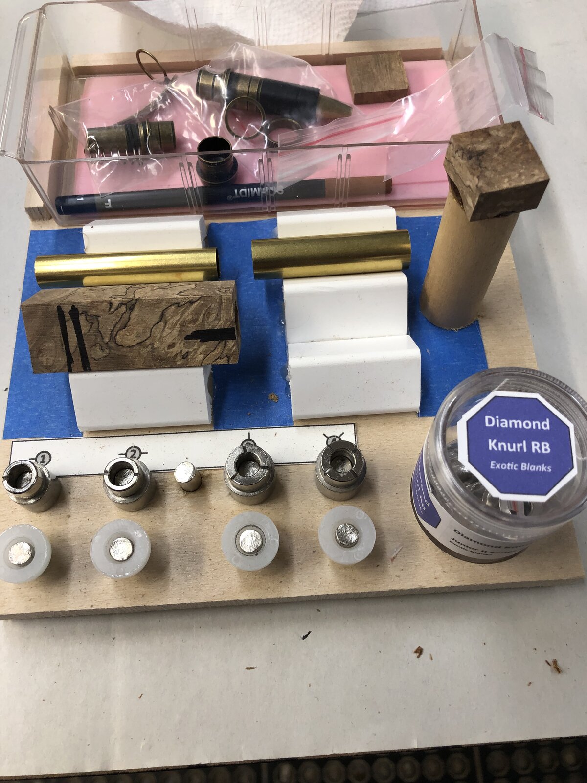

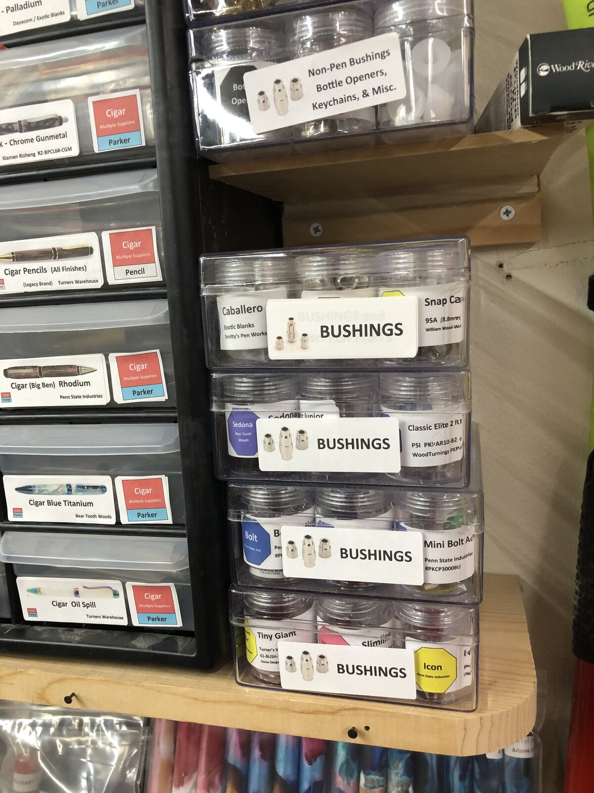

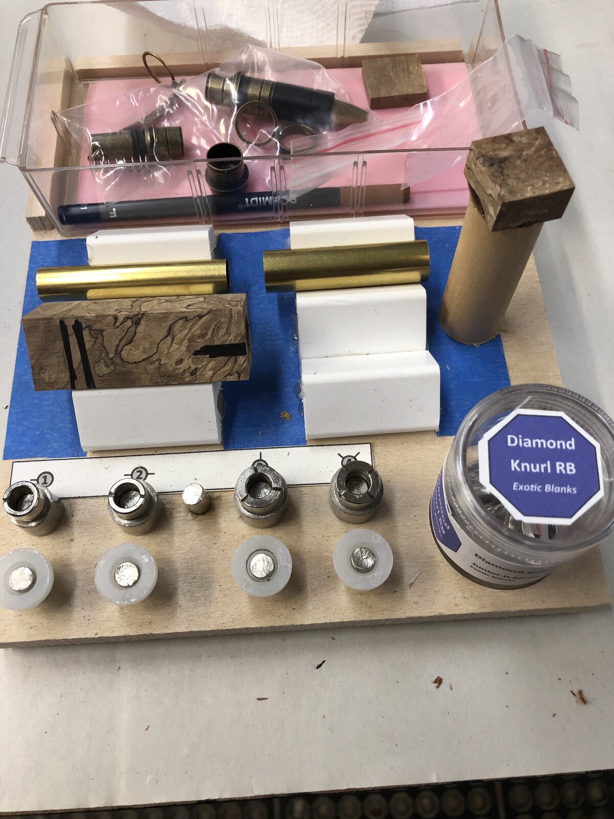

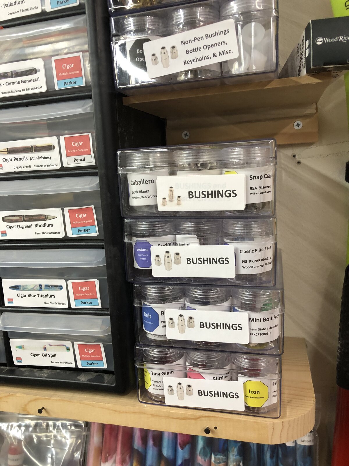

I store my bushings inside little plastic jars that fit neatly inside plastic boxes. The jars are 1.5 inches in diameter and are 2 inches tall. The box is 6.50 x 5.00 x 2.25 Inches and holds 12 jars. They were relatively inexpensive at only $6 per box from our local Walmart store. I found them in the arts & crafts / bead storage area of the store.
I keep a new, unused, set in the bottom of each bottle along with a set that gets used. The new set is used both as a reference for measuring as well as for a backup set when I decide the "work in process" set has worn down and needs to be replaced.
As you can see from the photos, I also color code my pen kit storage based on the type of kit it is, Parker Twist, Rollerball, Cross, Themed, Sierra, etc. It really helps to find the bushings for a particular kit rather quickly. It also helps that I keep the most frequently used bushings in the top box. I carry the color coding scheme through to the labels on my kit storage drawers and the 3-ring binder I use to organize the kit instructions and my notes.

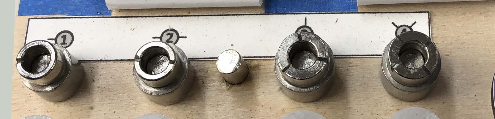

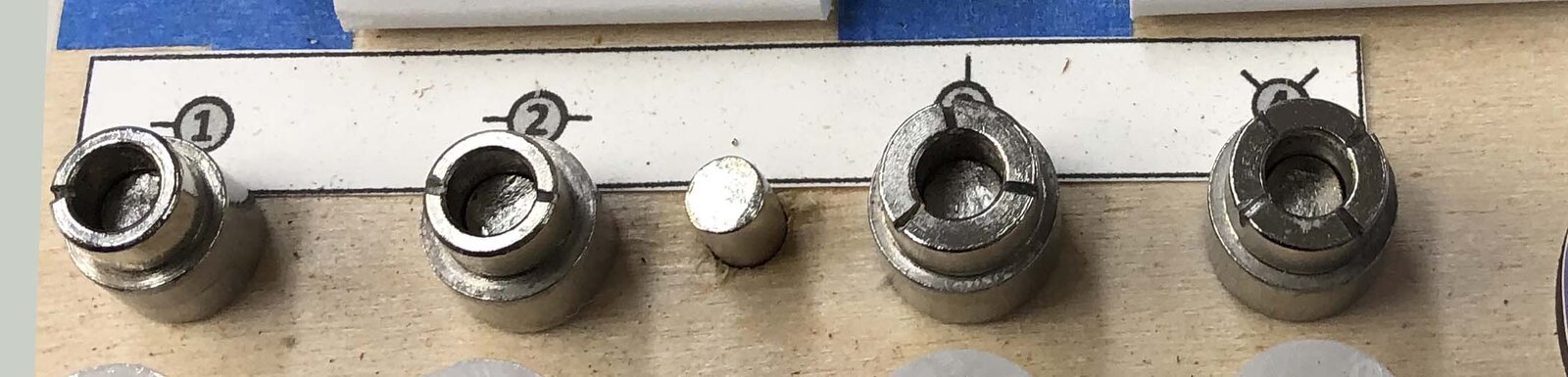

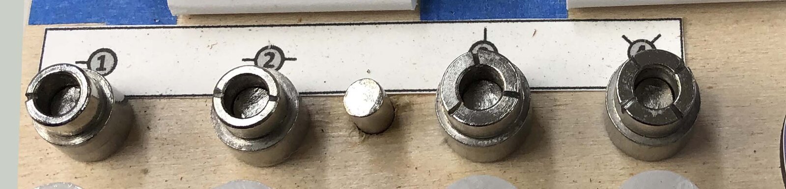

In addition, I make small nicks in the bottom (the end that goes into the tube) of the bushings according to their order of use. In my scheme, the #1 bushing is for the tip/nib with the highest number (usually #4) for the cap/finial/cabochon end.
I took a few pictures to help give you an idea of what I am talking about. (Click on them to Zoom-In)
I second this idea. Perfect sized boxes for bushings and you don't run the risk of mixing all of your bushings up if you accidentally knock the container over

Three 👍 Up. I also use this method. Takes up no wall space, each small box is labeled, infinitely expandable. I only have two boxes full, which makes me a rank amateur, but my collection is growing. I have made an index for each box in an Excel spreadsheet, and when printed, each page folded in half fits perfectly in the top of the box so I can see what is in each one before grabbing it.

Greetings from Nebraska.
Dave
View attachment 367490 View attachment 367489 View attachment 367492
great idea with the notching. thanks

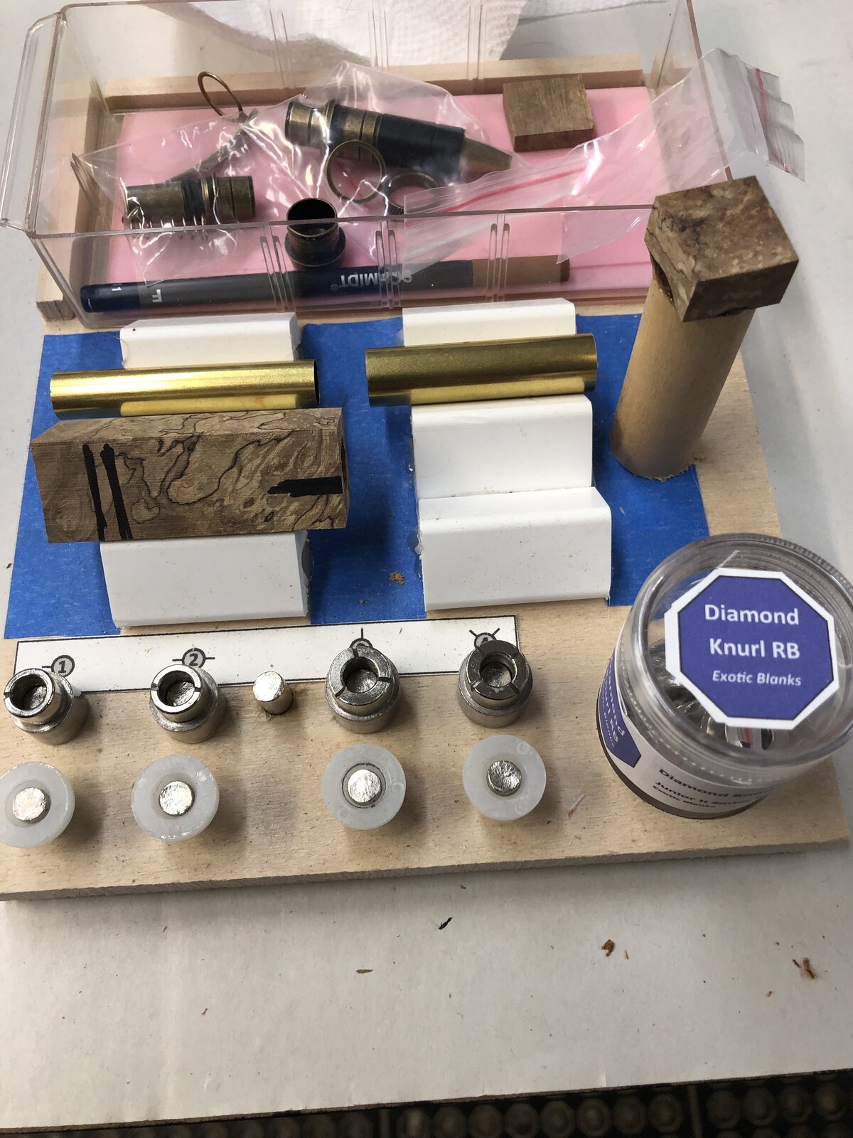

Dave, The notch/nick idea is absolutely brilliant. I will be copying this as well as studded bushing holder for WIP.
egnald
Jun 9, 2017
3,195
Columbus, Nebraska, USA
I used a thin Dremel metal cutting wheel to make the little slots.
The studs in my WIP holder are 1/4" x 7/8" Nickel Shelf Pins that I bought in our local Menards store ($3 for a bag of 12). I had to sand a bur off the end of a couple of them to get them to fit. I think they might have been slightly deformed on the end when they were sheared off at the factory. They work great for holding the HDPE cone shaped finishing bushings that I use too.
- Dave

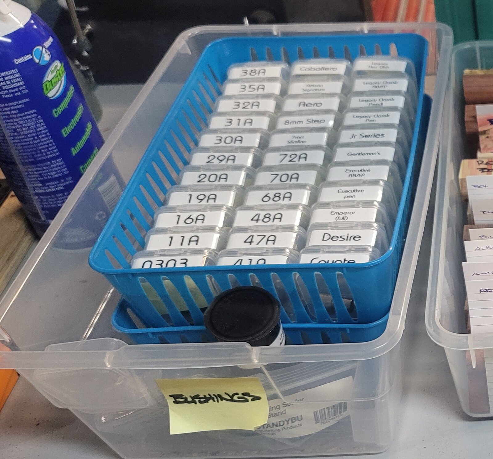

Here's another idea for you. These come in various sizes. https://www.amazon.com/dp/B0CL4CJ2SN/
I use these small boxes, 1.7x1.7x0.8, labeled and alphabetized in a shoebox-size bin.
Perfect size for most bushings without wasted space (I tried the Bushing Buddy but that used 10x the space per set). The small blue trays from Dollar Tree are the exact right size to fit 3 rows of 11, edge up, and two trays stack in the bin.
