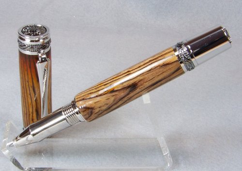

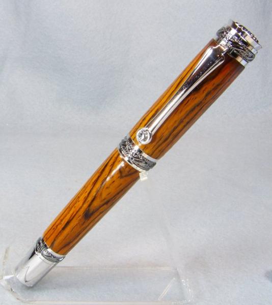

Hello Everyone,
Last week I made a Cocobolo Majestic and wasn't happy with the way the wood came out. I was going to take it apart but was advised by most of the people who responded to the thread to leave it alone and it would darken in due time. I let it set for the last week or so by a window, turning it every so often and it did darken quite a bit. I would like to thank everyone who suggested I slow down and not rip it apart right away. It looks much better now and I didn't have to struggle to find a way to remove the parts without destroying the kit. Thanks again everyone.:)
Before:
After:

Lookin' Good!
See, it pays NOT to listen to me. :)

Yep... it is sensitive to both light and to air. You get the nice oxidation as you let the wood be exposed to air. So next time you turn coco some let the blank sit for a few days before you apply finish to it. You might see some big changes due to oxidation.
