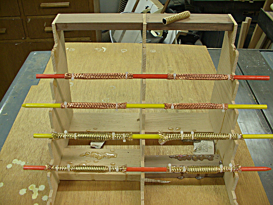

Not sure if this is relevant but talking fiberglass rods, you can go to Home Depot or Lowes and get their property marker rods that come in various lengths and colors. I happen to use them in my casting arena. here is a photo of them in use. Have to warn you though, fiberglass is nothing to take lightly using and fracturing. Those splinters will cut you to pieces. I know when I clean my casting rods I have to be careful not to trim them to the point they have shards on them. When I use for casting I always coat them with a wax before use so my tubes slide off easier. The bond from the resin breaks off easier too. I would avoid fiberglass for something that can get banged up and splintered. Just my opinion.
Now with that said I would opt for acrylic rods and you can get them in a ton of colors and both opaque and transparent and with fancy glitter in them. Any acrylic vendor should carry them. There is a vendor list in library with all kinds of materials we use. Or at least I think it made the library. I know it was being worked on.https://www.amazon.com/Different-Di...49-b176-14f98947aaa2&pd_rd_i=B07J4BZ1QY&psc=1 Plus you can turn them down to a shape you want.
