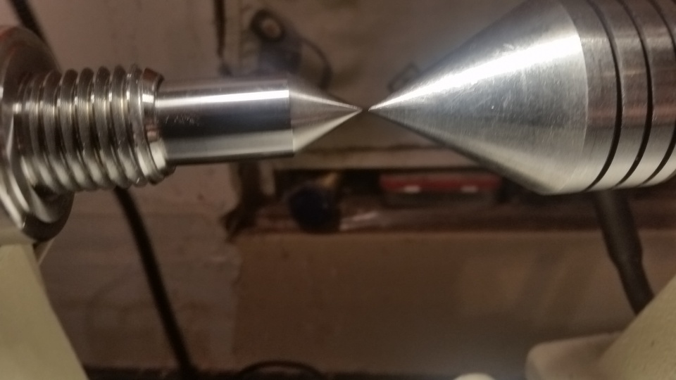

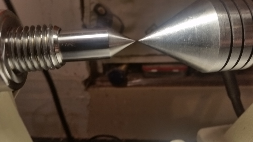

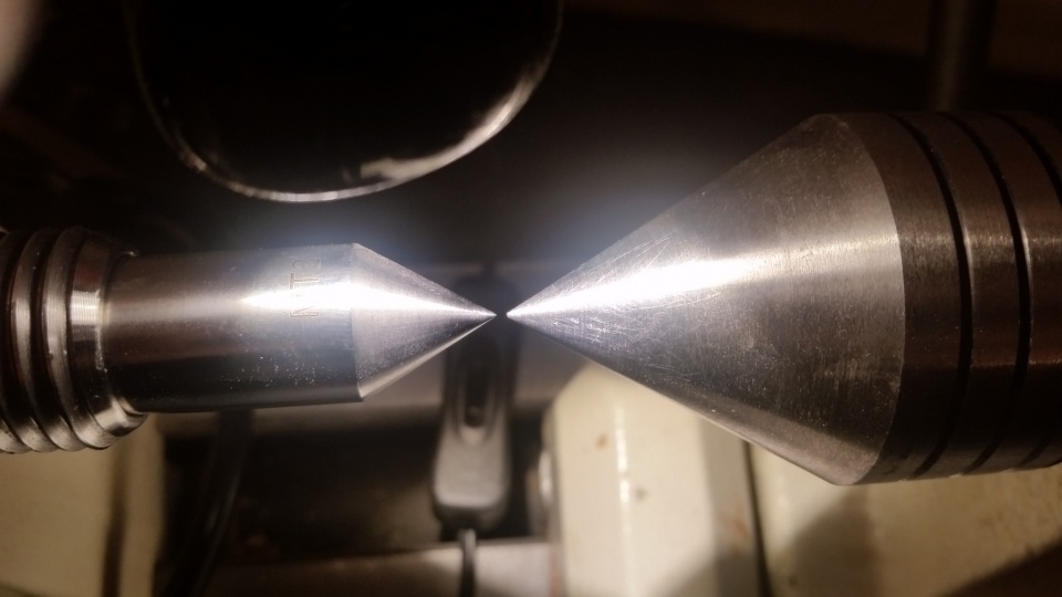

when I hit the pen blank, it was between centers a dead center and a live center. I have left the live center and the dead center in so that you can see how much the headstock wobbles. you can also hear the weird sound it is making and see even right above the threads where it goes into the front of the headstock that it is not aligned or spinning on center.
Bend in headstock or just bearings?: https://youtu.be/REEarGE6wv4

Difficult to see what is up even with the video. I have called powermatic which is also jet with some issues with my lathe. They were most helpful? Most likely when they see your nice video they will tell you what is wrong how to fix it and what the parts will cost. Let us know how it all comes out.

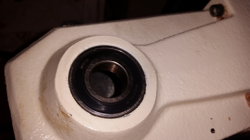

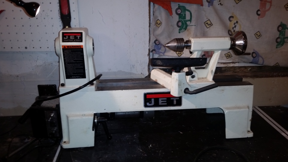

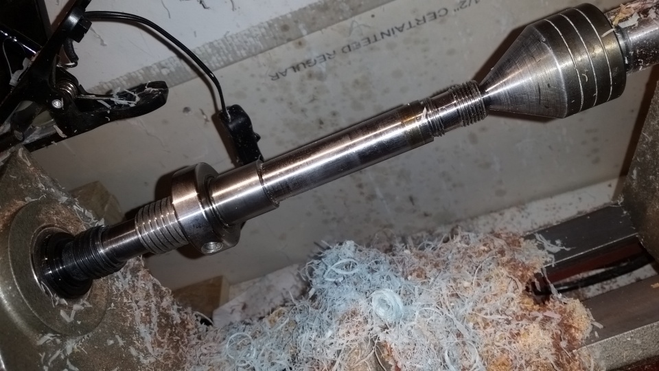

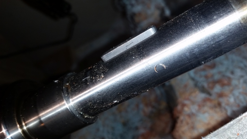

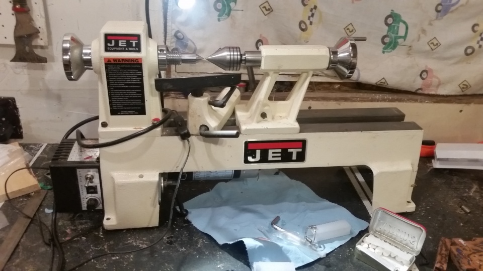

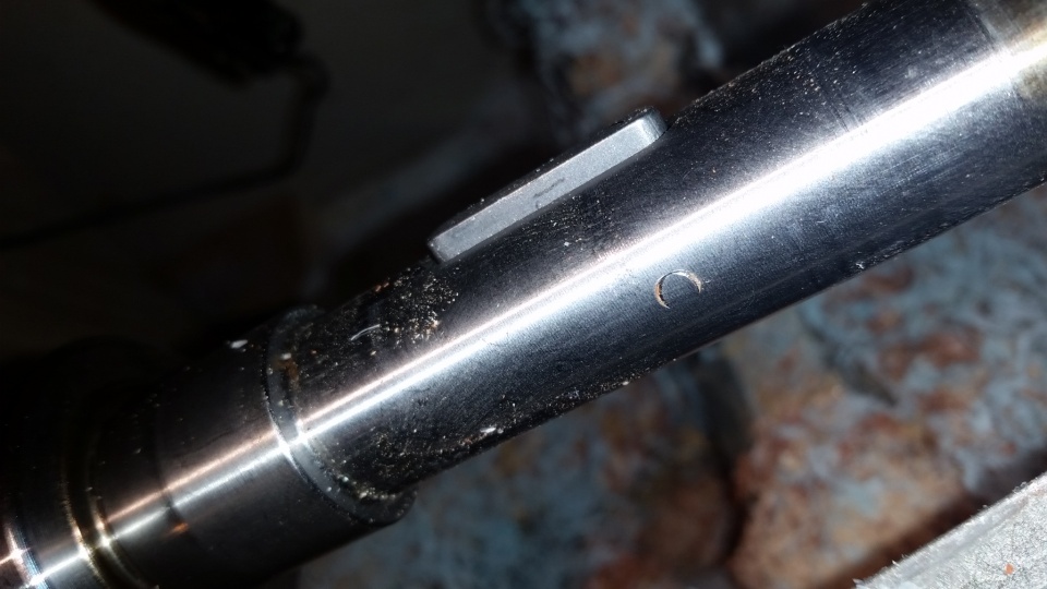

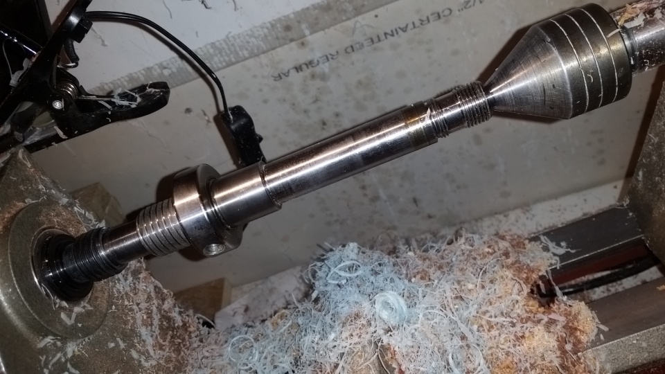

I finally got to taking the headstock apart. I put the spindle between centers on my Nova comet II. You can't see it in the pictures but the spindle is definitely bent.
it sounded like from reading other internet posts that I should replace the bearings while I'm at it. Is Jet the only place to get the spindle?

If you cannot get the spindle replaced, a machine shop may be able to "straighten" the spindle. Any place that sells bearings should have these on hand or be able to order them in a few days. Look for belt / industrial suppliers. An electric motor shop should be able to tell you where they get bearings locally.

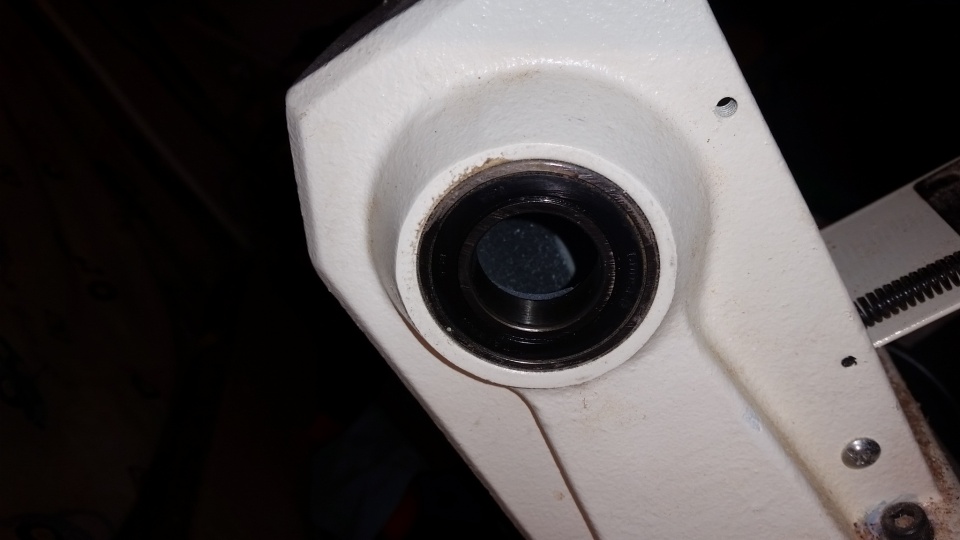

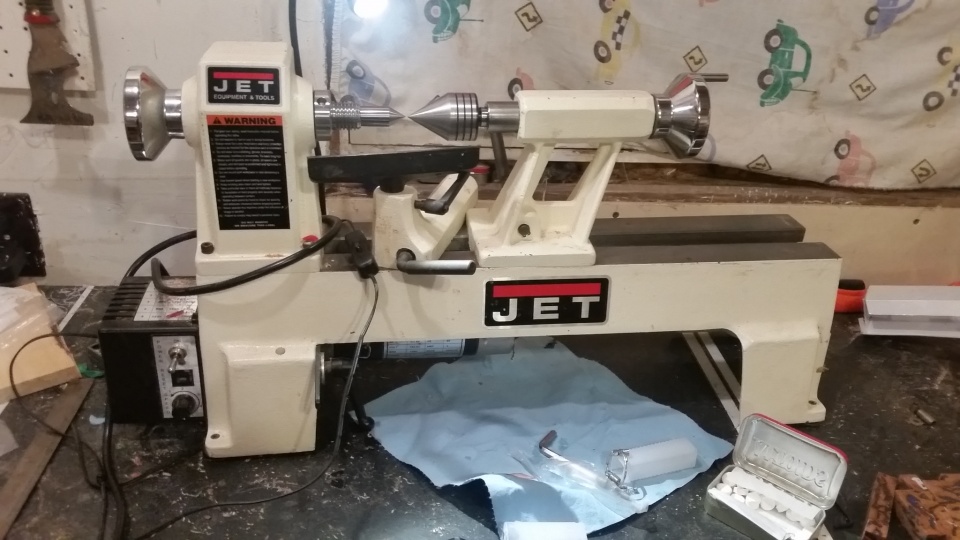

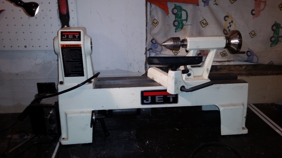

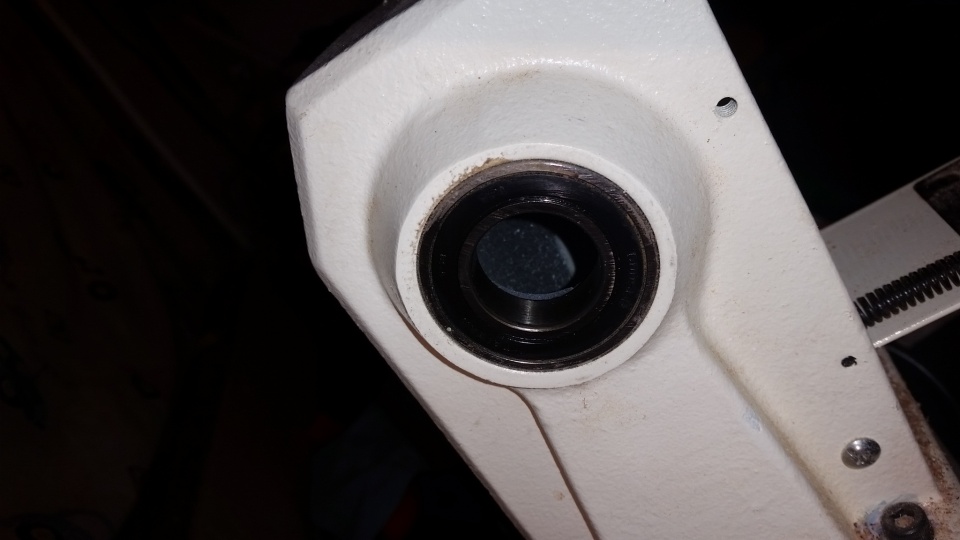

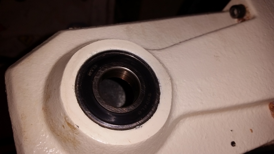

I ordered all the parts from ereplacementparts.com.
yes the bearings we're 25-34 each but I don't have time to run to stores trying to find the exact bearings.
I think my old bearings were fine but put new ones on and a brand new dead and live center to check the alignment.
Do new bearings need to break in? I did notice that the spindle stops almost instantly when the motor turns off. Compared to my Nova and my old jet minis the spindle spins less free, even when spun by hand. Havnt turned anything on it yet.
Is there a way to know if the old bearings are bad or still good?
