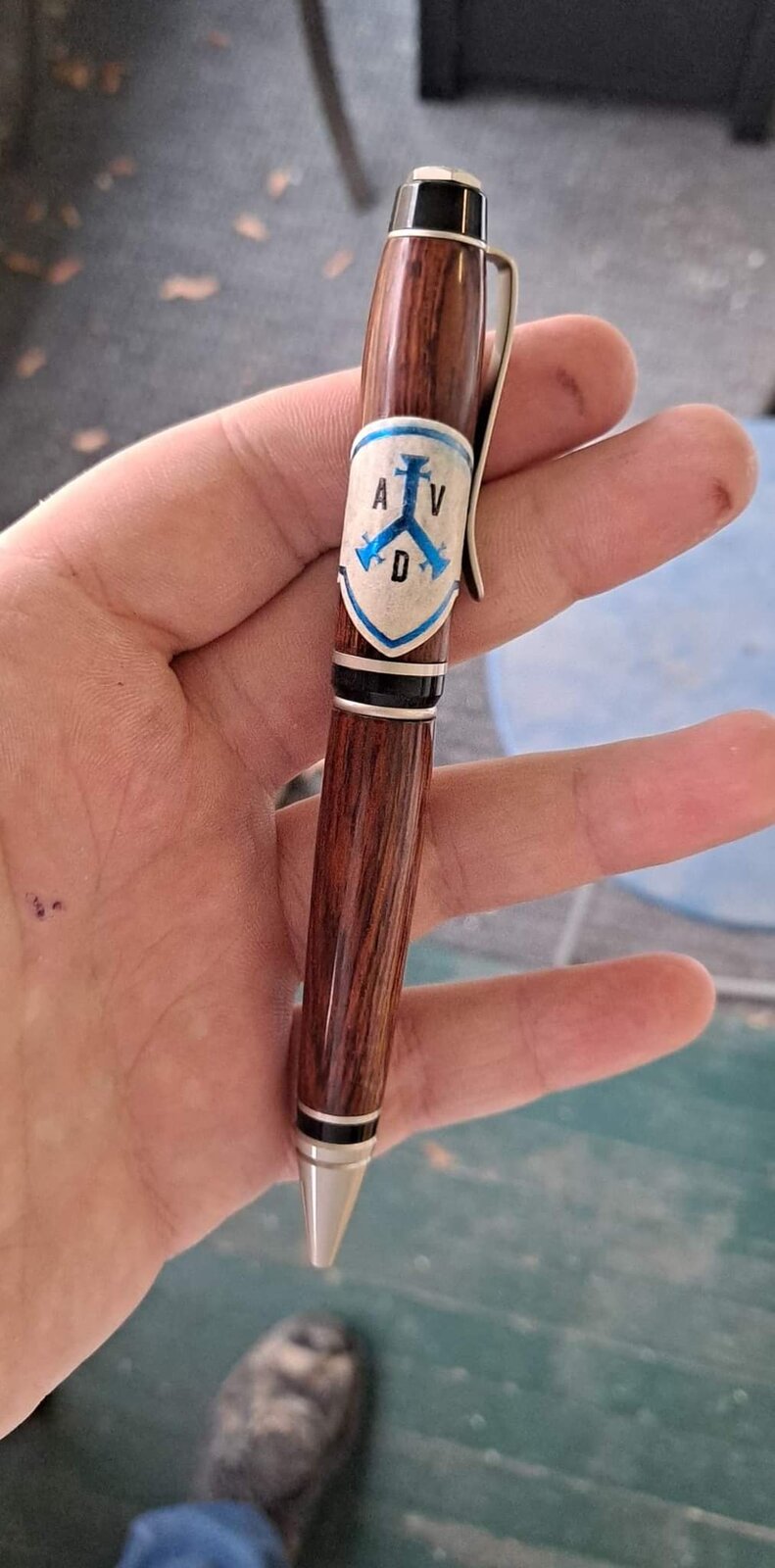

Having fought this before, I can say that CA WILL cause your ink to run. I finished the wood, then glued the band to it, then sealed the band with tiny dabs of thin CA so it minimized the colors running.
I would suggest not being me and seal the band with the mod podge stuff, then build up a couple layers of CA over that.

Here's the one I did. You can see some of the smudging of color. It was the third band before getting to the "screw this, I don't care anymore" point lol
