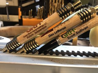

Need some suggestions for kits with some meat on them. I am doing more engraved pens and need some kits that when turned have at least 2mm of wood left on the tube. I did a Faith/Hope/Love kit the other day and noticed that there was a lot of wood left on the tube. That pen is made on an 8mm tube but with the thickness of the wood left on the tube it made for a nice sized finished barrel.

I'm not a fan of "fat/bulging" looking pens. When I say "meat" I mean how thick the wood is on the end of the tube where it meets the bushings. This pen had a thicker wood between the tube and the width of the bushings. In order to get a deep enough engraving to fill with whatever material you choose it seems that you need at least 1.5mm in order to fill it and be able to sand it down so there is enough filler in the engraving when sanded/turned down to final size. I'm buying a more powerful laser and better jig so as to get a deeper engraving. With some kits there is very little thickness left. I like and have made the EDC and pens like the Gold Warrior. When doing names and logos on pens my preference is a single tube vs a 2 piece otherwise you sometimes have to squeeze the engraving into one half or the other.
I also just got a 60 deg dead center to start turning between centers as I understand the wood stays truer to the tube and has fewer low spots.

Your pens, that you have shown above, look very nice indeed. . Thank you for showing !!!

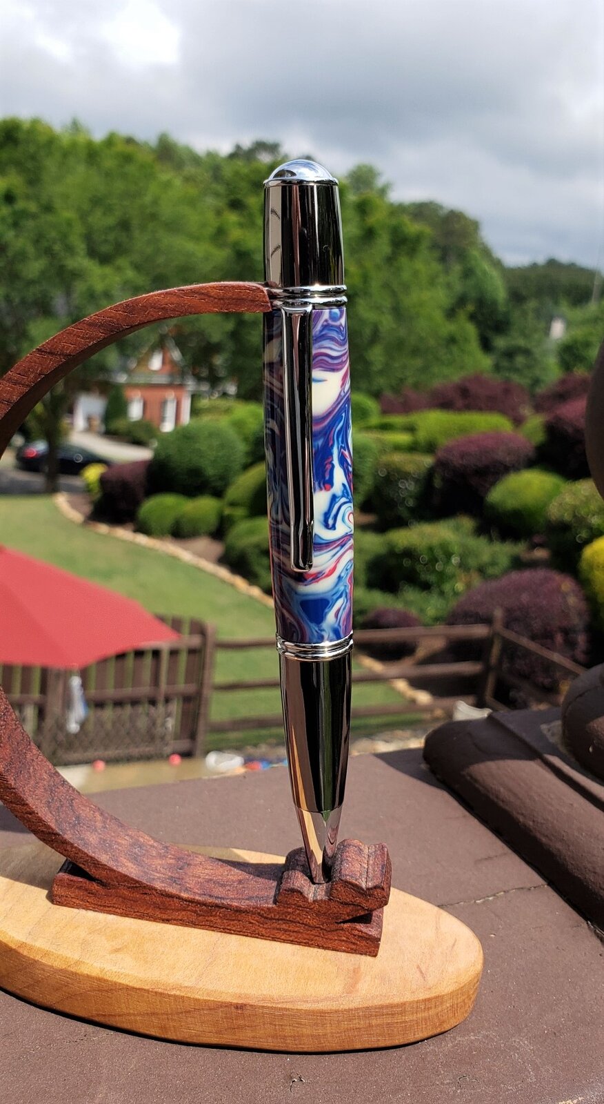

TonyL
Mar 9, 2014
8,919
Georgia
  • Datacom Professor/Exemplar
  • Dayacom Aero
  • Dayacom Patriot
  • Gatsby Grande (has a 3/8th tube, not 27/64)
  • GT Knurl
  • Cigar pens
  • The ones that Mal identified
Here's the Gatsby Grande
