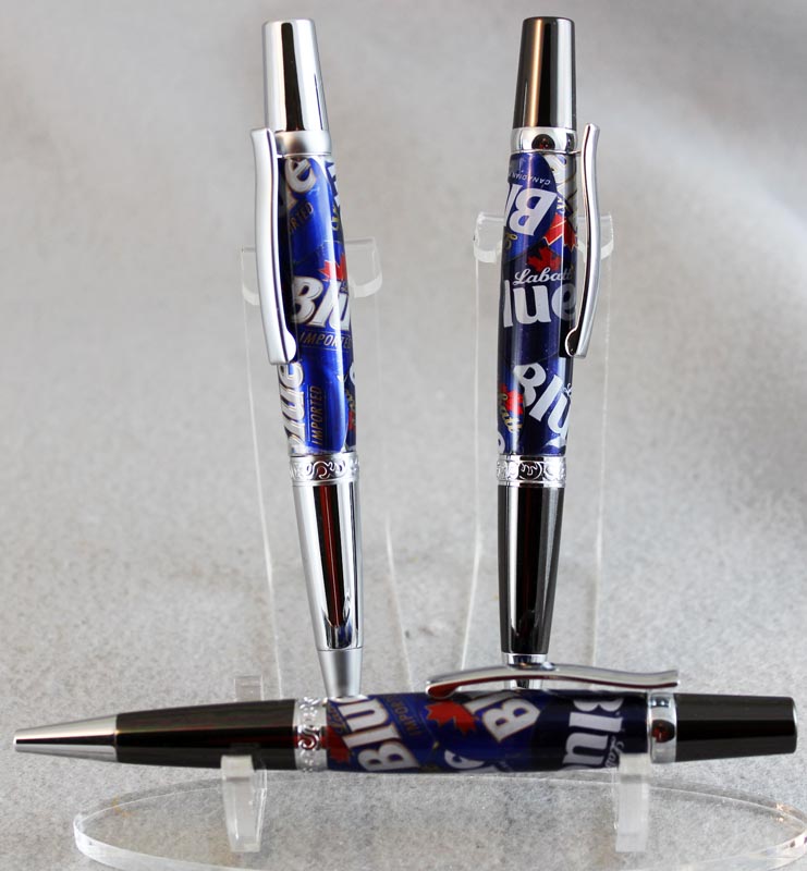

These were a special order for a customer whose husband enjoys Labatt's Blue.
They were made with the caps cast in PR resin.
Any questions or suggestions are welcome.
Mike

Those are pretty cool, would,be interested in the process of prepping the caps and pitting in blank

Thanks for the compliments.
First I cut the crimping off . Then I scrape and sand the seal off.
Next I find a transfer punch a little smaller than the tube and wrap the caps around it.
Slide the caps on to the tube and a few few drops of CA to hold them in place
I then cast with PR resin.
Mike

That is awesome, they really look cool. I will have to buy some beer in bottles!
