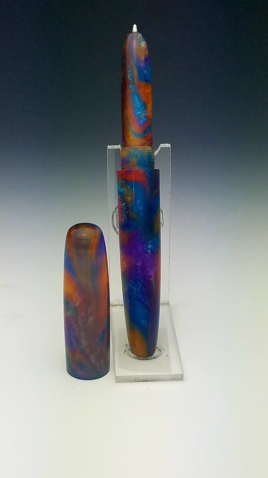

I have been threatening do to this for a while. Just like the first kit pen I made, there are things I would change, and it took too long.
Thanks for looking, advice and "heplful" comments always welcome.
Jason

Thanks Mal. I'll try a rollerball next.
The ballpoint is actually harder than the rollerball, in my opinion.
That's because you have to take into account the range of movement of the refill and the right room for spring compression.
(Of course, in the style of ballpoint you have done, you have left out the movement of the refill, so it's easier ..... THIS time. !! )
You don't have those two considerations for a rollerball.
After the rollerball, the FP is straightforward. . The only extra is making sure you don't "bottom out" on the nib tip and "b***er" it up.
Oh .... and the extra section threading operation, but that is pretty easy after having done some cap threadings already.
It depends on whether you make your own section, or use a nib with ready-made section. . The latter is easier of course and good for 1st time.
TonyL
Mar 9, 2014
8,919
Georgia
I wish my 5th looked that good. Nice work. My first took me about 10 hours spread out over 4 days and I ruined 4 blanks. Thanks for sharing!
Pierre---
Jun 10, 2012
419
France
Nice work Jason!
If you ask for "helpful comments" I would say you may consider the step between section and barrel and maybe make it less important, even if it is difficult to avoid it when barrel is flush with the cap. The nib is very rounded, check if writing with such a shape - maybe hardly seeing the point - is comfortable. And if you feel screwing and unscrewing the cap takes too long, try to change that...
I am not shocked by a first kitless that takes too long to be made, I even find that quite normal. Just have fun!
