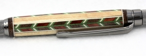

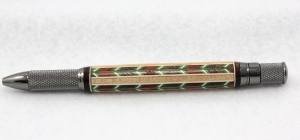

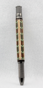

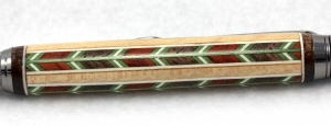

Ya know when you shouldn't have tried that last cut with a skew, or sanded just a little bit more, or whatever ruined a project?
I guess I should have waited until the morning than glued up some inlays late at night.
I almost didn't turn the blank, but I still was pleased with the alignment.
Gotta look carefully, two have walnut/walnut matches; two have walnut/padauk matches (which was my intent).

So these pictures are all of the same pen, right ?
Frankly, I don't see any problem.
Looks great to me !!

I wish mistakes turned out that way for me, Mark! What a beauty. This is one of those "don't point it out and no one will notice" issues!
This mistake is very subtle - until you see it, then it's an elephant. Albet, a nice elephant.
Yup, same pen. Two inlays are matching the Padauk/Walnut, two inlays have alternating walnut/padauk. Just an error when I glued up the inlays. A noobie segmenter mistake. :frown:
