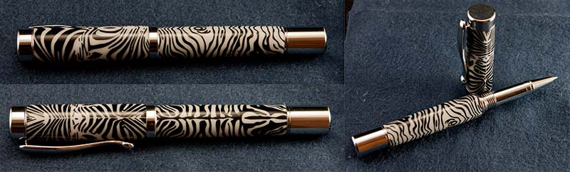

Pouring alternate colors won't give you a very interesting / realistic zebra pattern. If you have a rotary carving tool (dremel / flexshaft / cnc router or mill with rotary capability) you can make a pretty decent zebra blank in a few (not so easy maybe) steps.
1) cast a white blank and turn it to finished size and shape.
2) Using your rotary tool, carve grooves for the black stripes They don't have to be deep or even since they will be filled in with black opaque resin. I carve about 0.01" deep.
3) cast the carved blank in black resin.
4) turn the blank to final shape and size being careful not to turn away your design. When the design becomes visible, stop turning.
Here's a picture of something I did a couple years ago:
attachment.php
You are limited only by your patience.
Ed
