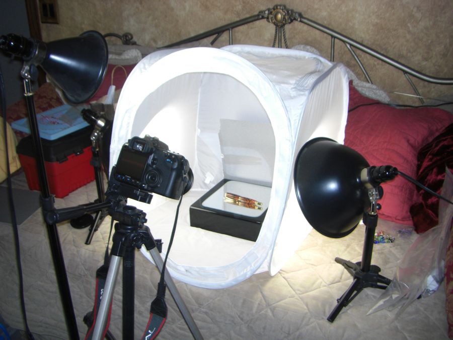

Just set up my camera again today. Here is mine:
Primary lights left and right, reflection light above/behind camera. Which side and exactly where depends on how the pen is laid out.

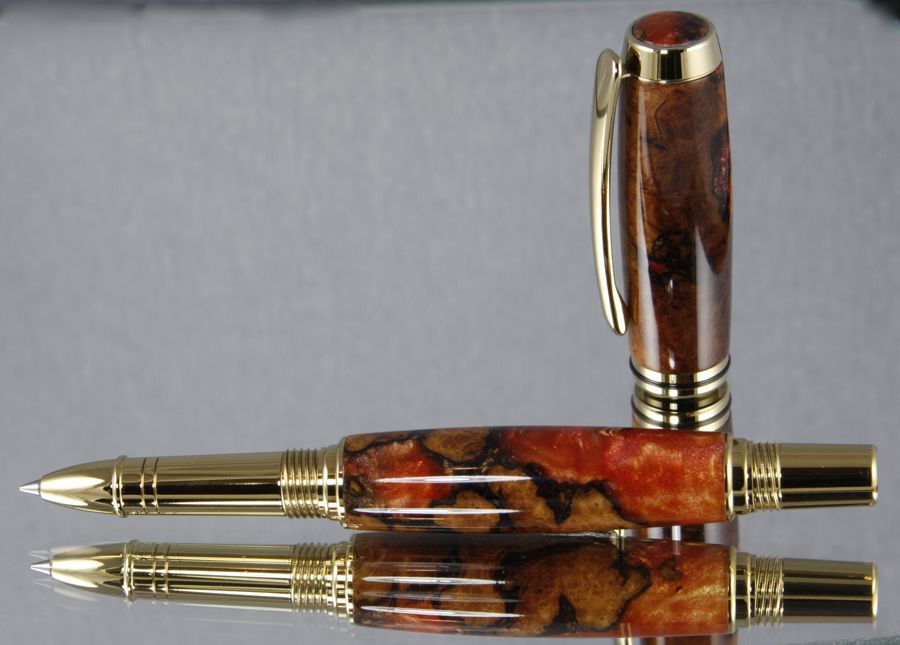

Here is the picture taken today with the setup you see:
I used a Kodak grey card to do manual color balance and to set the aperture, etc and the only editing was cropping and trying to fill in the top where my background wasn't quite tall enough.

Greg, nice setup, nice pen, and a nice photo!
As a suggestion, you might want to put some sort of round diffuser in front of your direct light, as you can see the actual light bulb and surround in the highlight on your pen. A diffuser would mask that effect.
Paul B.
Paul, I'm torn. Sometimes I think a diffuser would be good. Other times I think that showing that you could almost read the brand of bulb in the reflection really shows off the quality of the finish.
In the past I put the pen at a sharper angle to the camera so the reflection is stretched out more. But this was the first try with a mirror. I like it but it doesn't really go to using a sharp angle as much.
I'll keep playing. Thanks for the comments and suggestions!!
