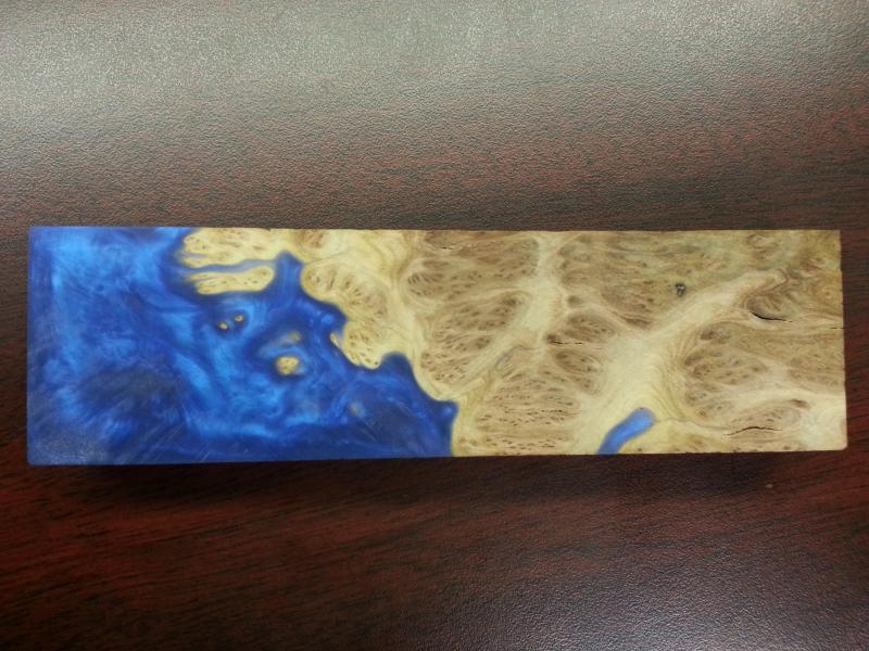

Hey guys and gals. I've been honing my skills casting for awhile and finally decided to share what I've been working on lately. I've got about 20 lbs of burl cutoffs consisting of Red Mallee, York Gum, Corrugata, and a couple of others. This particular piece is 3/4 x 1 1/2 x 5 1/2 York Gum Burl with some alumilite clear and blue pearl-ex. As always, comments good or bad are always welcome.
Dave

That looks really nice, I'd like to see it made into a pen.
Good job on learning to do that. How long did it take you to figure it out?
Tom
Tom,
With all the resources here at the IAP, it didn't take very long to learn at all. Researching really does pay off. It did however, take awhile to get them exactly the way I wanted. There is no replacement for experience and I'm sure I have a lot yet to learn, but I'm pretty happy with my results as of late. Hope this helps.

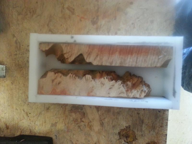

Here's a pic to help explain what I sent you in the PM. Hope this helps.
Dave

Thanks for the pic - that really helps!
What are the dimension of that mold? Looks like you get two blanks out of the mold?
Mordi
Molds
I have several sizes actually. Most of which are 5 1/2 long and 1 1/8 deep (I usually only pour to 7/8" - 1"). For the width, I usually size them to how many blanks that I need plus the kerf of my tablesaw blade. So in essence, I have two, three, and four blank molds. I also have a half blank size for single barrel pens. It just makes more sense to me that way. Hope this helps.
