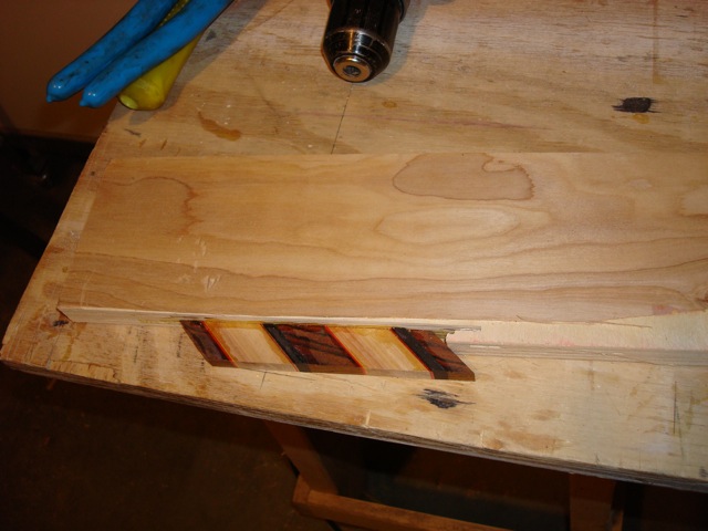

I use a miter saw and table saw for my segmenting. To do it safely you need to think about how to cut the small pieces off the edge large ones. When I cut my own blanks I leave them as long as I can to keep my fingers away from the blade. You also need to buy a good blade. some tooth patterns will try pull the wood towards the blade so being able to get a good grip on the blank or use a stop or a clamp. You can never own too many clamps. Jig 2 is the set up I have on my chop saw. It is a Makita 10" sliding compound miter saw. I set the slide so it doesn't cut all the way through the 1X2 that I use for a fence. The bottom is a piece of 1/4" plywood. The jig is nice because you can draw on it and it keeps 90% of the small pieces from launching into orbit. I also take my finger off the trigger just before I cut all the way through the piece. Also leave the blade down until it stops spinning. The best part is if it gets to badly cut up you just toss it and start over with a new one.

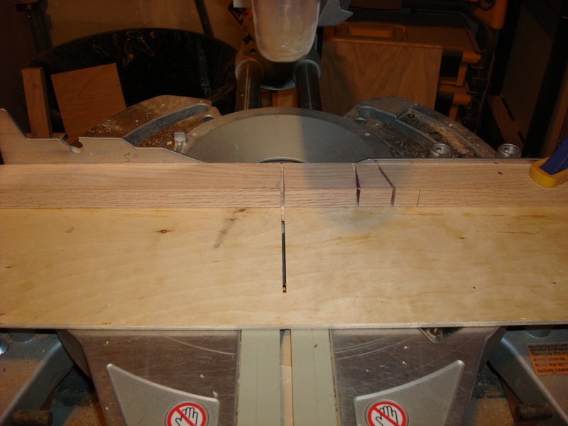

I made a jig for my miter saw. It has toggle clamps to hold each piece. The trick to keeping the cut-off from flying is to keep blade down until you shut off saw and IT STOPS SPINNING. Then raise the blade.
The body of jig is plywood that is wider than the blade cut. There is a backstop built into jig.

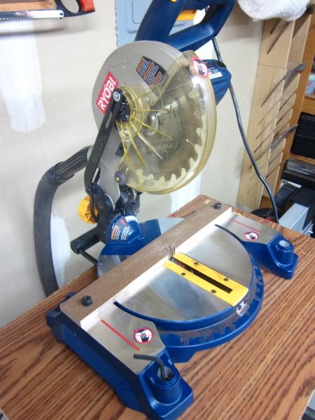

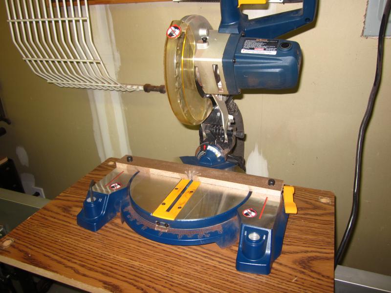

I have a 7 1/4" Ryobi ($89) that works very well. I removed the standard fence and replaced it with a low fence made of Trex.
Also, if you don't have a disk sander, you should. Works the best for scallops and truing up cuts from the miter saw.
Can we see a picture?

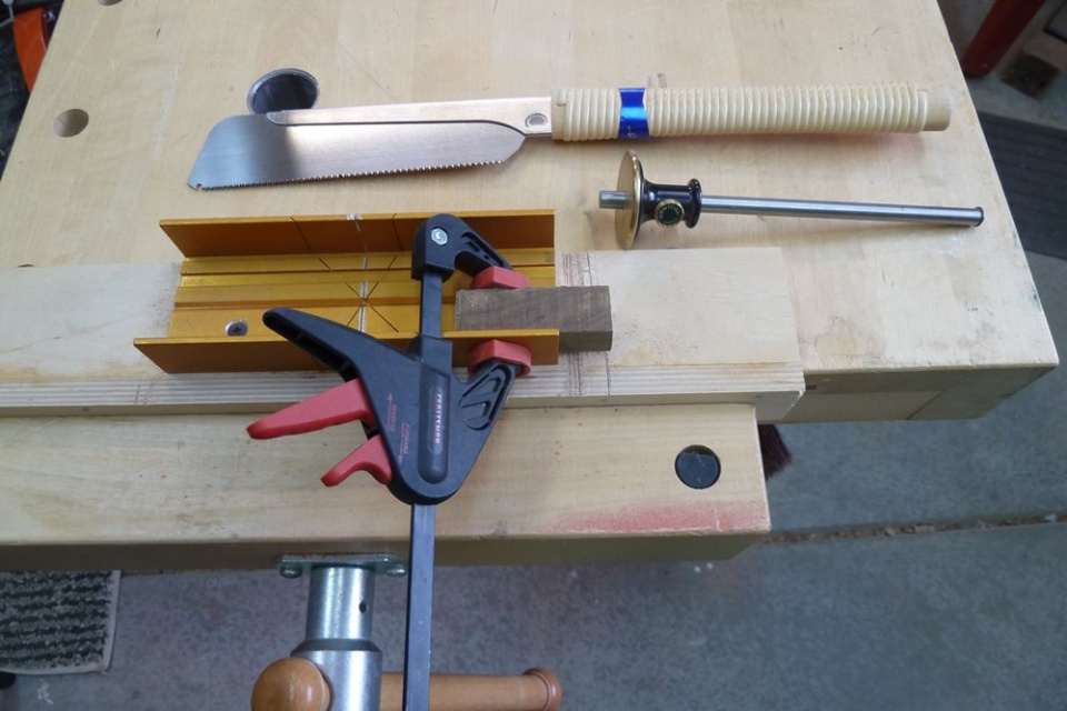

Here's what I use. I got the aluminium box from Lee Valley Hardware. I attached it to some scrap plywood so I could secure it with a vise. The Japanese dozuki hand saw I've had for years. Clamping the blank to the vice makes sawing and control a lot easier. It's pretty fast and safe, too. I square up the ends with a hf disk sander.

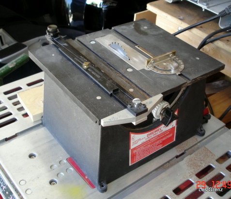

I dug out my little Dremel table saw. It has been packed away for quite a few years since my model railroading and model making days are over. I dusted it off and cut a few blanks. It cuts accurately and if not trying to rush a blank through it has enough power. It does not quite cut through the 3/4" blank. Due to the size of the blade it is about 1/16" shy. I just flip the blank over and make another pass. The original blade was slightly larger but I used a carbide blade from something else thus the short fall.
