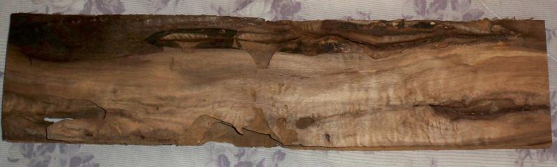

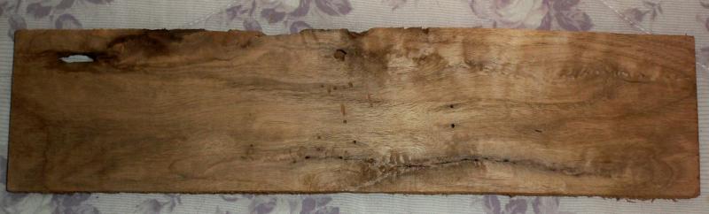

Here are a couple pictures of the board. It is actually just shy of 16 x 4".
sounds like I'd have to invest in things I would use a lot. Is anyone interested in this piece of wood, in exchange for a blank or two?

With a piece like that, I would cut out the pieces that would make good WW and put exactly what you want into the mold instead of ripping it like I previously said... PM me if you come across any more questions or need more clarification!
