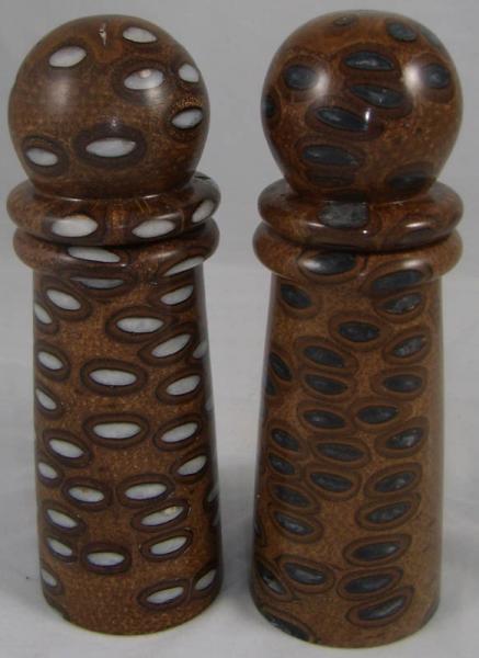

I have done large banksia cast with resin, not exactly WW, but same principle. I cast them in dia 3" PVC tubes.
