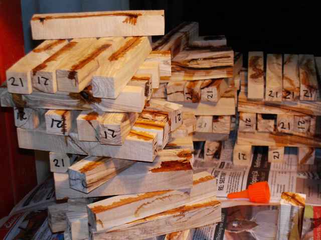

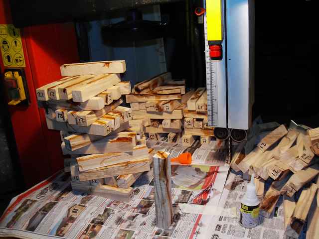

I didnt see it mentioned but make sure your wood is dry. Heat it up in the oven before casting. I also had a problem with pr sticking to osage. Im guessing dense woods are the problem child.
Hi had a few initial problems with the Majestic Olive wood, mainly if with dense heartwood or not as dry as it could be. I could see some "separation", particularly in blanks with only 50 or 60% wood on them, the outer skin where the PR (only thing available to me...!) was to stick to. This as to do with the natural oils of the olive, the more heartwood or flaws the more the oil is found in high concentrations, is this same oil that forms the colours and protects (self repair) the fractures or found within the wood, very much like the antibodies we create around a cut or bruise, trying to heal.
I quickly fix the problem by using thin CA to coat all the surfaces where the PR needed to stick properly. I should mention that I also use a wire brush to clean and rough up the sticking surfaces, followed by a good blow with the air gun.
So far, I haven't found any more separations on those olive wood casted blanks nor on any of the other woods that I used so far for casting. I have 30+ other woods to use for casting so, I will not be surprised if I get another one that requires the same treatment will see...!
Good luck with yours...!
Cheers
George
