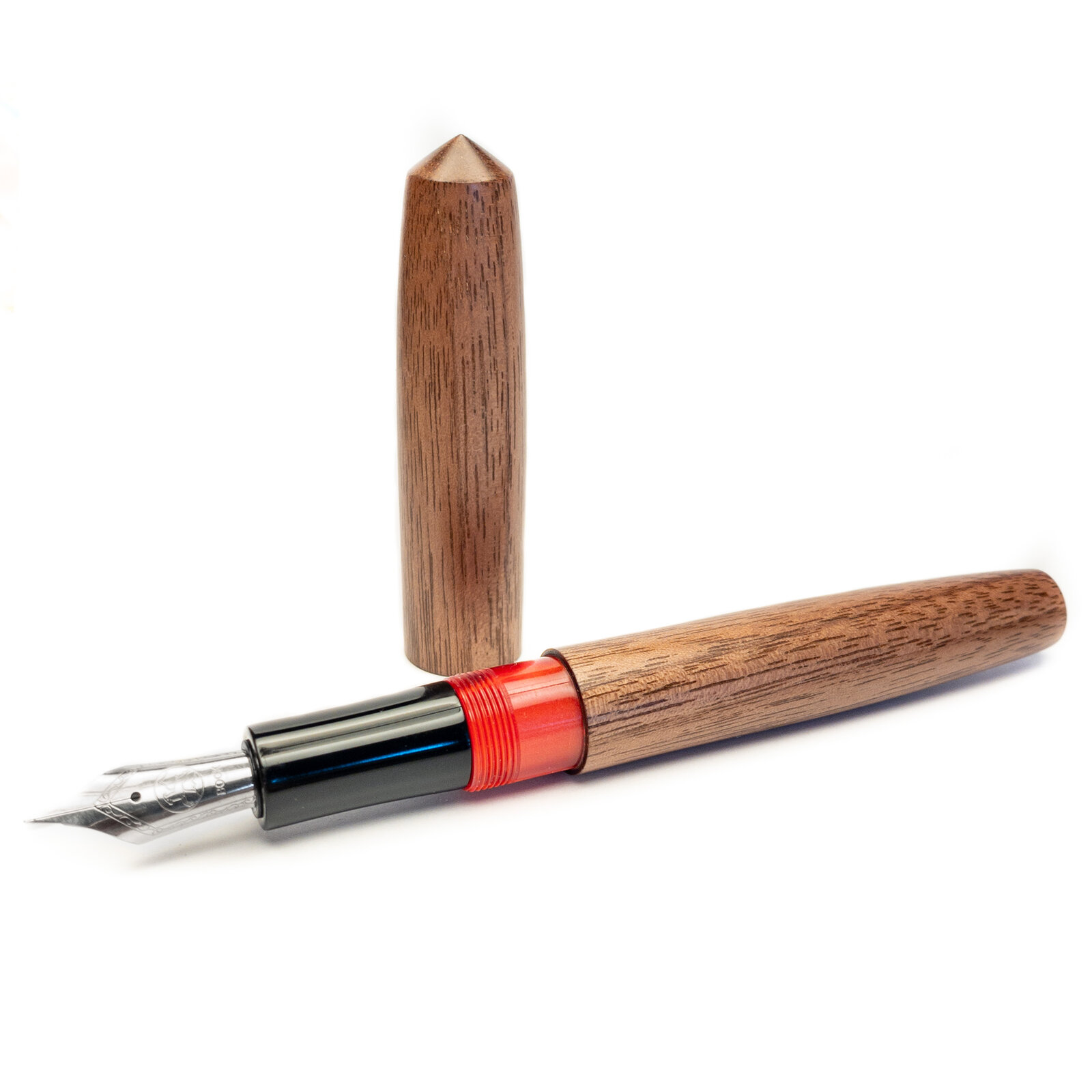

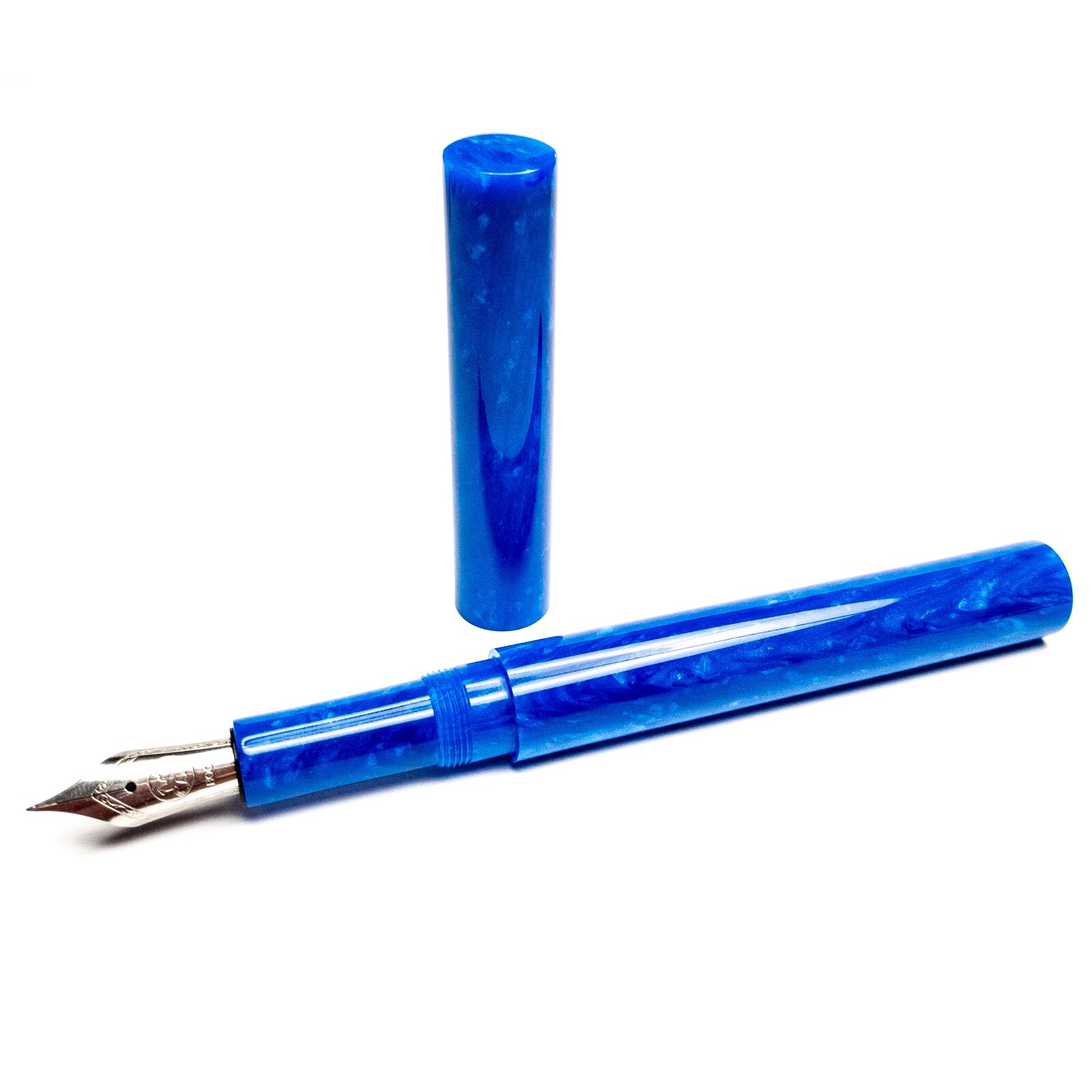

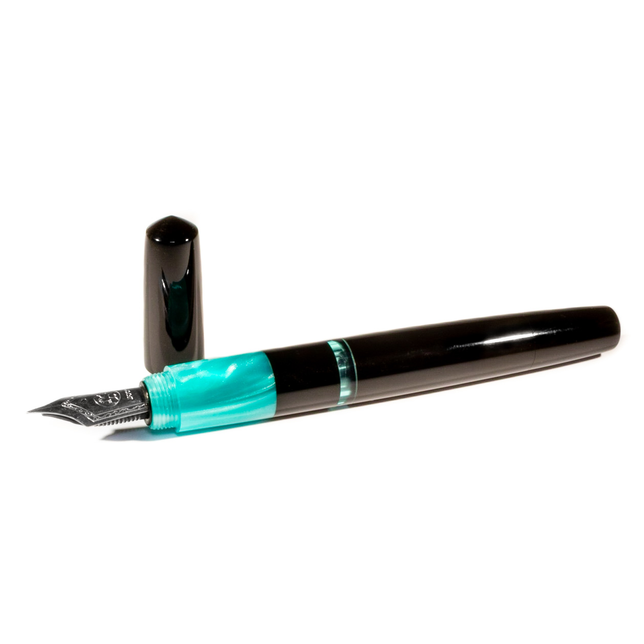

A metal lathe supposedly does make some things easier but if all you have is the jet 1221 then you can also make all your bespoke pens on that. The only thing you will be limited in is is making your own metal scent rings and bands. 99 percent of all my pens are kitless and all I have is the jet 1221 for everything I do To make these. Here are a few of my pens. I would say start with what you have and go from their. once you have exhausted what you can do on your wood lathe for kitless pens then add the metal lathe.
View attachment 242011View attachment 242012View attachment 242013
Awesome pens Jon! Very, very nice. đź‘Ť đź‘Ť. The term Bespoke Pens has been around for several years now, and really does not reflect much on the lathe used but the marketing terminology - this is not new. However, I love your Bespoke Pens!
