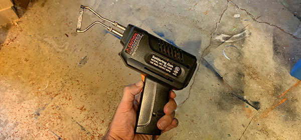

My line cutters is basically a soldering iron with a straight blade used to cut and fuse nylon cords.
I wondered if it could add interesting design elements to wood center bands.​

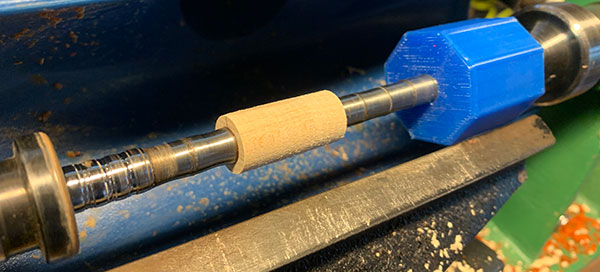

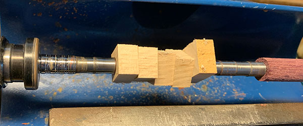

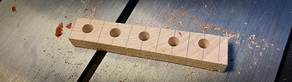

I cut a thick (0.45") piece of hard maple and drilled 0.25" holes before separating into squares.

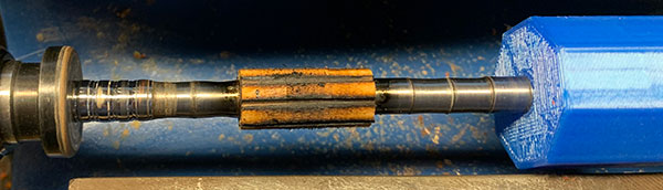

Mounted and turned.
To space the lines evenly(ish) I installed my octagonal guide on the lathe and lined up the corners with the rest to mark off 45 degrees.

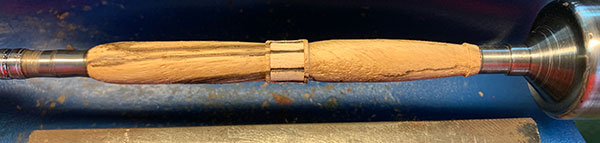

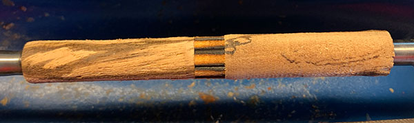

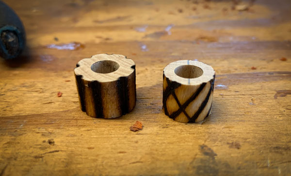

Burned lines

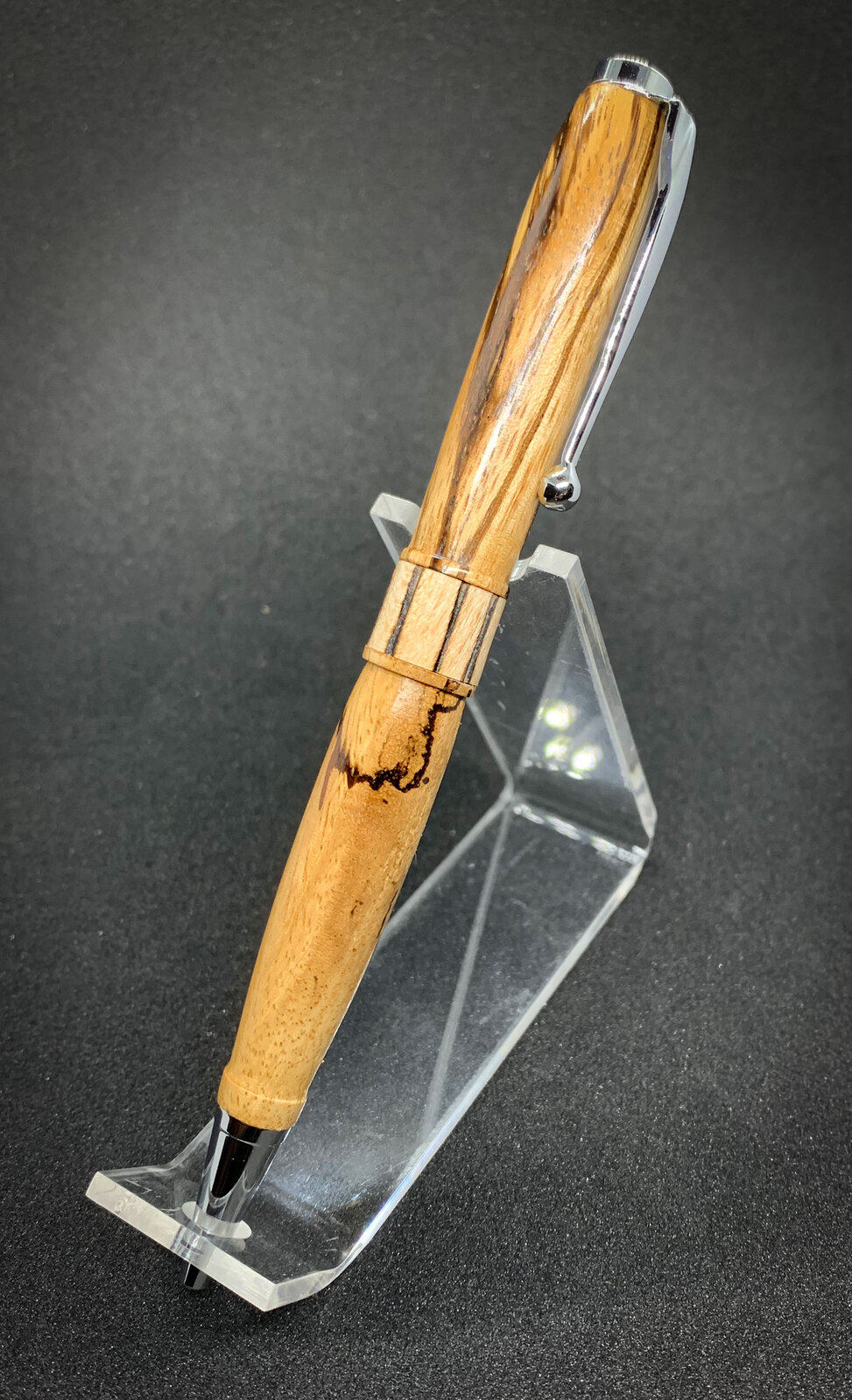

I was curious how the "straight" burned lines would look between zebra wood.
