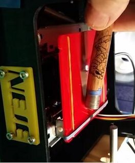

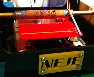

I'm making a jig for use with my laser engraver. The jig calls for a 7mm mandrel rod. Rather than drive 25 miles to Woodcraft to spend $5 for a replacement mandrel rod I'd rather just drive 1 mile to Lowes and get a 1/4" rod. The mandrels are .247 dia. vs .250 for a 1/4" rod. Will that fit into a 7mm tube? They are called "7mm mandrels" but they are called that because they fit a 7mm tube but actually measure .247". I'm not at home so I can't check to see if a 1/4" drill bit will fit through a bushing. Does anybody know or can check for me? Thanks in advance.
