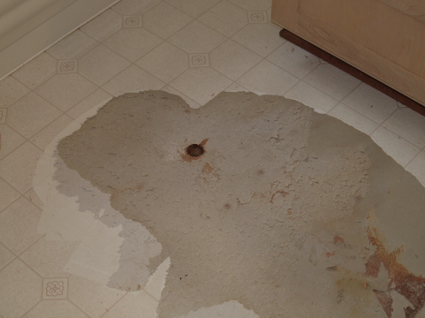

I know we've all been in this "boat". When you own a house, all is fine and then one day something happens and who knows what or why right? 5 days ago my daughter says her closet is leaking water. I went and checked it out. The ceiling is finished, so it's tough to see what's up, I popped off a ceiling vent and stuck my head up inside with a flashlight. I see a big round metal pipe, air duct with water on it. Seems logical to me that the pipe must be sweating, especially since the basement is extra damp with all the rain we've had. Of course the darn pipe should have been insulated before the ceiling was installed, but that's just one of those things about having a house too I guess. I put some containers up in the ceiling to catch the water off the big pipe..that's all I can do until she moves out, because I'll have to cut the whole ceiling section out to insulate that pipe. A couple days later she comes complaining it's still leaking. I'm frustrated, I go check it out again. I see a nail sticking through the floor up above just happens to have a ball of water hanging off the end of it. Very strange, there's two bathrooms up there close to that spot but not over top of it and no pipes very close by. I inspected everything and there is no wet trail anywhere I can find, inspected all the sinks and plumbing and toilets, spent 3 days of frustration trying to find the poltergeist! I decided to have the septic pumped. Makes no sense, but last time I had a mystery leak it was the septic. He looked at it too and it makes no sense to him either, but he did say "it's too bad it so confined up there, because if it wasn't I'd reach up there with a saw and cut into the floor to see what is leaking". I thought about that a few hours. Finally I gave in..I got my drill out and a 1.5 spade bit and drilled a hole right beside that nail. Now I go upstairs to see if it's possible to find the hole...darn hole is right in the center of the bathroom floor! :eek: Hmmm..the wood is a bit damp, so I grab a chunk of lenolium and pull on it. I guess I already destroyed the bathroom anyhow, so lets see if the floor under the lenolium is wet and takes me to the source. Well it was and did. The leak was under the bathroom sink, a 2 second repair. Somehow the P trap got knocked down loose so when you ran the water it just leaked all into the cabinet, but reaching down in after the fact and touching the pipe gave no hint and there's so much stuff in the cabinet that you couldn't see it. The water was all in the bottom and flowed under the flooring to a nail that led the way down. Problem solved! Honey finally gets that new bathrooom floor she wanted. :biggrin:

Had to do something very similar last year. Our en suite is directly above my little workshop. I saw wet marks on my ceiling and eventually had to rip out the entire bathroom to replace the chipboard floor. The leak was a stupid loose connection on the shower u-trap.

Last night it rained like a monsoon. My kid comes upstairs and says hey, the basement is leaking. What????:eek: My basement never leaked before, my house is on the side of a hill with a walkout basement. The leaking was in the furnace room. There is a window and the window is maybe 12x24 and mostly below ground with a well around it. Well the well was completely full of water and that water decided to come through the window. I ran outside and baled out the window. So I guess that window caulking is wearing out. I put a huge sheet of plywood on an angle over the window so if it rains again, the water will run far away. Well it did rain again about 30 minutes later and man did it ever rain! The window well filled back full of water. The gutters couldn't even keep up with that much water, which just poured right down the walls behind my wood deflector and I was out there in a monsoon bailing water out of the window but it was filling faster than I could bail it out. I'm going to call someone and have that window turned into cement wall.

I dug out my window after work yesterday. I cleaned it up as best I could and caulked it big time. I installed a new plastic well and cover. I was rather peeved at the big box store because they sell the window wells 37" and the large see through covers are all 40", so none of them fit the wells! They had a flat cover that did fit, so I just bought that. I installed the well and cover but it wasn't big enough to cover the full height of the window. I dug a trench and ran a 1.5" pipe from inside the bottom of the well around the side of the house and exiting on the big hill to the backyard. The rain came about midnight last night. We got 2" of rain in one hour, then it was all over. There is a huge flood out there, but not in my house! I got out of bed and went downstairs for a bit during the deluge of rain. The window well took on a lot of water still, even with the cover and the ground tapering work I did out there, but the pipe did a great job of keeping the water level in check. There was just one small spot on the wall where the window was still leaking. The leak spot was however so minute that it only made it 12" down the wall, never even reaching the floor. Now I am going to clean and caulk the inside of the window and now I can clean up all the water in the furnace room. I didn't want to waste my time cleaning up the mini flood until the window was fixed. I know that if I did not hurry home from work and spend a few hours working on that, then my entire basement would probably be covered in an inch or more of water. As it is, I only have a 1/4" of water along one cement wall in the furnace room to clean up from the last little bit of flood we had yesterday. Whew!
