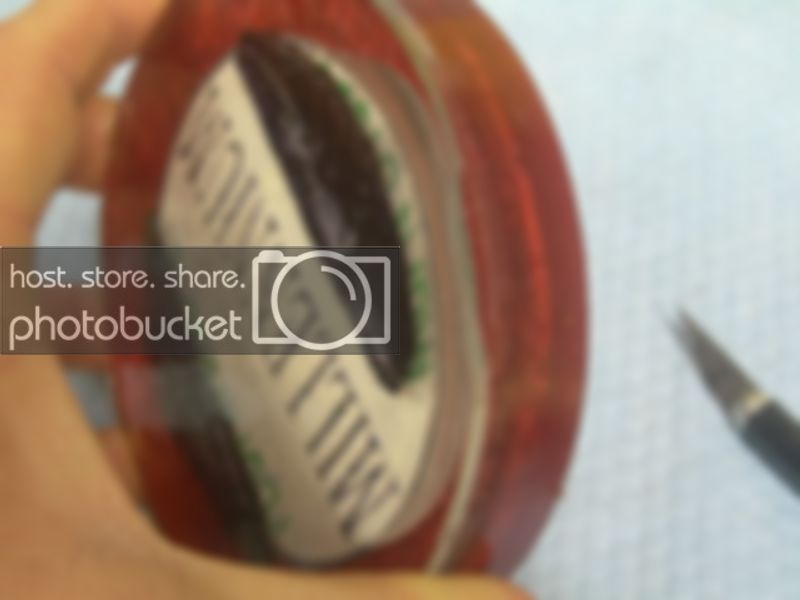

I did a casting for small project that wasn't a pen and ran into an issue. As you can see in the picture I poured the bottom red layer then waited until it became tacky and gelled then placed the picture on top of it.
The picture I printed onto photo paper on an inkjet printer then put a layer of modge podge on the front and back of the picture.

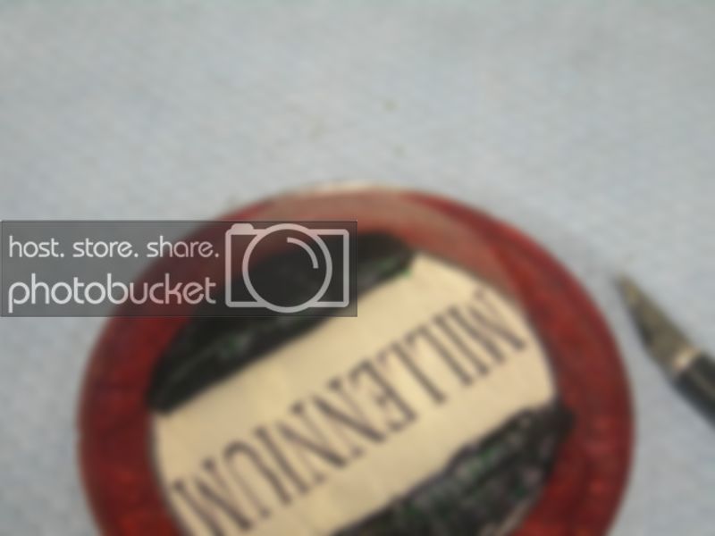

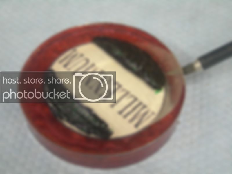

I then poured the clear resin on top while the bottom layer was still tacky to make sure the 2 layers would adhere. Everything was fine until resin was at the peak of curing(a few minutes after I poured it) it created an air bubble as you can see in the pictures. I don't know why this happened and wanted to see what I should do to not allow it to happen.
Also, the clear resin I had sitting in a cup of warm water to thin the resin a bit to eliminate air bubbles. Could it be that I used too much catalyst making it get to hot?

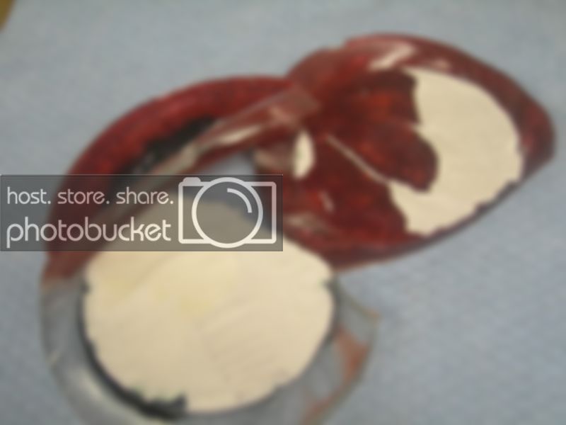

I put a small screw driver into the pocket and twisted a little and this is what happened.

I would say that you are trapping air when you place the picture on the red layer. Next time, take your stir stick or something and spread some clear resin on the back of the picture. Then put it in place and pour the rest of the resin over it...

I think part of the answer is here in this statement. When placing the paper on top of the red resin there may have been air buubbles underneath and it escaped when adding the weight of the next layer. Whenever you pour try to deflect the pour so that you are not creating air bubbles. Whenever you heat your resin 2 things happen. One is it thins the resin out which is great for less bubbles but 2 the resin sets up very quickly and the more catalyst used the faster it goes. I am talking minutes to get to gel form so if there is air trapped it does not have time to get to the surface. before it is skimmed over. That is my 2¢

I have stopped using Modge Podge for several reasons. Ca is a better choice but sealing the ink is not necessary. I do not seal the ink when I make blanks with computer labels. I suspect air was trapped under the label and escaped when the curing started. But that is just an educated guess since I have not done any casting similar to what you attempted.
