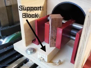

Add to the Heat section; When drilling multi-part blanks, the blank must be supported from the end of the blank. No matter how you drill blanks, having the blank only clamped form the sides will break the glue joint.
I'm not sure if I understand what you mean by supporting the end of the blank while drilling. Can you elaborate?
Wayne; I use a Support Block under the blank for the drill bit to press against. If you drill on the lathe, you can insert a block between the jaws. A picture is worth a thousand words.
Perfect, thank you. I do it on the drill press but hadn't thought of doing it on the lathe.
I am not sure how I would accomplish this on a lathe either. I suppose you could glue one on then part it off afterward? Makes great sense on the drill press.
