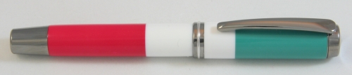

I did the same with this, but forgot to write down the recipe....:curse: . Took about 5 attempts for both colors (white was first try!).
Tom
Tom
