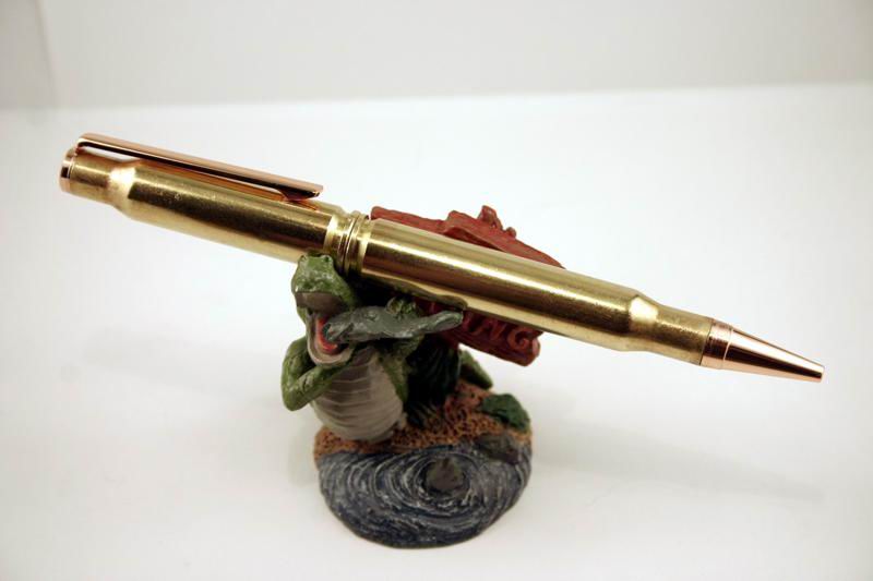

Finally got all the part together (except the bullets). The 30.06 on the bottom and the .308 on top worked great.
Once I get the bullets for the nib and find a better solution for a clip, the only (stock) piece will be the transmission. I know I can get them in bulk from several different vendors here on the IAP. Thanks for all your help so far...

Nice job (except for the nib, hope you replace it with a real bullet when you get them). I find the cartridge pens a lot of fun to play around with and a nice diversion from making the regular pens. There are a great many variations to work with. I'd like to get a powder-coater one of these day and play with coating them.
If I am going traditional then I prefer the 30-06 because it is a bit longer and to me the extra length makes the lower part of the pen more comfortable.
As you can see by the casing contest...anything is possible using any type of ammo and with all different experience levels. This year proves that more than last year, being that the rules are a bit different this time. I think these guys could make pens from the gravel in my driveway!:eek:
