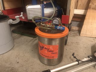

Low end for stabilizing is about $75 plus the cost of resin/dyes (pickle jar vacuum chamber, cheap rotary vane pump, hoses/fittings). On the high end you could probably spend a billion dollars.

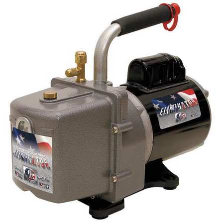

With the vacuum pump, can it be the same kind that you would pull a vacuum on an AC system?

Yes. Yes. Depends. I've heard that some people use a paint pot as a vacuum chamber, but I wouldn't recommend it. It is best to be able to see what is happening while pulling vacuum during stabilizing, so a paint pot is not ideal. There are many different styles of stabilizing chambers, but I think the pickle jar style is the cheapest because it is basically free if you like pickles. Some of the other styles are easier to use for larger blanks and such, but they are substantially more expensive.

Vacpump made in USA: JB Eliminator® Refrig Evacuation Pump, 4.0 cfm, 6 ft. $296

There are a number of videos on YouTube on how to convert a junk refrigerator compressor into a vacuum pump. It looks very easy and is dirt cheap. But I already had a vacuum pump for doing a/c work. It has been working great. You can get a similar vacuum pump from Amazon for around $200, maybe less.

For stabiliizing I got a cheap HF vacuum pump and stole a pot from the kitchen. I used a piece of 3/4 inch clear acrylic as the top and drilled it for the vac tube and a pressure gauge. Used some RTV red gasket stuff to seal it. Works great. Probably around $130
