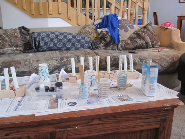

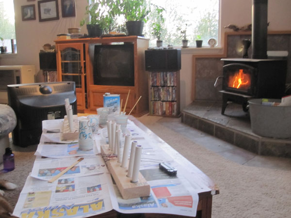

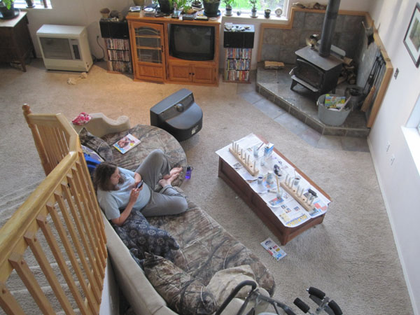

The living room? Ya the wife is hooked too!

You and the wife are going to be high as a kite if you stay in the house!! I personally wouldn't cast indoors, I don't think it's safe...
OUtside temps never got above 58........we had the window cracked and it smells a hell of a lot better than musk ox horn!
Open fire log burner and toxic fumes? Hmmmm
Do all mine in the garden! Last time I did any fiberglassing (same smell) I couldn't get the smell out the house for 5 days!! Haha
I agree with the others. It is potent and will be detrimental to your health! Don't Do It!
those fumes do damage to your central nervous system, lungs and possibly increase
the risk of certain types of cancer (if you live in California)
Tell your friends and family not to be surprised when they read your obituary.:eek:
Everyone is a caster, but no one reads.:rolleyes:
People see something and say to themselves........ I can do that. They don't bother to do any research. Why research when all these other people are doing it? It has to be safe.

Now, would you care to know that the flashpoint of the resin is 88 degrees? Why not just place your casts directly on the woodburner or the heater on the side of your room?

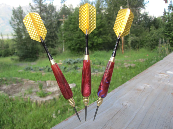

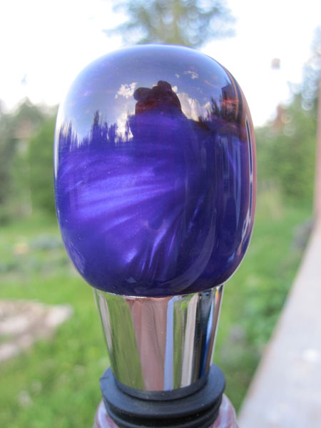

So as it turns out my wife is far better at getting a good looking blank consistently than I am. I am saving most of hers for pens but she made a stopper blank and I used some of my less stunning blanks to turn a set of darts. The fit could be better and the stopper is showing a couple of small bubbles but I am happy for our second try at casting.
