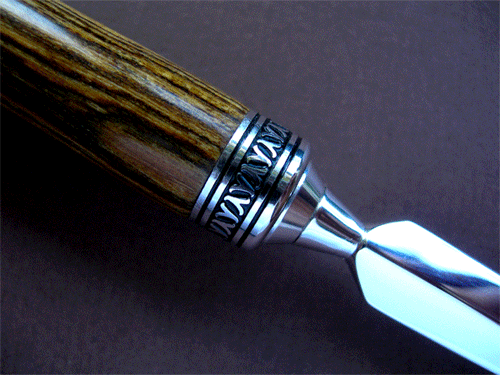

Tough question.
i can talk you through the picture below.
Background: i chose a dark background textured piece of card because i think it shows off the subject better. and, it absorbs light! avoid white to start with it reflects light and can confuse your camera light meter.
composition: taken looking down. important for me because i want the whole subject in focus. (i cant overide my camera setting to be able to control depth of field). subject taken diagonal to fill as much of the frame as possible. keep it simple no props.
camera set to auto and macro.
focused on decorative band, activated focus lock then composed picture.
taken by hand resting elbows on table. much better to have a tripod.
light: natural bright soft daylight, not direct sun light, coming through window from right. on left white card to reflect light into the shadow.
used auto bracketing so i could choose the best picture.
