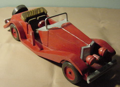

I make my own wood wheel usings a :circle cutter, forstner bits and a router.
Hey Rob,
I have a sears circle cutter that i put in my drill press, just adjust it to whatever size you want. It iwll leave a v shape on the outer edge. If you are using 3/4 inch thich stock, just set your drill press to drill half way through the wood, then turn it over and drill from the other side, this will leave the v ridge in the center of the wheel. It works real good and not that expensive either. They will a long time. If you dont want the ridge just put it them on the lathe and cut it off. Hope this helps.
